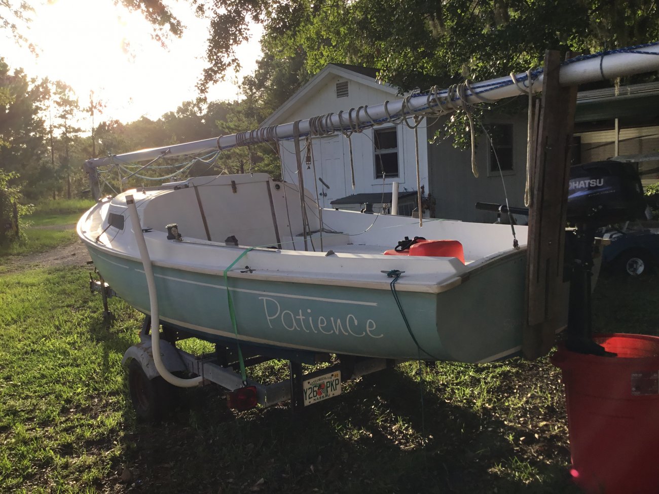

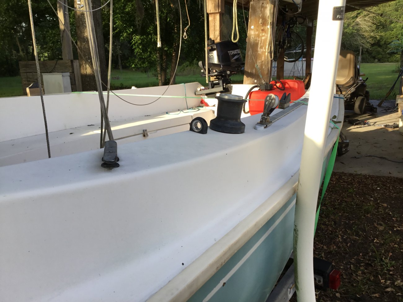

Your original question has become much more interesting since you've posted the photos. None of the hardware on the coaming of your boat is original to the Mariner. However, there are other Mariners that have very similar modifications to those that yours has. Two boats come to my mind: Shoal Mate and Julie B. You can find photos on the Mariner Association site. Ask there. Both owners are active in the association and are glad to help.

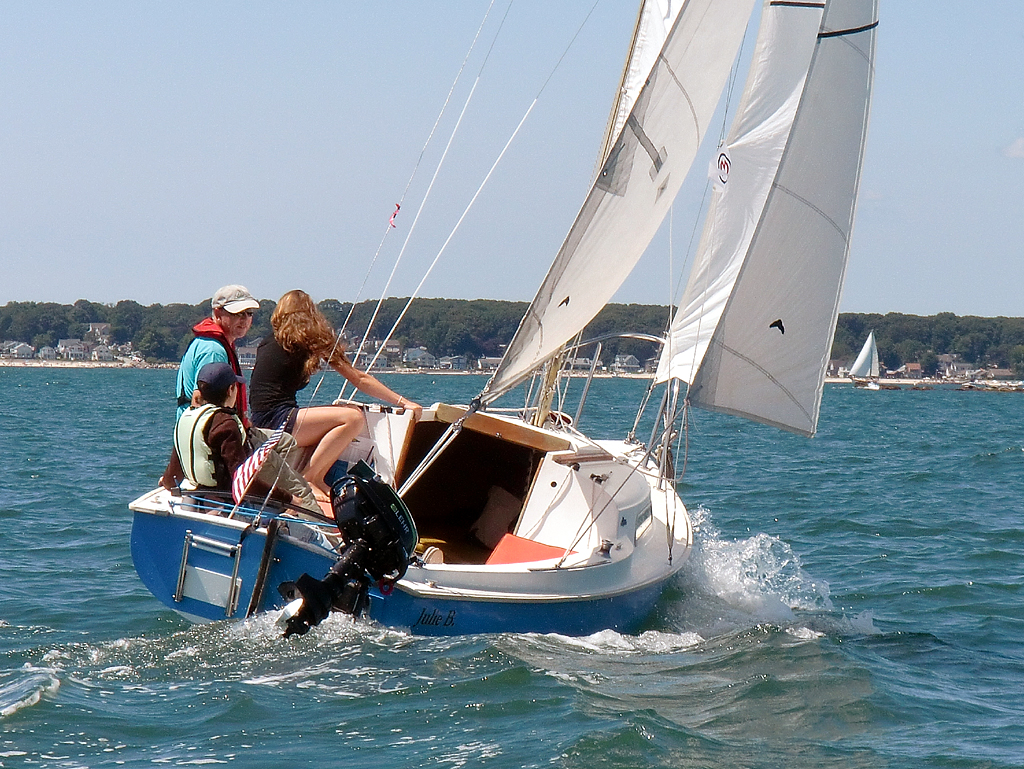

In the meantime, you can ponder my guess: the genoa sheet is passed through the genoa lead block and then turned forward to the winch. Here's a photo of Julie B. in action:
However, instead of going to the winch, the sheet is instead brought up the the cabin top where a block turns it aftward again and through a cam cleat. The winch was not in use at the time of the photo.

In the picture, there appears to be a horn or jam cleat forward of the unused winch. Also, the luff needs adjusting..... otherwise you can easily become overpowered. Looks like fun, doesn't it?

When sitting aft with genoa leads as on your boat, it sounds like a 130 was used with the line going forward to the winch which would create issues first having to go forward to secure leaving the tiller unattended and so on. You could use that sail in light airs but would suggest a smaller jib until you add additional gear aft of the genoa tracks and add a small fuler to the 130.

The Mariner sails better if the skipper and crew are sitting athwart or forward of the mainsheet block, so it does make sense to bring the genoa sheets forward from the lead car rather than aftward. (The mainsheet block is typically a bit forward of the center of the cockpit. This is contrary to Julie B. in the photo I posted. Julie B. has been additionally modified with a transom-mounted traveler, making the controls seemingly far apart, but they are still reachable for a solo sailor on a 19'er.)
