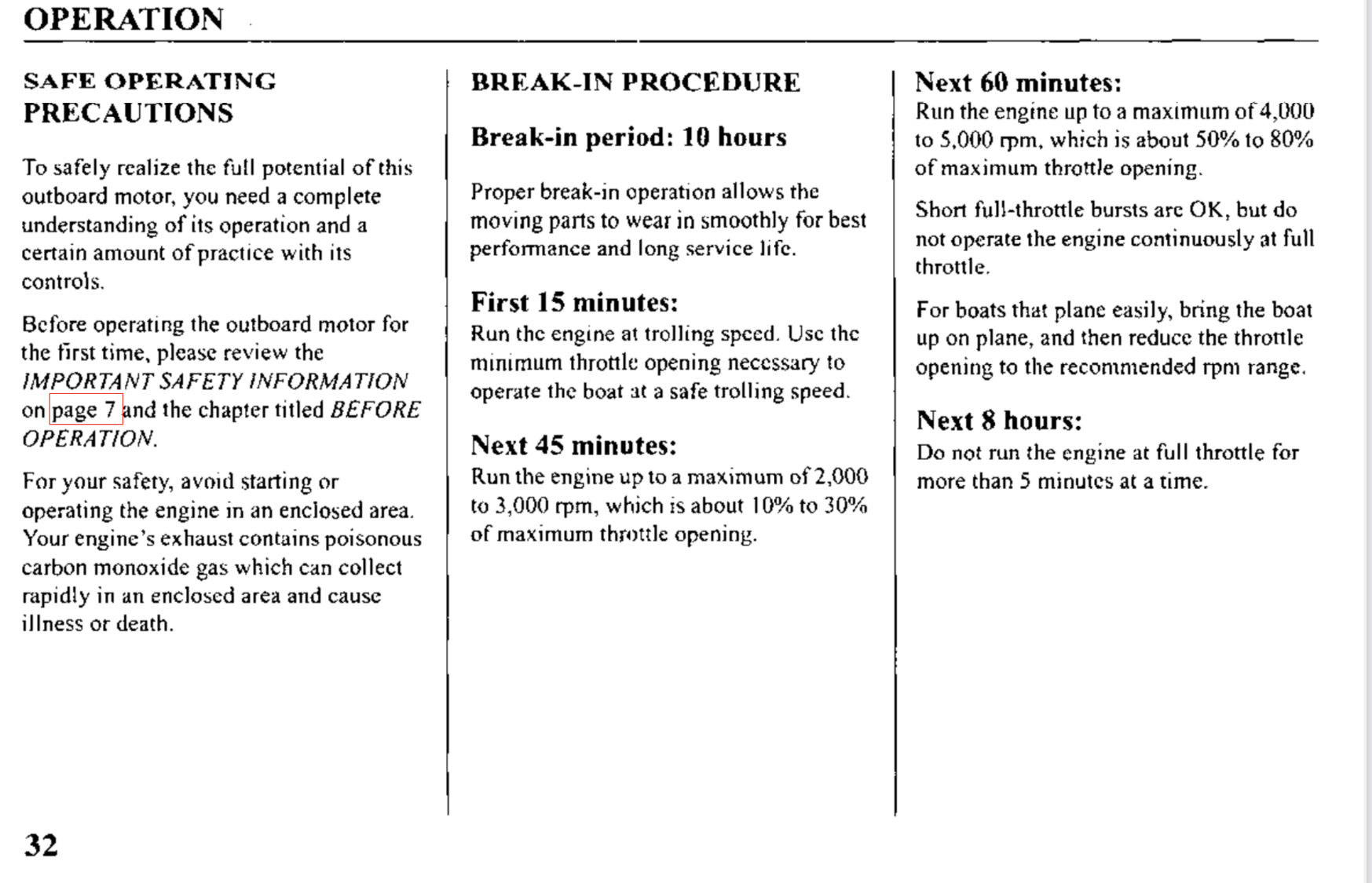

I don’t think Honda or any other manufacturer would suggest you “break in” your new motor by running it WOT for hours and hours. The relevant page of the Honda 9.9 manual below
When it comes to exceeding hull speed I again doubt that the 9.9 motor has the ability to do that.

you have misunderstood the brake-in. re read page 32 of owners manual.
running that engine WOT for hours and hours is NOT what the manual says to do.
page 32, breaking-in is a slow gentle 10 hours.
no tub. no wide open for long periods of time.
