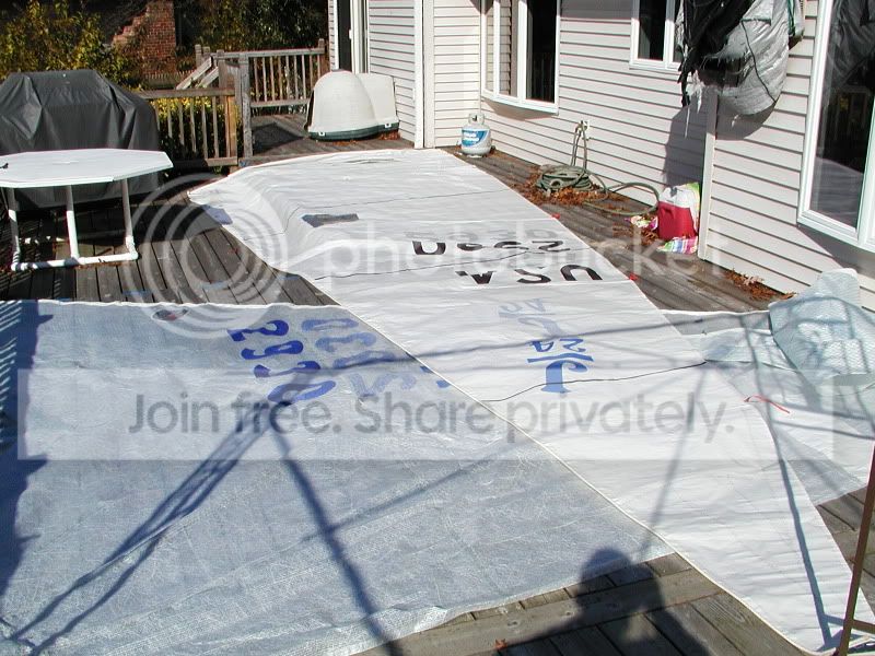

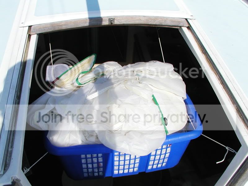

On my J24 i always had two sets of sails ONE for race days that was used about 15 hours a year
And the older everyday beater set that got used 3 times a week and had a patch here and there :)

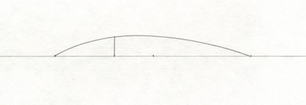

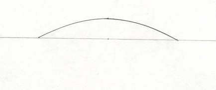

Here are some drawings I made quite some time ago. 10-35 Represents a 10% draft depth and a 35% from the front of the chord. I've drawn that a bit off. The maximum draft is actually a bit more forward. It is a reasonable representation for comparison. 15-50 is not a good shape. That would be a tired sail.
You can stretch a tired sail into a better shape if its dacron.
You also want the leech of the sail to be flat. So when you look at a real sail and not a chord drawing the exit should be flattened to encourage attached flow of air.
It's probably easier to assume that the sails on a used boat aren't very good.
