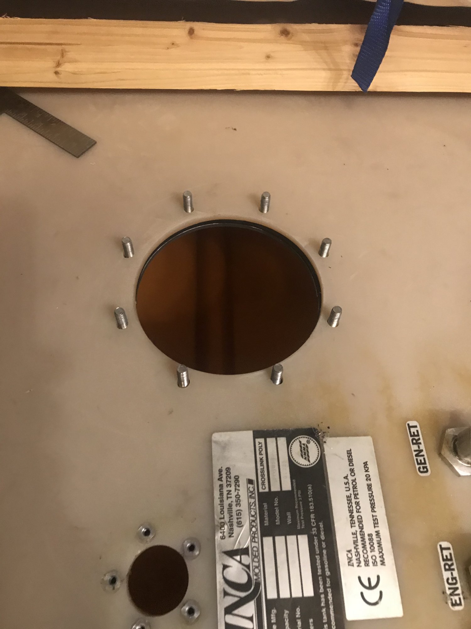

Is it a metal or plastic tank? We cleaned our plastic tank by cutting a hole in it pumping the fuel into 5 gal containers wiping it out then putting a clean out connection on it. Then added a access plate (Seabuilt - Access Plate Systems). Then we replaced the fuel by running it thru a water separating fine screen. It worked great and much cheaper than hiring someone to do it plus we have a means to regularly inspect and clean the tank if necessary.

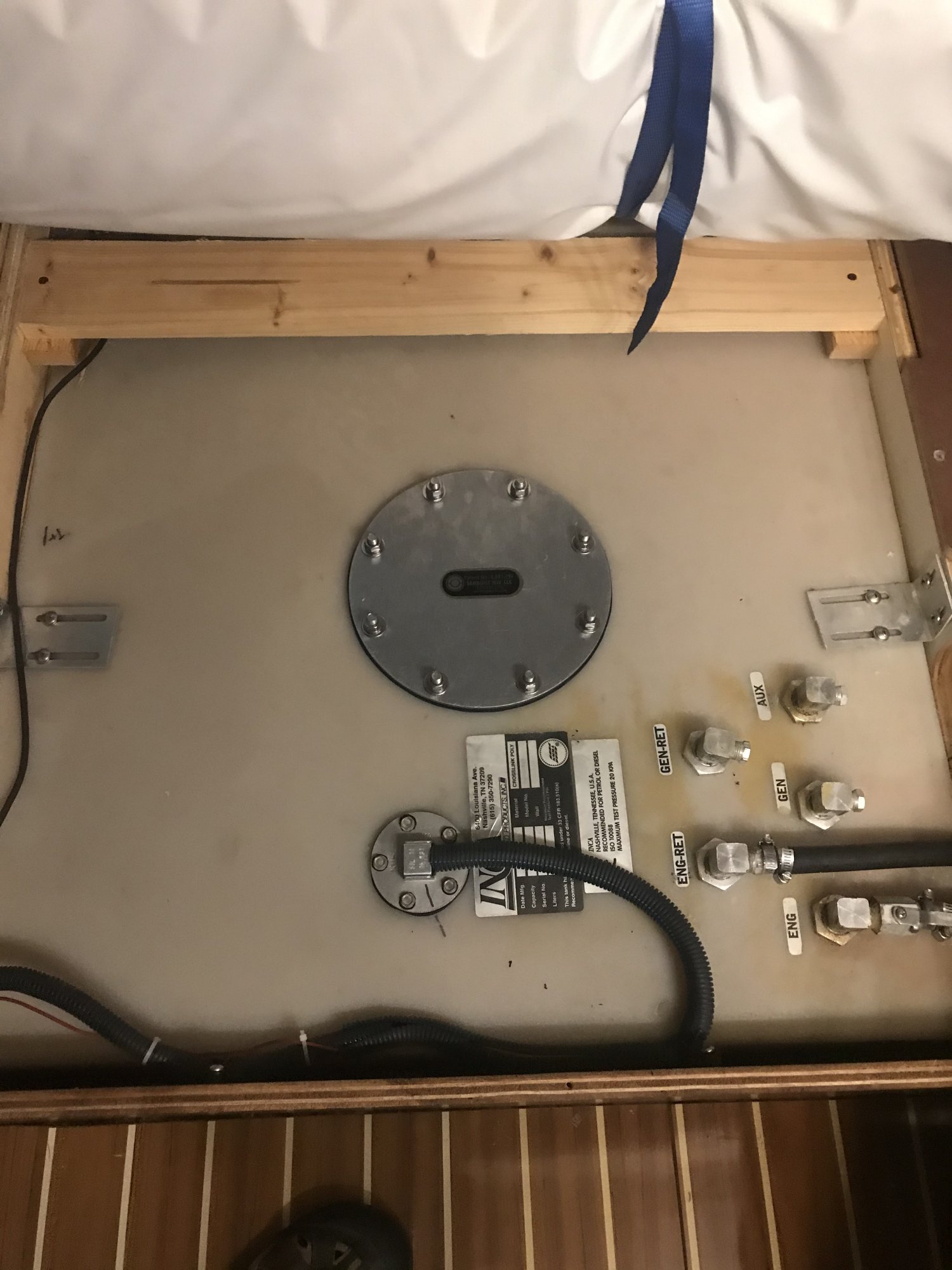

Its Plastic, and in my case I need to get out about 500L, and store it The Access Plate system looks good, but it will be long and hard to do from Indonesia. However maybe I could have a copy of the idea made. I cant actual find an email contact for the tank manufactore, in fact I cant get to there website either it seems broken.

I have been looking for a contact on the fuel tank, to find out if I must cut a whole for the ultimate solution, then where are all the baffles etc, but this website http://www.incaproducts.com says access forbiden and SeaStar Solutions contact page goes something completely irrelevant. So if anyone has any contacts for INCA (picture of tank is above) please let me know.

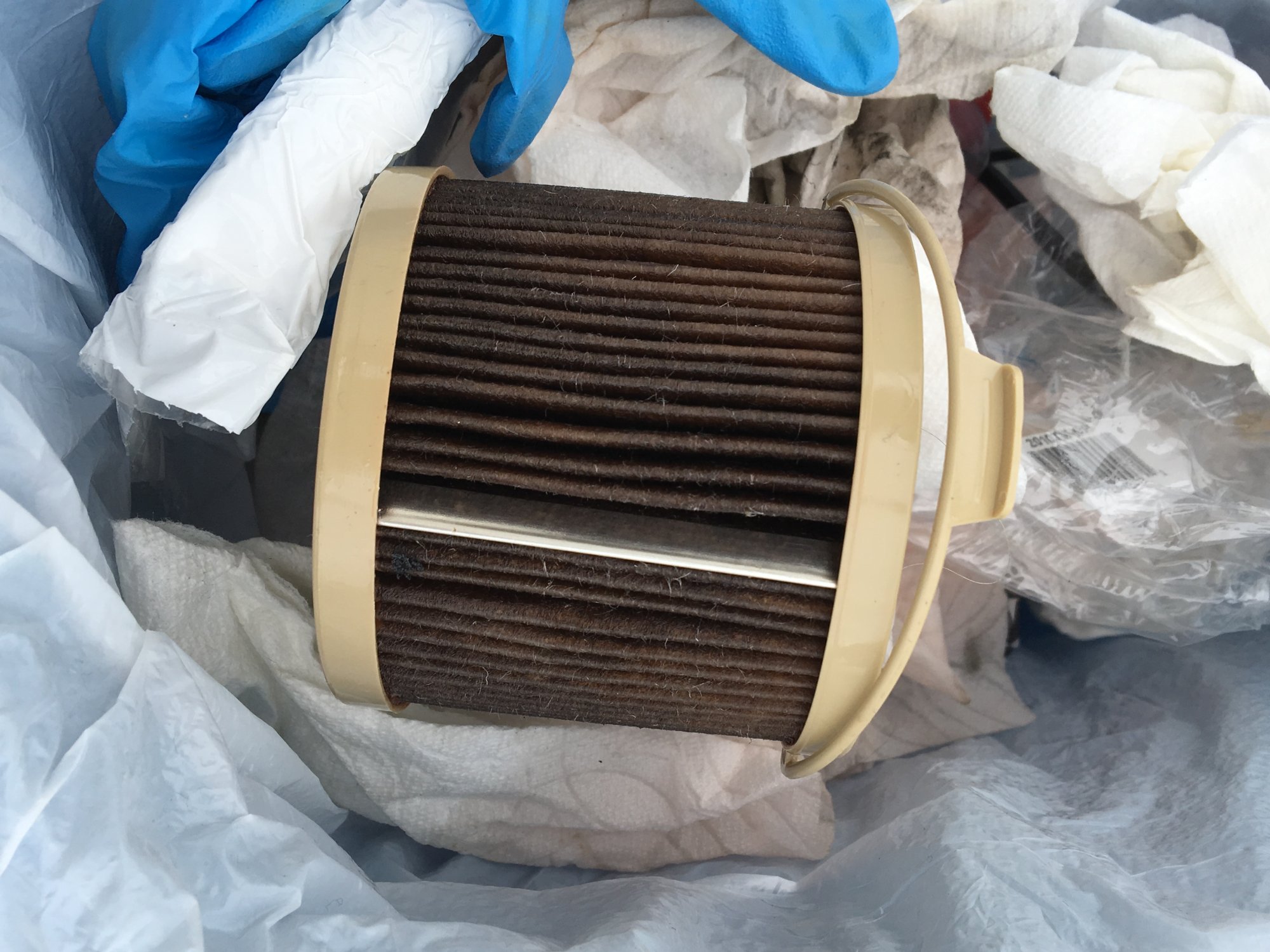

I got filters out that looked full of coffee grounds ( I understand this to be the waste of the diesel bugs).

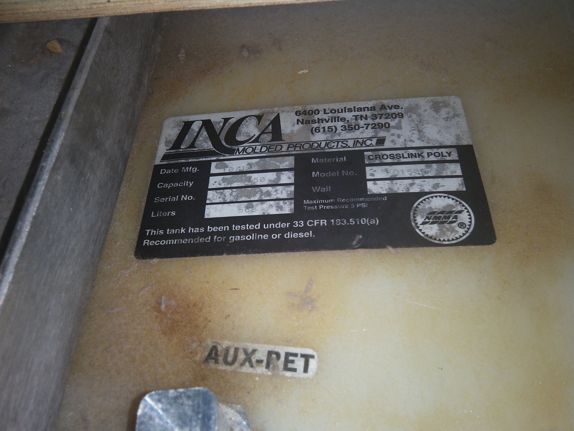

I only have one fuel tank and as mentioned above cutting a whole to clean is a last ditch stand. So I will try pulling all the fuel out when i get to the Marina, and let sit 2 or 3 days and put back the top 90%. I might also try throwing/spraying some kero in the tank, pending how empty I can actually get the tank and I will also ponder your aeration & foaming point. I'm told there are no additives here, and forget about good ones, so I will need to ponder ordering or wait till I get back to Oz. The only other option is perhaps make my interim solution with backup jerry cann more permanent, and then run the 12v genset lift pump from the main tank through the Racor to keep the Jerry Cann topped up. Messy and risk of either under or over filling Jerry Can. I will also check whether the Racor 500 is any better than the 220 series I have at trapping water. Thanks

Screen Saver don’t spend to much effort trying to contact the manufacturer of your poly tank. I also have a rotomoulded tank in our boat and got through to the USA manufacturer concerning creating an access in the tank for cleaning. The answer “Is not possible”. Their answer is in line with the US culture of suing for everything. If they say you can cut a hole and it leaks and the boat catches fire they can be sued I think. They just so NO. Just do what you think is best. Concerning the gasket material for the hatch, just use cork, it will outlast the boat.

Initially I replaced the external Racor filter, which was old, before replacement of this filter and after the fueling the engine would run maybe 10minuts and after the new filter it would last about 3 hours before the symptoms return
Then I replaced the Yanmar filter on the Engine, this made no difference
