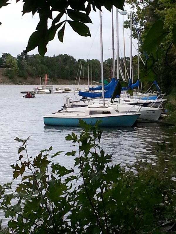

Sailing is over here in Northern Michigan. So the boat is in the barn and I have time for a thorough cleaning. The smooth parts of the fiberglass are responding well to rubbing compound and elbow grease, but how to get the dirt out of the textured non-slip areas? Power wash? Stiff bristle brush? Bleach?
I know I'm a retired dentist, but PLEASE don't make me do the whole thing with a toothbrush.
I'm a retired dentist too. Stiff scrub brush and any boat soap. Works really well in the backyard on the trailer when you have plenty of rinse water. I think this is quicker than the power washer.

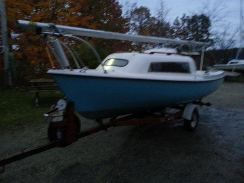

On my Siren 17 that I dragged out from under pine trees ware it had sat for 7 years and had raccoons living in it, I used a 2000psi power washer. That wasn't good enough. So I purchased a hull and deck cleaner (Can't remember what brand. See pictures.) and used it. Still stained...
So I went to the hardware store and got liquid drain cleaner. (ACID! Two types if I recall properly.)
(First I put on goggles, rubber gloves and an organic vapor respirator then \ put the drain cleaner in my garden sprayer and sprayed the deck and hull.) Don't do this on the lawn! Don't do this with cars parked near either.
(\ then took my soft car wash brush and gave it a rub allover. Then I power washed it off.)
I won't say to do a test spot because if you try this you are going to loose the top layer of gel-coat! It's Acid! It eats fiberglass and You!
The outcome from my acid dip was very good. There is one spot about 2' by 1' on the Port seat in the cockpit that looks a little thin though...
The acid opened the closed pores of the gel-coat so now they needed to be sealed to prevent staining.
I should have used wax. I didn't! I went back to the hardware store and got industrial floor sealer! Why...? Because there was a bottle of industrial floor sealer stripper right beside it. And I was in a hurry and didn't care too much about how long it will last. (The boat was free...)
I used my garden sprayer and soft car wash brush again.
It look fabulous! I get all kinds of great comments on how "New" it looks form people at the yacht club and different marinas I've been to with it.
I do not suggest that anyone else try this technique! It's dangerous and can ruin your boat!
So far the floor sealer has lasted except ware I put my hand on it after spilling a bit of fuel on my hand. It has browned and come off a bit in that spot.
Some of the crazy things I did to the Siren start about here: http://forums.macgregor.sailboatowners.com/showthread.php?t=156758&page=15
Pictures are kind of self explanatory.
Remember NOT to try this at home! The raccoons hate it!
I now have $125 and allot of labor invested in this boat.

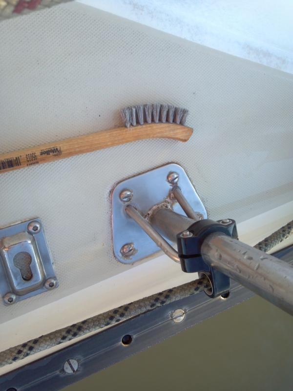

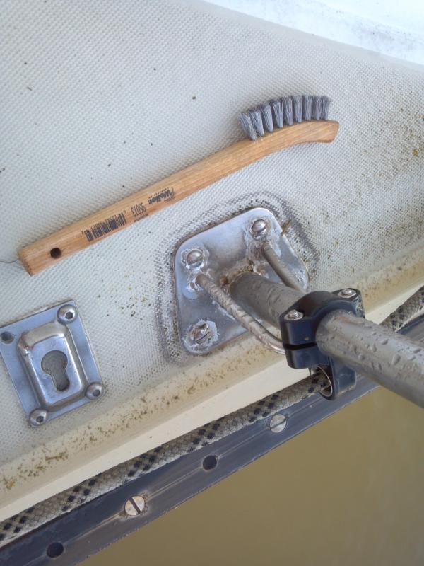

...don't like pressure washing on a regular basis...... it will eventually ware the surface to a frazzle...
too much pressure can ruin any surface, but with a lower setting it will do no damage to the gelcoat or fittings/hardware, and technique/experience may play into this a bit also.
it can damage unfinished wood surfaces and soft material like canvas and lines... but this is where technique and experience come in to play...
a small affordable automotive type pressure washer that puts out around a 1000psi is a great tool for washing the boat... depending on where you keep your boat, it usually only needs a pressure washing once or twice a year.
and I dont care who you are, where you are, or how much effort you put into it, a pressure washer with a good chemical will clean nonskid better than any plastic brush and cleaner,
the only thing that does work better is a very fine stainless or copper brush and chemical... but then the effort is at least a hundred fold.....
the following pictures show what a fine stainless brush can do... with no damage to the gel coat.
I tried hand washing and brushing with awsome to remove the black, it didnt work... then I tried pressure washing and pre-soaking with harsher chemicals, and still did not get the results I was expecting, but when i used the stainless brush and awsome, it came right up... and it did not scratch or erode the gelcoat in any way.
I wont say you can use a coarse brush without damage, but a brush with fine bristles that can be drawn across your hand without damage can absolutely be used on gelcoat without damage.
(another harsh chemical that can be used on gelcoat, NOT paint, for cleaning the stubborn spots is easy off oven cleaner.... it will remove oxidation with very little effort.... any acid will remove tannin or rust stains)
