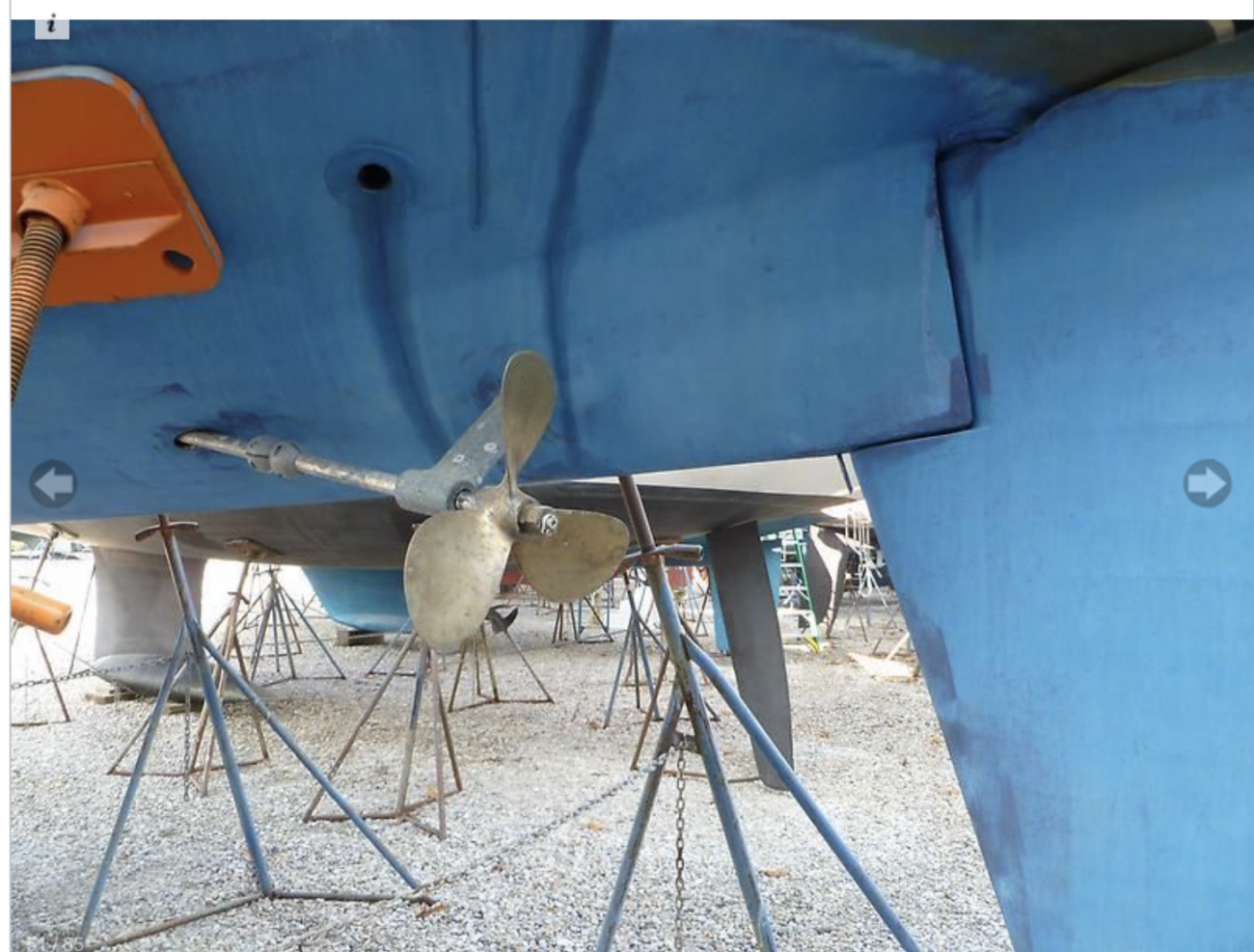

Looking at pictures of a 36, there are some interesting features of the Sabre that attract the eye.
The deck space appears to be generous. Easy to move from cockpit to bow.
I was curious about the shaft on the boat. It appeared to be coming out and an angle on the port side of the boat. Is this usual for this boat make. I would guess that gives the boat a decidedly strong prop walk.
It would also suggest the need for a folding prop so to minimize drag when sailing.
