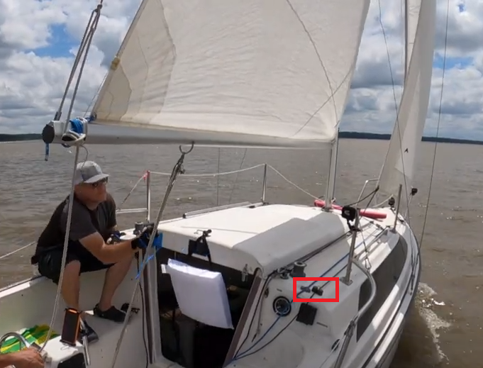

I've had a hank-on jib on my 1996 MacGregor 26x since I bought her new. Now, approaching 70, I'm looking into purchasing a CDI roller furler with 150% genoa sold by Blue Water Yachts (roller furler currently not available to order due to out of production). BWY recommends and only sells the 150% genoa which would appear lines need to go outside the sidestays.

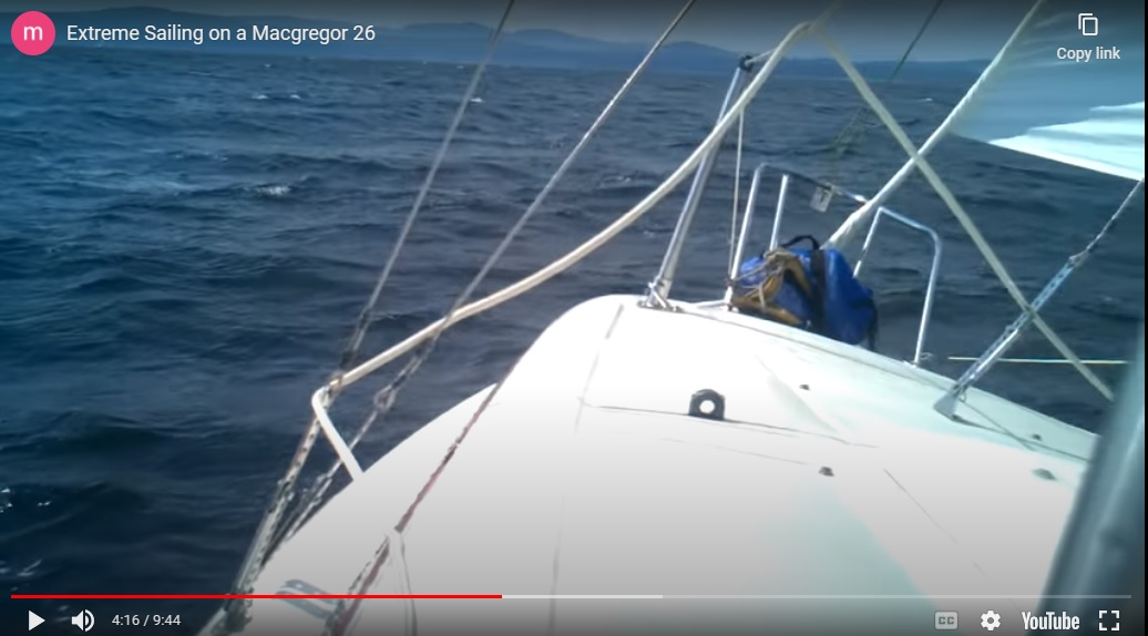

I haven't been able to find a sailing picture yet that shows that configuration (although could be in picture 2 below). I saw YouTube videos but one stated they had a 115% genoa which is probably what is in picture #1 below. The sail and lines would be inside the sidestays which is how the jib works now. I'm guessing the deck hardware needed per BWY is in the picture #1 that I boxed in red below. I'm not sure if I have the expertise / ability to hook them up to the boat. Any recommendations on hardware installation and how the lines run to the cockpit with 150% genoa?

Does the 26x have winches on the cockpit coming?
if not, I don’t know how you could run the sheets outside of the shrouds and then up to a cabin top winch.

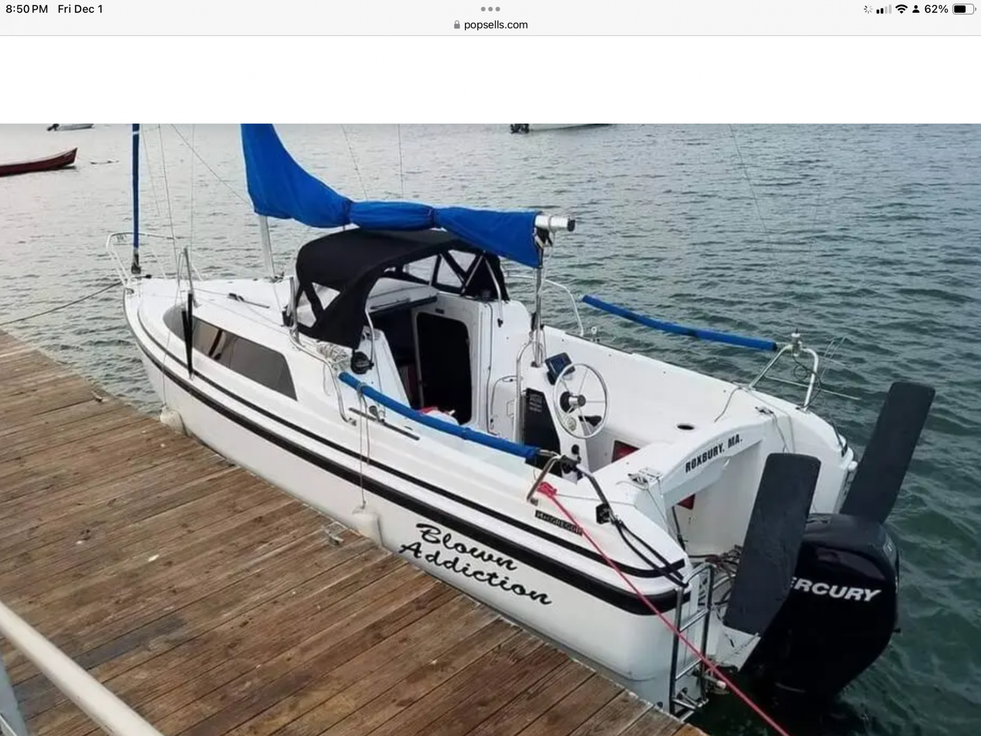

I found this photo and I don’t see primary winches on the coming.

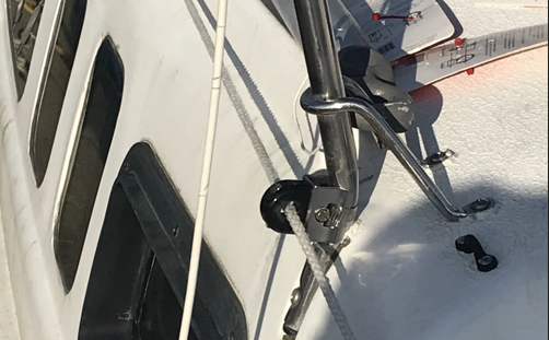

I used this fairlead to run the lines outside the stanchions

In the pic with the red box drawn I believe those cam cleats are for the halyards. The sheet appears to go through a block on a track (I kinda lose track of it in the pic) and then back to a cleat by the companionway. Normally a sheet would have a fair lead to a winch and then to a cleat but maybe a winch isn't needed on this boat.

Appreciate the responses and suggestions. Yes, Blue Water Yachts specializes in MacGregor parts (boat no longer in production) and my winch is as in picture #1. Some of the concerns with the 150% genoa on this boat are same as mentioned. I will inquire next with BWY on rigging of lines from 150% genoa. Fortunately, I'm still agile enough to go to the bow to secure the standard jib after lowering.
