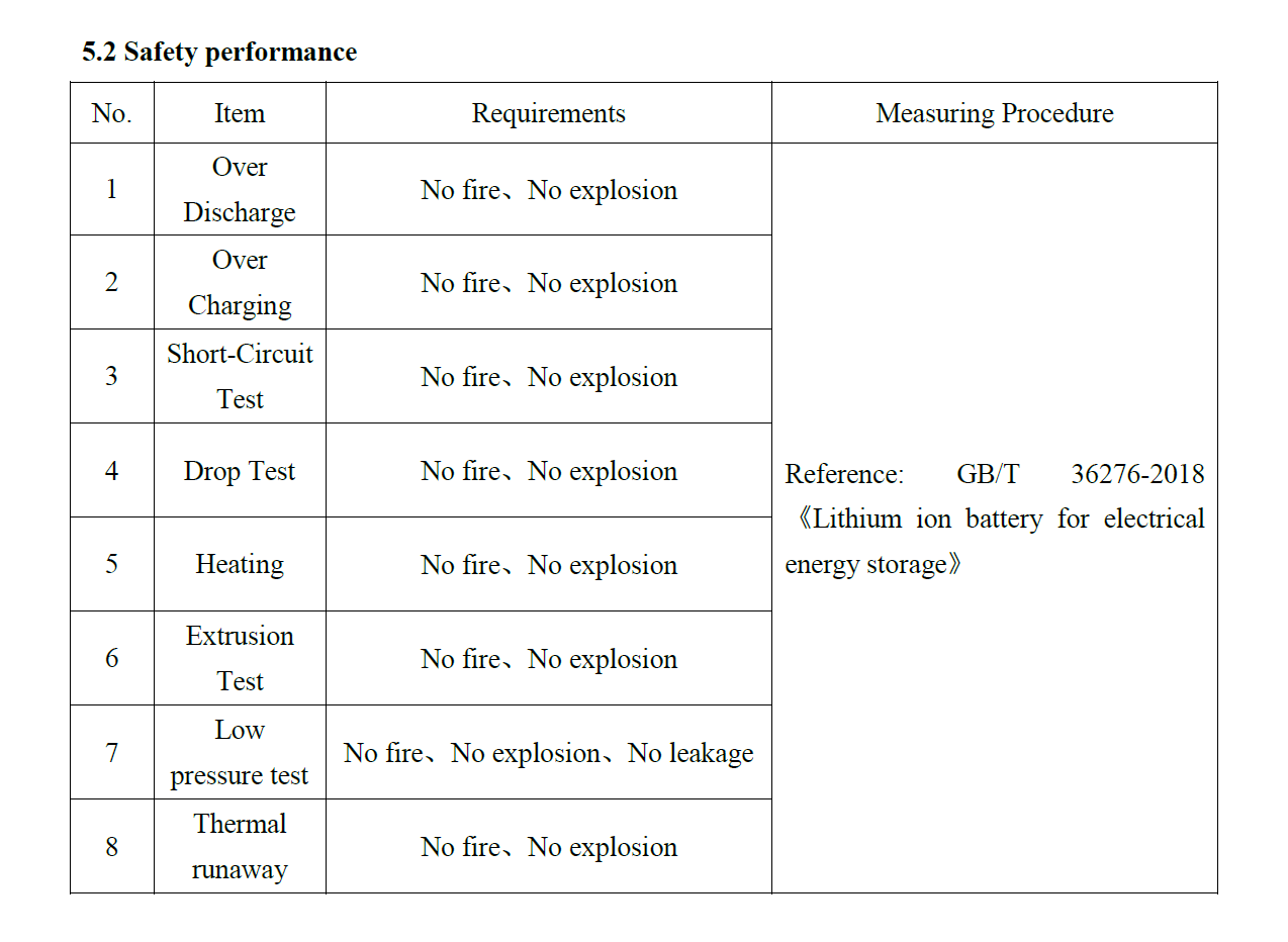

I agree with @jssailem . The chemistry in a lithium pack is very important. I am a very big fan of the power available in lithium batteries and have 560Ah in my boat and 920Ah of LFP in my motorhome. The LFP cells are very safe with no safety warnings. (see below)
The NCA, NMC, LTO and LMC not so much. For me, LFP is the only chemistry I feel safe to use on a boat because all of the others like to do bad things like catch of fire when they get wet.

Mar 8, 2019
111
ODay 322 Bodkin Creek, Chesapeake Bay
Definitely start with a power consumption budget and also would recommend LiFePo4 due to weight for smaller boats. A note on use of lead acid in either 6 or 12V is to remember that you really only get to use half the rated amp hours. Repeated deeper discharging will quickly reduce capacity and kill wet cells or AGM. For a 26 foot boat, 6V batteries can impose a big weight penalty.
Interesting to see mention of the GB/T standards, as Green Blue Technical are Chinese versions of the Western UL, SAE, and ISO. At this point the Chinese are ahead of the West in EV adoption and experience so it's good the GB/T are online (GB/T 36276-2018: PDF in English.).
When they are cited, also look up the equivalent Western standards as some of the Chinese ones are rather generic. For example, note that nothing in 36276 prohibits thermal runaway or profuse smoke generation, just "...no fire and no explosion." The hot smoke can ignite paper or other flammables. That said, the Chinese have some requirements for EV car batteries which are better/stricter than the US & Euro are when it comes to floods and water intrusion (IP65, IP67, etc).
btw - Those other chemistries won't necessarily catch fire if wet, it comes down to how well the hermetic seals hold up. For example, up to 3,000 EVs were flooded after Hurricane Ian, most of which had the hotter chemistries, yet there've only been something like 17 fires. (0.5%)
