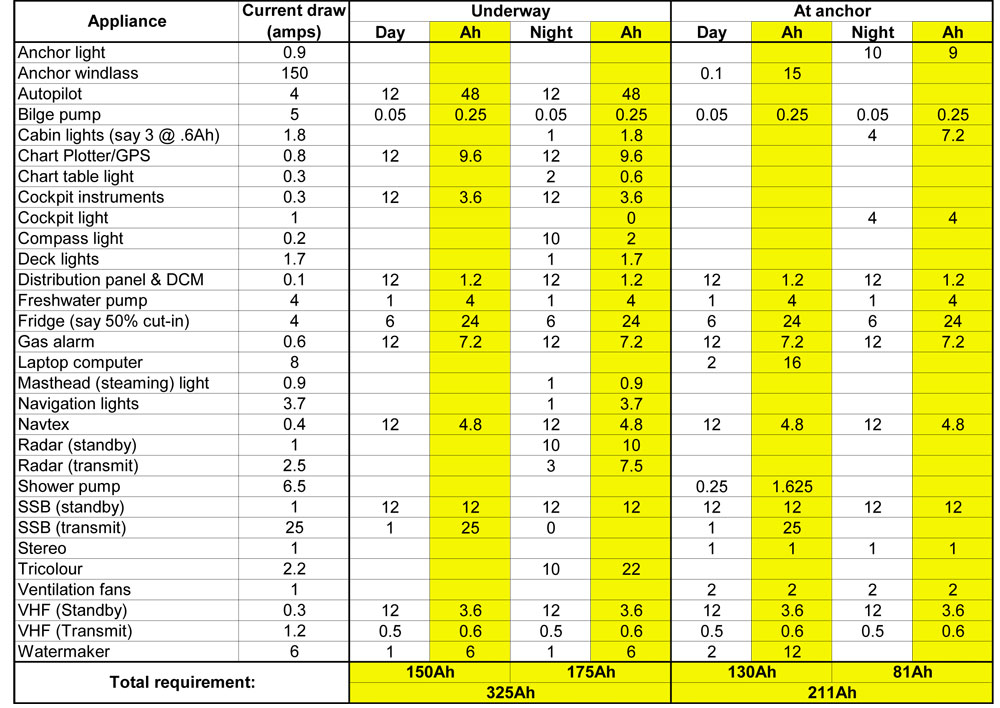

Start with calculating the amount of energy that you will need to power your toys for as long as you will go without charging. Now double the amount of power you will use to stay above 50% of the capacity.
In order to charge the battery you will need to put back between 115% and 125% of the energy that you take out of the battery due to charging inefficiency.
Once you have those 2 numbers, we can start seriously talking about what kind and how many batteries you will need. You will have to find a place to put them and how you plan to charge them.

@dlochner summed it up nicely.
I suspect the real energy hog will be the use of the inverter to power your dvd player. Inverters are inefficient as are dvd players. You might have better luck (and cost less) with an unlimited data plan and just watch netflix on your phone.
For most of us, I expect, this is an empirically determined value. That is, you know your power (and replenishment) needs after you’ve measured them over several iterations of use. My advice would be to build your capacity as you discover your needs. Adding up expected amp-hour demands versus supply, etc., is basically a “ball park” theoretical figure in my experience.

For most of us, I expect, this is an empirical value. That is, you know your power needs after you’ve measured them over several iterations of use. My advice would be to build your capacity as you discover your needs. Adding up expected amp-hour demands versus supply, etc., is basically a “ball park” theoretical figure in my experience.
@Kings Gambit is of course correct that real data accurately measured over time will give a better estimate use and demand than an armchair exercise. I've done both and I'm currently involved in a project where we don't have access to experiential data as it is a new build. That's the problem the OP is confronting, he doesn't have the experience on this boat to base his use estimates on. So, he is really left with an armchair exercise.
There are some pitfalls with starting small and scaling up. Perhaps the largest is undersizing the system by a large factor which requires essentially rebuilding the system from scratch. Increasing the size of cables or adding a new fuse bank are not that expensive, however, undersizing the charger will lead to an expensive replacement as will undersizing the battery bank.
All sailboats have limitations, going through an energy audit is important to understand the boat's reasonable limits. Sure batteries can be added, solar panels can be added, and a suitcase generator can be added, but pretty soon the sailor will be wondering where to sit and the boat will sail like an overweight pig. Probably not the outcome any of us seek.

Well, it’s true that one has to start somewhere. A large boat with many systems will of course require greater power use than a small one with few. So, no one would start with one or two starter batteries and work up from there for the big boat. If you’re going to run AC systems from an inverter for many hours a day, plus 12 volt, then yes an a priori estimate would be wished for getting started. Continuous demand is more easily modeled than intermittent, ad hoc, demand. The OP mentions items that suggest intermittent use, not on all at once, etc.; perhaps not daily even. He might easily overpower with batteries ($$) beyond actual needs. The boat probably has an ice box; why a 12 v cooler? Can keep stuff cold for several days using block ice.

I have seen lots of spreadsheets and apps to work out an energy budget but have never been able to get one that came close to estimating my actual energy needs. My C30 came with a link-10 battery monitor which told me exactly how many amps I use. Because of that, I know that on average, I use 100Ah/day in good weather and 140Ah/day in cold weather. Both of the RV's I have purchased since then the first thing I did was to install a coulomb counter so that I could find my energy demands to better know what modifications I need. Spoiler, I am an energy hog.
Because of that, I built a DIY 560Ah LFP pack for my boat for about $750 and am awaiting delivery of two 480Ah drop in's for my motorhome.
Likes: artleyt115
13,556
There is value in estimating the boat's energy consumption both for planning the system and understanding the limited electrical resource there is on a boat and the cost to provide that energy. We who live on the grid are largely blind to the amount of electricity that we consume any day much less at any moment. How many times a day do you look at your electric meter at home to see how much power you are using? How often do you do that on the boat? However on a boat with limited energy knowing that the refrigerator is drawing 5 amps for 45 minutes of each hour is important. Or knowing that it takes 10 amphours to run a DVD player and TV for a couple of hours while a tablet will only consume 2 or 3 amp hours in the same time period.
An energy audit is as much an awareness exercise as it is a planning exercise.

Okay I've seen a lot of good feedback so I am going to answer some concerns here and what I currently plan on doing.
So, why the cooler. Yes I do have an ice box but I also have a dual zone 12v cooler that I can set one side to be a freezer and one to be a fridge. It doesn't take up too much space, fits in the spot where my ice box used to be and if I go out for a bit the cold snacks are good. (also my ice box isnt in the greatest shape)
inverter: I do not plan to run AC or Heat in the boat currently, the inverter is strictly for the monitor and dvd player/media player, which will be ran intermittently. I do see the point of using my phone however, eh I just kinda want the better viewing experience there tbh. Not like its huge and I have a way to stow it when underway.
Where is my boat?: It is on a trailer, not on a slip. which makes charging batteries before a weekend/week out adventure a tad bit easier.
items I forgot to list: bilge pump and windlass (the windlass will be on a separate battery only because I have a spare one that will put up with it )
budget: Im shooting to be under 800. I do have a 100ah gel battery that has turned up cheap and I plan to test my system with, so if I have to pick up another battery that is fine.
Recharging: Now this has been a beatin' dead horse in another post I had where I plan to put a generator on the boat, I've heard a lot of concern from this. Reason I still plan to do this, the genny runs both on propane and gas, has a 12v connection designed for both marine and rv applications. Can also run a 120v outlet while running 12v and this is a backup system. I don't plan to run this 24/7 but If I lost all power one day out in the water I have this as a backup. Solar panels, I do plan to add at least one. I'm not sure on the details of it only because It is a future plan when I find out how much power I use on a weekend
What I am going to do: SO as of now I have a battery monitoring system that I can watch the consumption that my whole system takes and I will run it on the shore using various electronic items and see how long my system last and what rate I will deplete my batteries. Then I will make a adjustment as to how many batteries I will need. As for the one I have currently, its a new gel battery hopefully it will pan out but i am willing to make a change. I was writing up a spreed sheet but got side tracked. I knew I owed all of you a response so I will keep working on the sheet and compare to my actual usage
