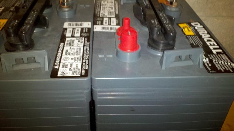

Can you get to the US of A? That Deka is the same as the DuraCell that I recently purchased I think. A pair was less than $160. at Sam's Club.

A "few bucks"?! Is your cost of $150. for one 6v battery or two? My 6-volt DuraCells are 235aH at $78.00 each. I'd spend an entire day to save $140.00. Four hours drive at 15 mpg still saves you $100.
