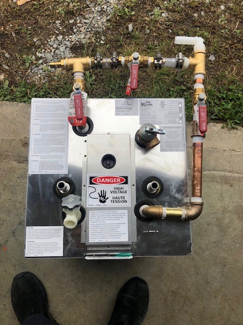

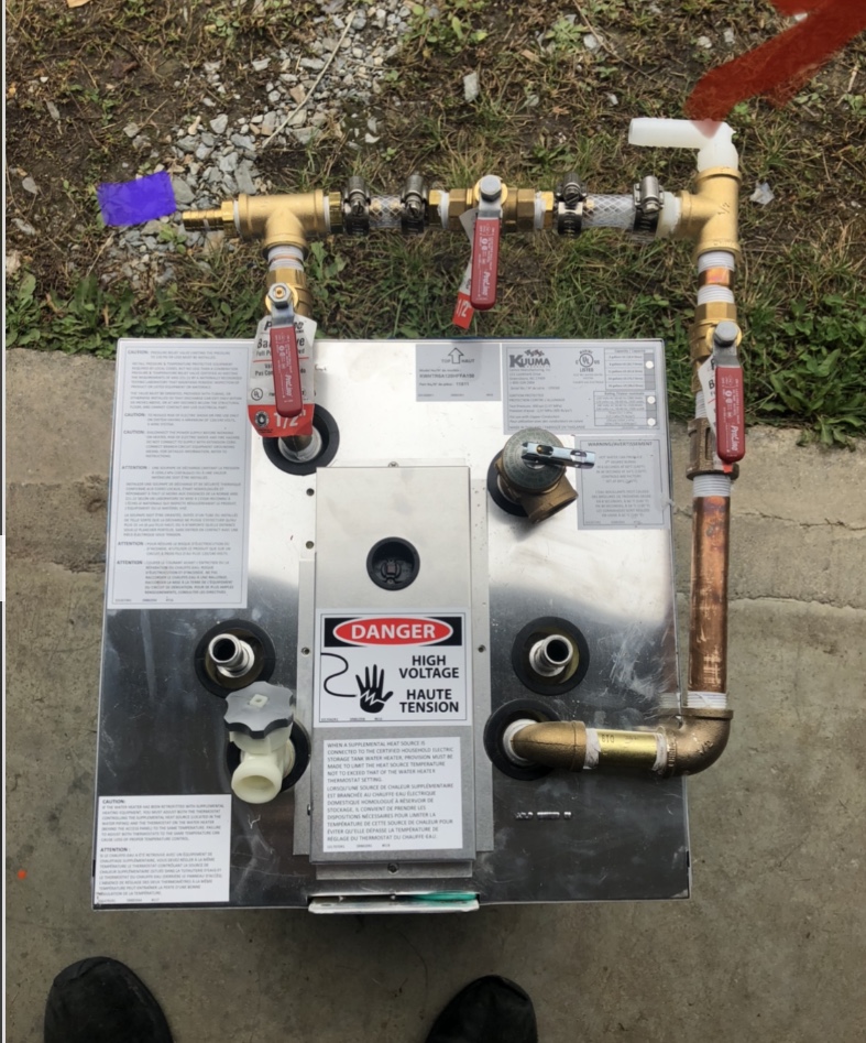

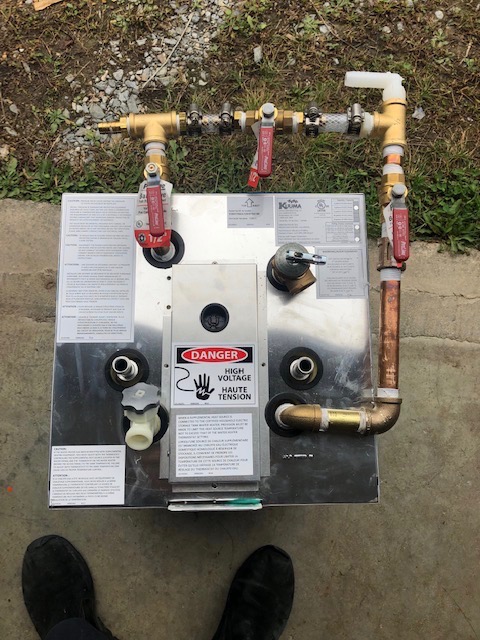

Sailme88; could you add labels of inputs, outputs and parts? For instance, what is the white fitting on the upper right,
the fitting on upper left and the two silver ducts in the center. Also, how to winterize this set up? Mine looks a lot different.
Maybe mine is a hot water heater? LOL. Thanks
OK, here you go.. Top right corner is a white barbed elbow with a RED tag near it. This is the cold water inlet. Directly below is the cold water 90 degree ball valve. Allows or stops water into the heater. In the middle is another 90 degree ( quarter turn) ball valve. Closed in the pic, it prevents cold water from mixing with the hot. Below it is the relief valve. Below the relief valve and above the cold water inlet is the hose barb ( silver ish) this is the hot water loop inlet from the engine ( heated antifreeze). Back to the top on the left is the hot water outlet (purple tag) with isolating quarter turn below it.. The valve below that is the tank drain valve with the antifreeze loop outlet just above.
