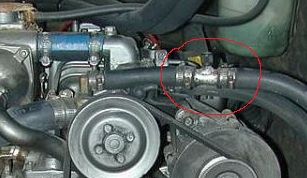

This may be a dumb question. What is the device circled in the picture attached? I have searched and found nothing. My best guess is, it's to purge the air out of the water heater line. :confused:
Jan 4, 2006
7,611
Exactly What it is .....................
................. particularly when you are re-filling the system after an antifreeze change.

Thanks for the replys. I have seen many installations that don't have it.

Joker, well this is timely. we are just installing the HW tank on our Bene with a Yanmar and saw this post from a while back. This bleeder thing looks interesting and makes sense. Any idea if it is an off the shelf item?

It was factory installed when I got the boat. Maybe someone else can say where it can be purchased.
It looks like an air valve on a tire. You press the stem to let the air out. I would assume some coolent will also spray out.
As an alternative:
I came across this http://www.yourcustomcar.com/coolant-bleeder-valve.html. You would put a "T" in the coolant hose and intall the bleeder.
Then you can run some tubing down to a pail to catch the over flow, rather than it spraying around the engine compartment.
Just an idea.
