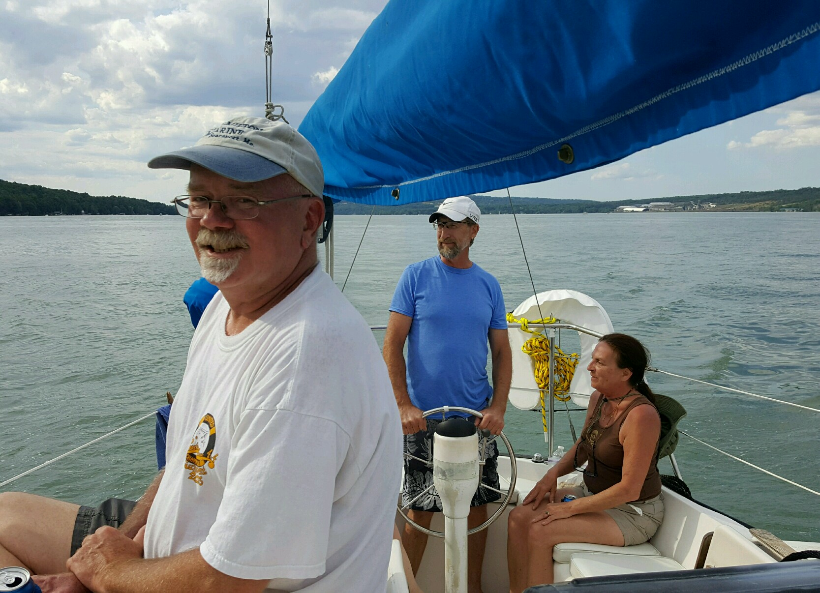

This question really goes out to the anal retentive and those that are master line and knot makers. I bought a new horseshoe buoy and brilliant floating line to replace the nonexistent safety gear, previously mounted on the stern rail. The image below shows the present hob-nob birds nest my crew came up with. If I had to actually throw that thing to a fallen sailor, it might take me more time than warranted, to figure out the bailing, lift the preserver off the mount, and chuck it to an OB human. Please, anyone, show me the way. The present mount is shown behind the dude driving my boat on a windless return to slip on Cayuga Lake.

I suggest practicing. That should show any issues your present system might have.

Yeah, but I can't find any crew members to splash in water that's 55-60 degrees F one foot below the surface. We have practiced rescue the hat a couple times. I still have my hat.

You don't really need crew in the water to practice deploying the gear.

I would install single cord with plastic clip to secure the float to its mount. Stuff the line into a cloth bag with a flap closure and a hole in the bottom so it can be tied to the boat. Don't coil the line, rather stuff it in from boat end at bottom to horse shoe end on top. A coiled line would require you to uncoil and flake before deploying the float. The other way allows you to quickly pull the loosely stacked line out of the bag ready to go.

Get rid of the line completely. Most horseshoe bouy's don't have one. A life sling does. The person in the water would rather have the bouy that watch you fiddle with the line.

Throwable flotation devices do not need lines attached. If the line tangles, the float gets pulled away from the overboard person. Likewise, you are assuming with a line that you can pull the person to the boat and aboard. This may not be true. Especially in the cold water you mention! Which I happen to sail on as well. Right up til June, the water in Seneca made my feet ache in less than 3 minutes. Your man overboard will need more time than that as you sail a figure 8. You need to be able to manuever to do a man overboard drill. You cannot manuever without releasing the line, or you may over run your line.
Look up the ASA drill. It will show you what to practice.

Got it folks, especially @agprice 22. No need for line. Just chuck the floater and orient the the boat for retrieval. This I can do. I'll practice this weekend with a couple of unsuspecting crew who are great swimmers and only care about 55.degrees F for a few minutes. Winds are supposed to be dead calm to 5 knots on Sunday...most likely a motored retrieval once the sails are doused.
