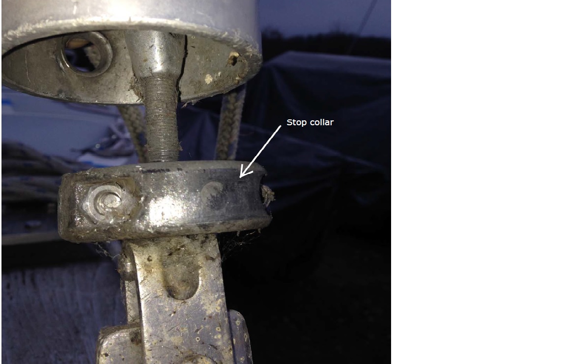

For anyone with Seafurl 810 LD experience. I've determined that I must replace my bearings and I'll get a set through Marty (who has already been very helpful). However, I cannot release the 4 allen Sheave Set Screws. But, we hope to be able to do so once we’ve removed the unit.
I’ve reviewed a few blogs on the topic and it appears that with at least 2 halyards secured forward and the boom removed (or unweighted), the Seafurl unit can be pulled down off the forestay without removing the extrusions. Then, after reattaching the bottom of the forestay, the unit can be maintained and replaced. It this a valid procedure and will the unit slide down off the forestay once the stop collar is removed?View attachment 143392 This is 'George Da Prorge's' forestay but its exactly like mine. Thanks for the photos Jorge!

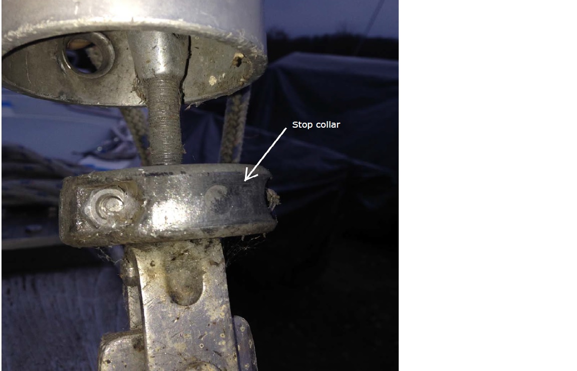

The Stop Collar in the picture was the part on mine that was broken when I got her. Pompanette was able to get me a replacement. I see in the picture this one is lubricated. I did not grease mine as I saw no indication of previous grease. Does this help it in any way?

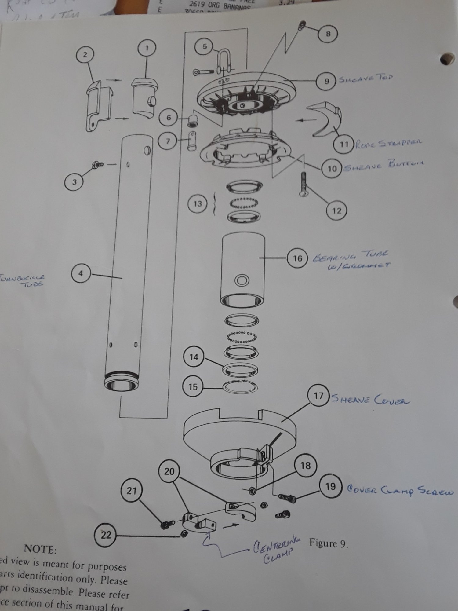

George - I took apart my Hood 810 furler to fix the toggle jaw & clevis pin.
Like you, I was surprised to find the ball bearings all over the place. I put half of the ball bearings back in place at the top of the Bearing Tube (Part 16) which was simple as there's a 'race' where the ball bearings easily fit. However, I'm not able to figure out how to get the remainder of the ball bearings into the bearing assembly near the bottom of the Bearing Tube. Am I overlooking something, or is there some 'trick' to getting those ball bearings where they're supposed to go? Any help is most appreciated! Thank you!

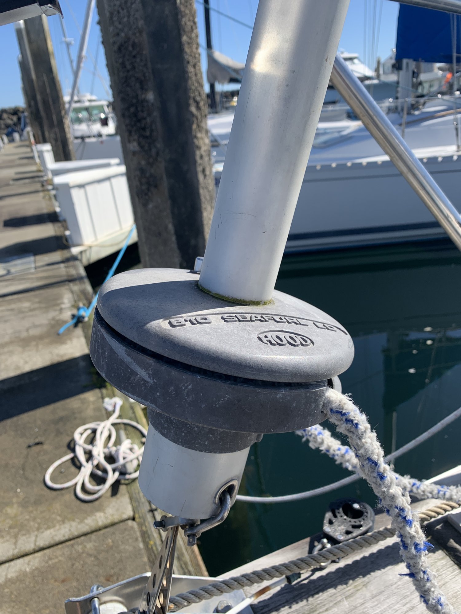

Hi George: I don’t know if you’re still active in this page but I was wondering if I could ask a few questions about the process of the subject above? Thank you

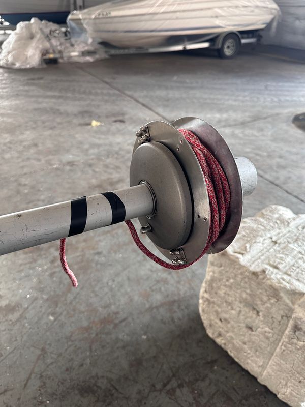

I was having issues with the spool taking up too much line with my genoa. I removed the drum and it stopped jamming but the line would fall down and wrap around the forestay while I was sailing which meant I had to go forward to untangle it when I wanted to furl. No amount of core removal or reduction in line size solved the issue. I ended up having a couple of plates fabricated to "enlarge" the spool. So long as I maintain a bit of tension on the line while sailing, it works great. I've rebuilt this twice. Green Grease and magnetized bearings/screwdriver helps when putting the bearings back in place. Feel free to ask any questions

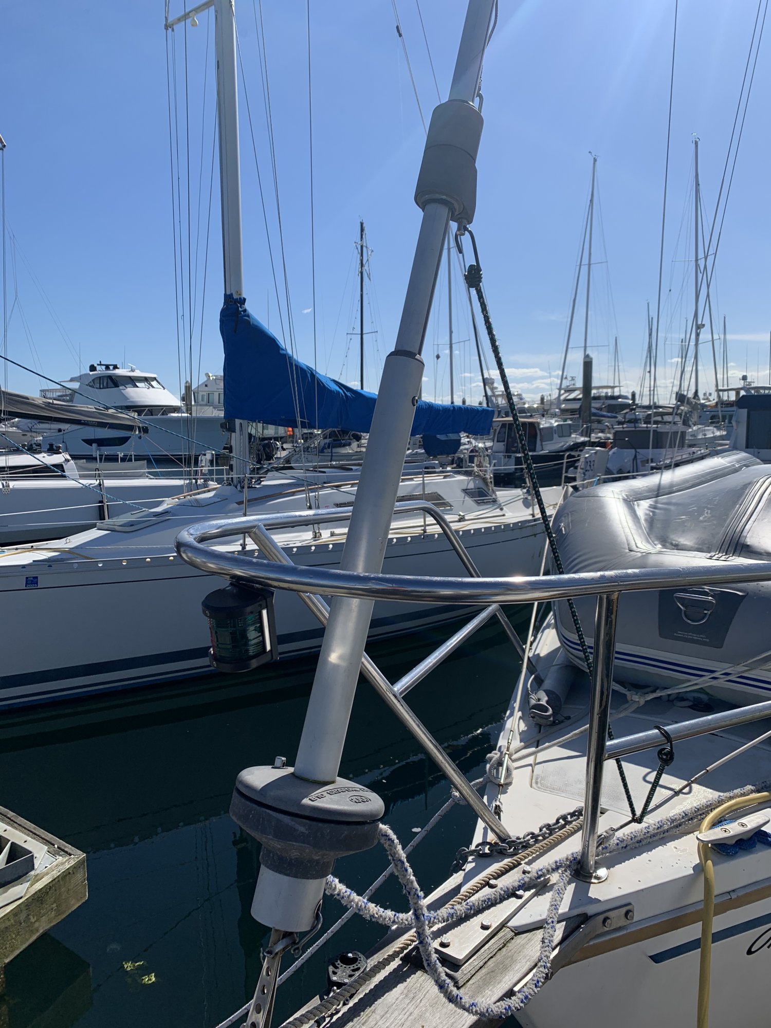

Thank you! My issue is I cant remove the tack socket to take off the drive unit, any advice. I don’t want to do the work over water and have ball bearings go everywhere. Images attatched.

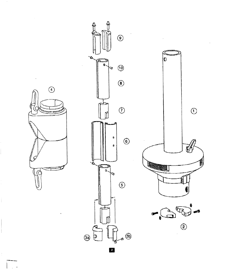

The way to remove the drum is by removing the first foil section Feed Extrusion [5] from the Drive Unit Asembly [1]. In your first photo, a screw is visible near the top of the thicker section [Drive Unit]. You remove that screw and then 1/2 of the Tack Socket [3b]. then you can shift the item 5 sideways which will allow the removal of the other half [3a].
After this is done, Item 1 can be raised up above the forestay turnbuckle so that it can be removed.
The bearings are non-captive, so it is best to rebuild on a bench. The actual balls are just 1/4" Torlon so you can get them from several sources.
