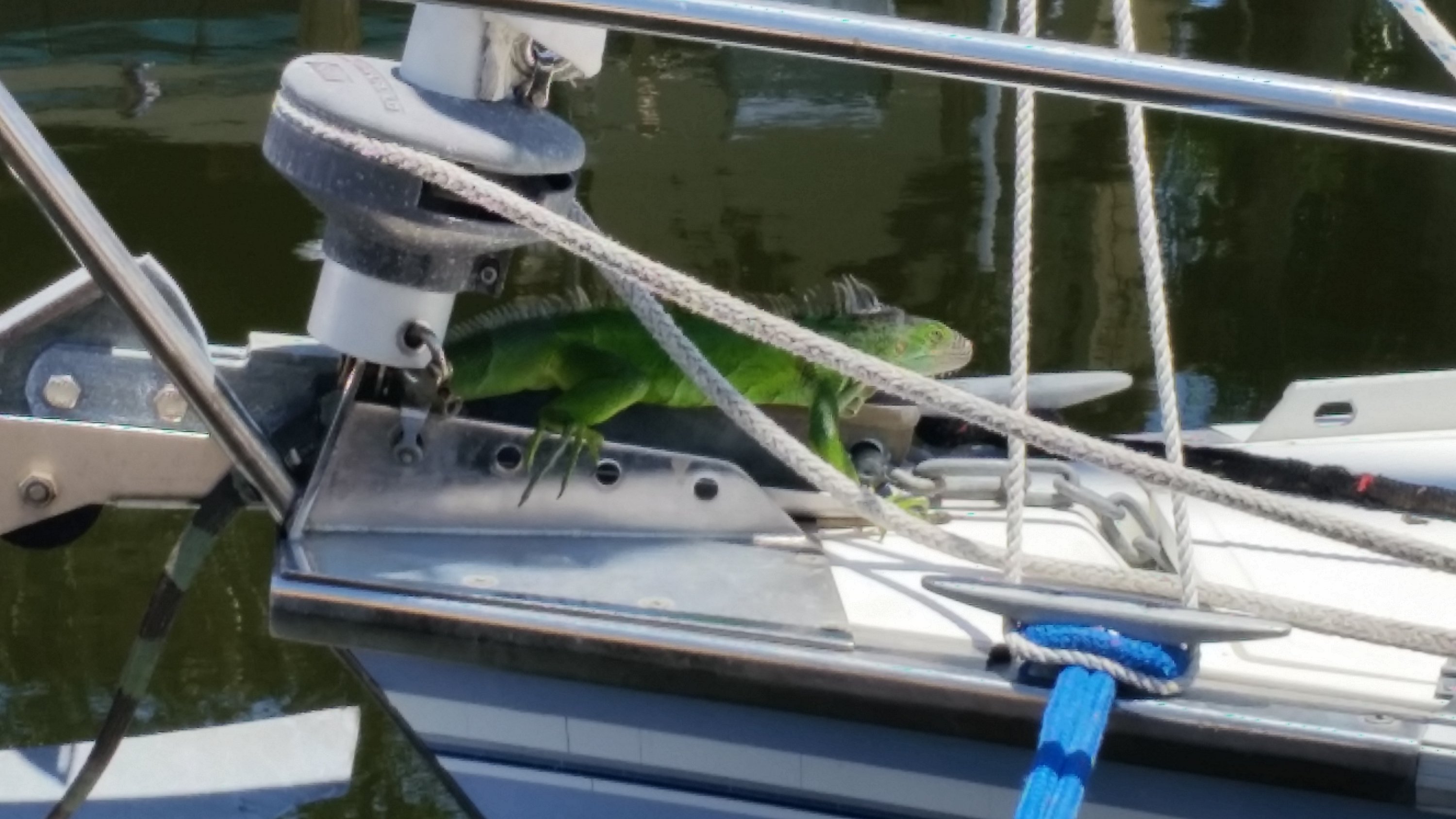

I have this very same issue, but my Hood furler is mounted above decks.
The swivel shackle it is currently using, lets the furler drum rotate too much messing with the angles to the inlet and outlet for the continuous line. Does anyone have any suggestions as to how to fix/anchor this drum so that I can keep it in line?
ps: I cannot tighten the halyard any further as it is all the way up. Replacement sail is a couple of inches too long.
Hi Chip, the strap worked for our situation. But you need to close the gap between the upper and lower part of your drum that allows the double line to feed out. The two parts on our drum are together, almost touching.
I already fixed that after the pic was taken. they are now tight together. Thanks though

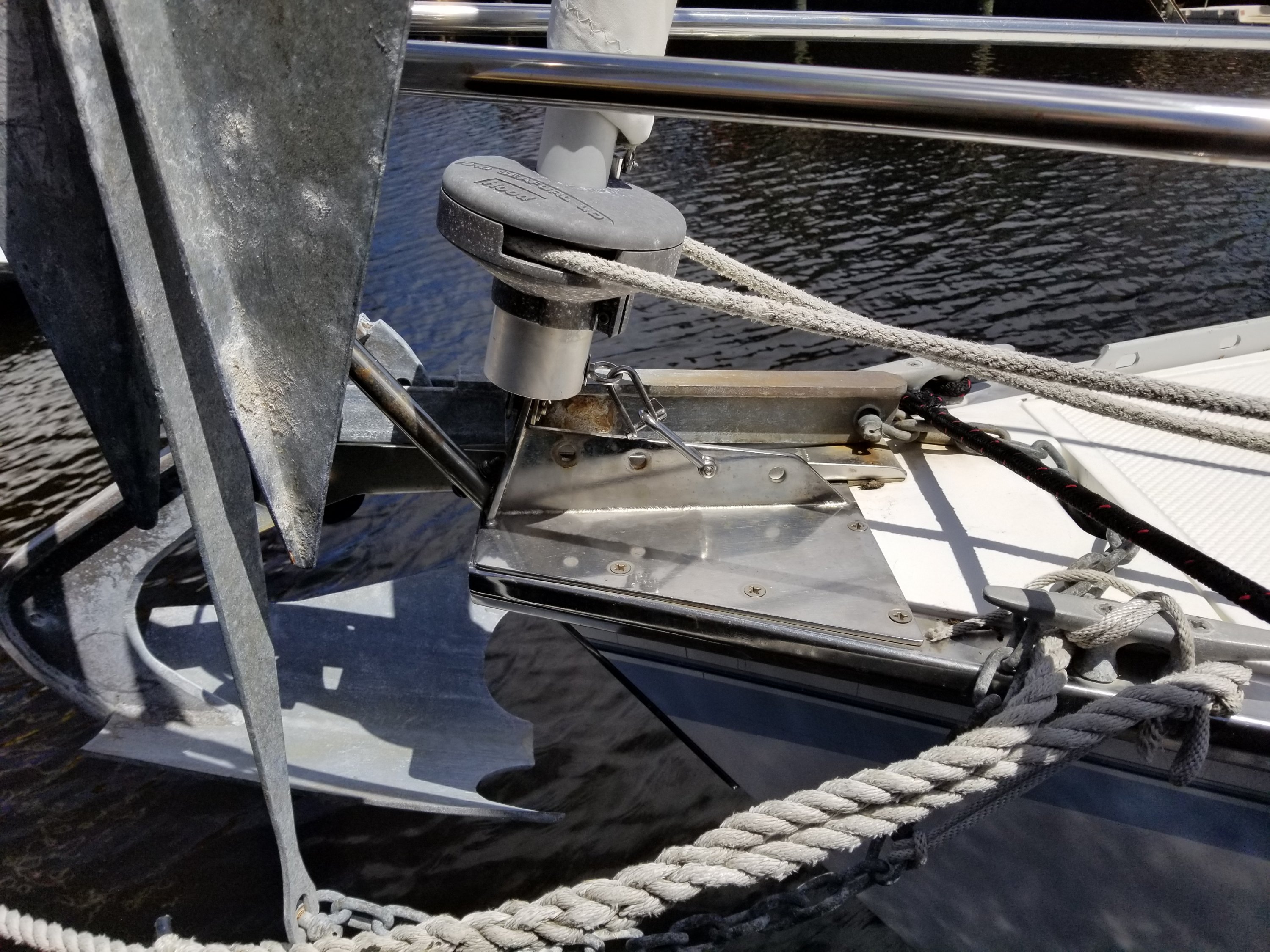

So I think I have it fixed. After multiple attempts with twist shackles, turnbuckles, and other assorted parts. (4 trips to West Marine), I ended up adding a ring with plastic spacers to the bottom of the drum, and then managed to find two shackles I already owned that just fit without allowing too much slack in the connection. In testing at the dock, this is now stable and spins freely without jamming.

Thanks for all of the suggestions.
pateco
Aug 12, 2014
2,207
Sailed her at our local club's beer can races last night. Smooth furling and NO JAMMING !!! Yeah!
