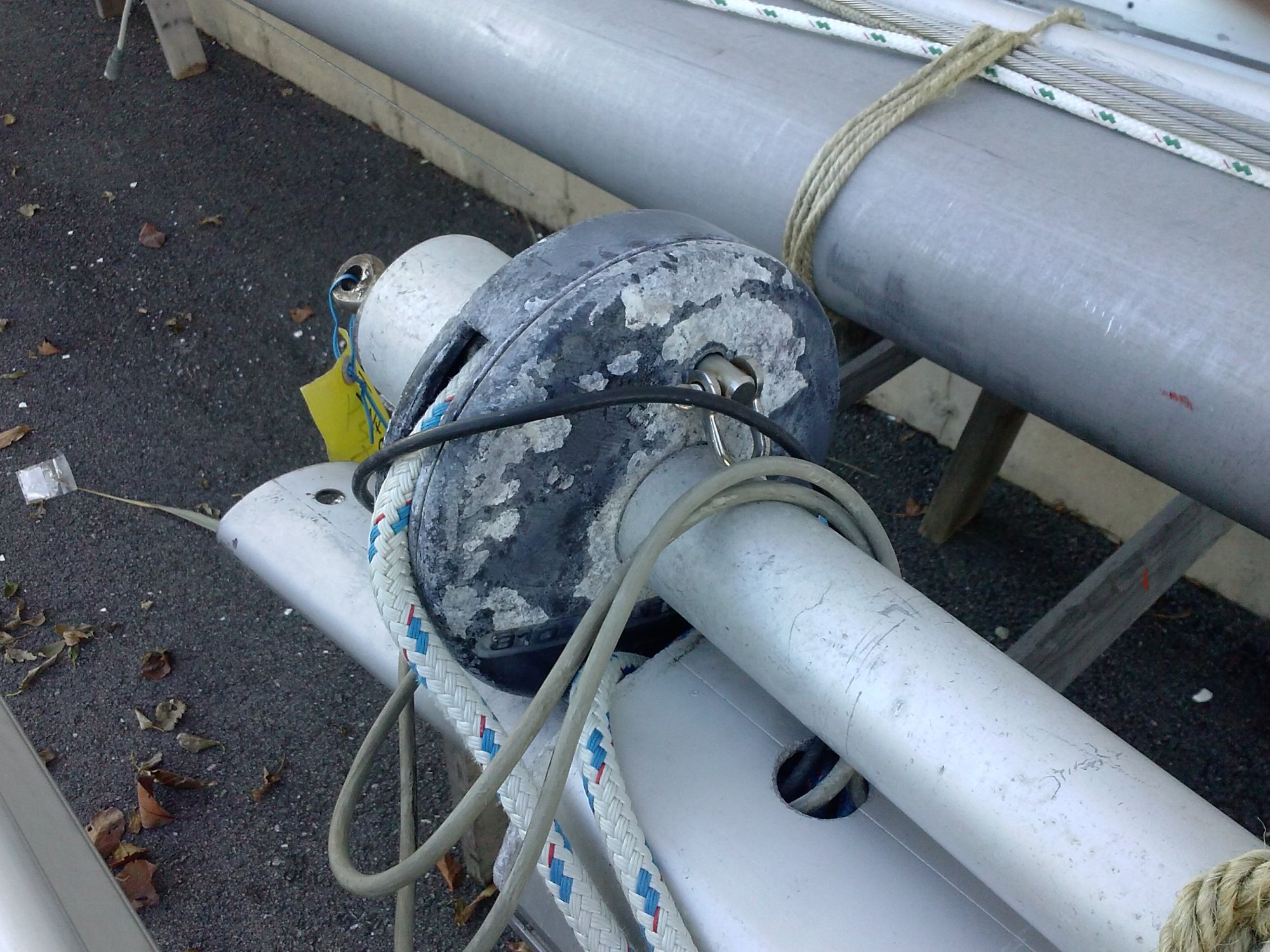

Additionally, make sure the drum and the halyard swivel both spin freely. These should be flushed with fresh water occasionally - can spray with WD-40 before flushing if it's really dirty in there. Also, make sure the furling line is in good shape, though problems with the line usually result in it slipping when trying to furl the sail in.
Let us know what you find. If you need some new parts, I have a complete 810 LD sitting in my garage that works but looks its age (see below) - seeing as you are local to me, you're welcome to it.

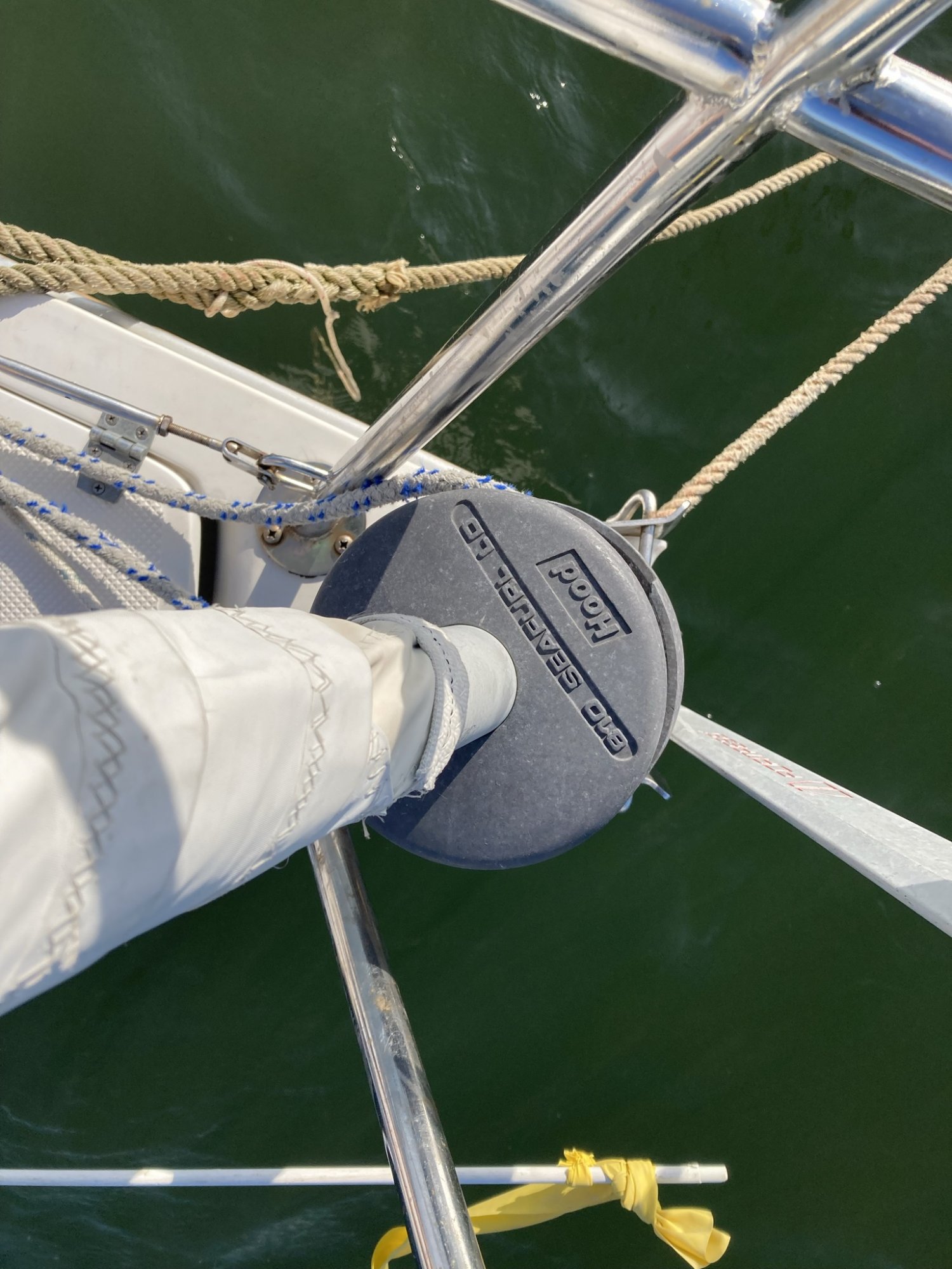

Furling line is not jammed. When I’m letting the sail out, it just stops and I have to go back and forth a few times to get it loose. Then, when furling the sail, I got it about 3/4 furled and could not get the drum to turn at all. I could unfurl it, but could not completely furl it. I tried turning the drum by hand and it just wouldn’t turn any more. I will check the Halyard. Could it be bearings?

It looks like the same one - yours is in better shape cosmetically.
I don’t know. My drum is open on the sides and if I don’t keep tension on the continuous loop lines, it falls off the drum. Your looks like the drum is enclosed with windows where the furling lines enter the drum.
I see that now, I do have smaller openings, I never had the line fall off the drum (I always try to keep tension on it when furling) so maybe it was an improvement they made.

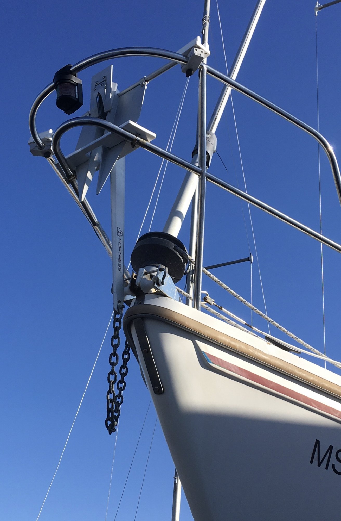

Thanks everyone! I solved my problem today! It turns out the problem was Halyard wrap. My sail didn’t go up high enough and the angle of the halyard coming out of the mast was way too narrow. I lashed a 6” pennant between the tack and the top of the furling drum which allowed me to raise the sail by 6”. This increased the angle of the halyard to about 60 deg. from the mast, which will make it impossible for the halyard to wrap around the stay. Thanks for all the feedback.
