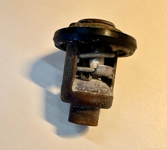

After some more research I discovered Honda OB's have thermostats. If they stick the engine gets too hot and starting and performance problems ensue. Removed the thermostat, ran it until it was hot and waited 20 minutes. It started. More trial runs will be necessary to be confident.

I may have spoken too soon.:confused:
Just went out and tried to start it, a hard no, deeply comatose.
