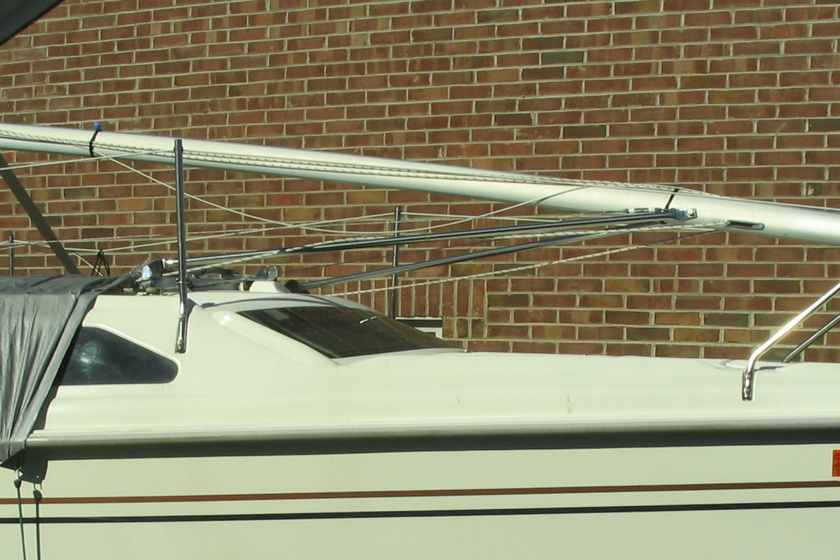

Yes, the fixed mast struts are never disconnected, they rotate from fore to aft as the mast is lifted and moved back to the deck plate. As the mast is moved back out of the bow crutch they rotate up to vertical, and then back down aft of the mast step. And ideally the mast plate and deck plate should line up. The attached photo might help.

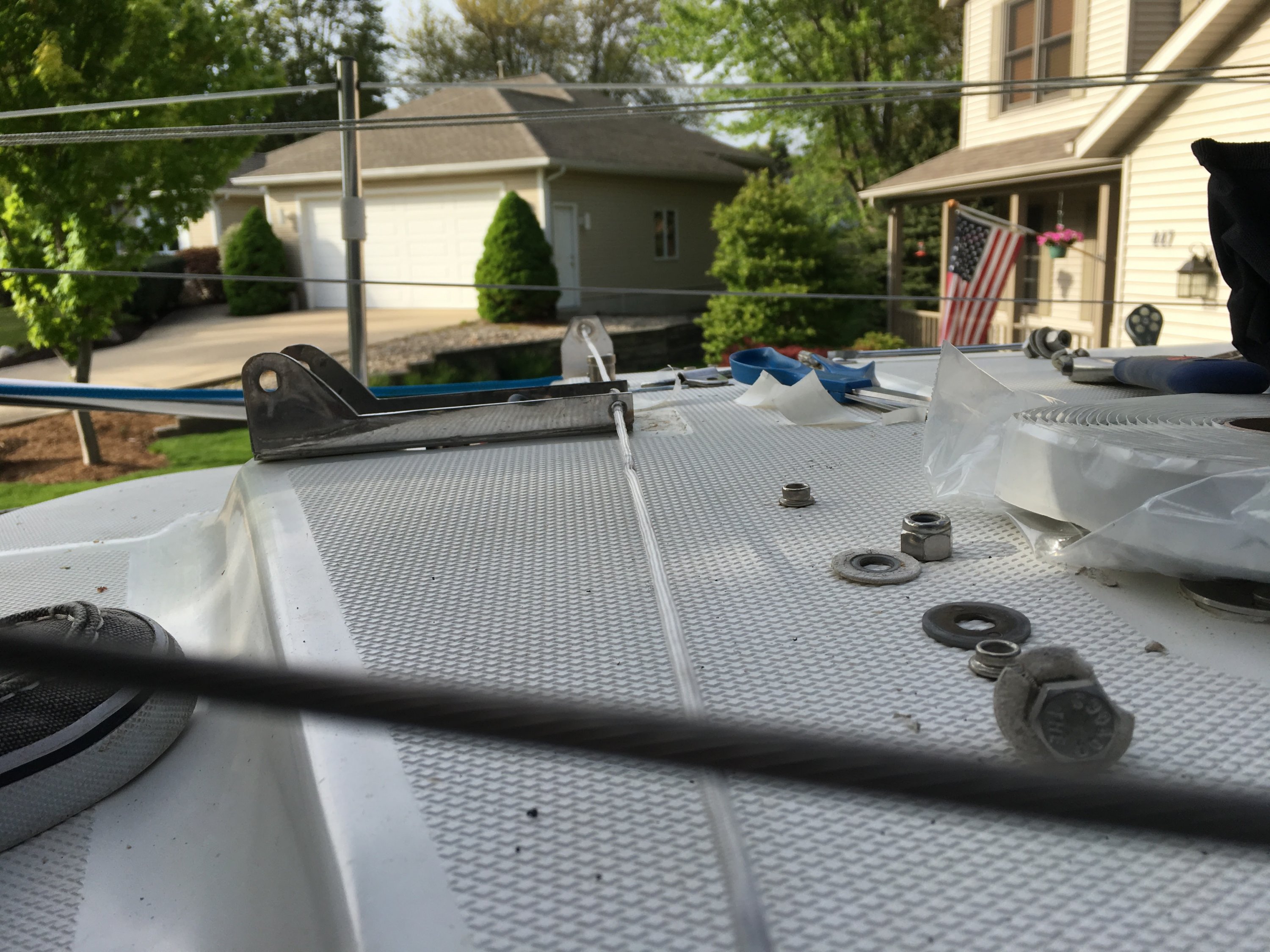

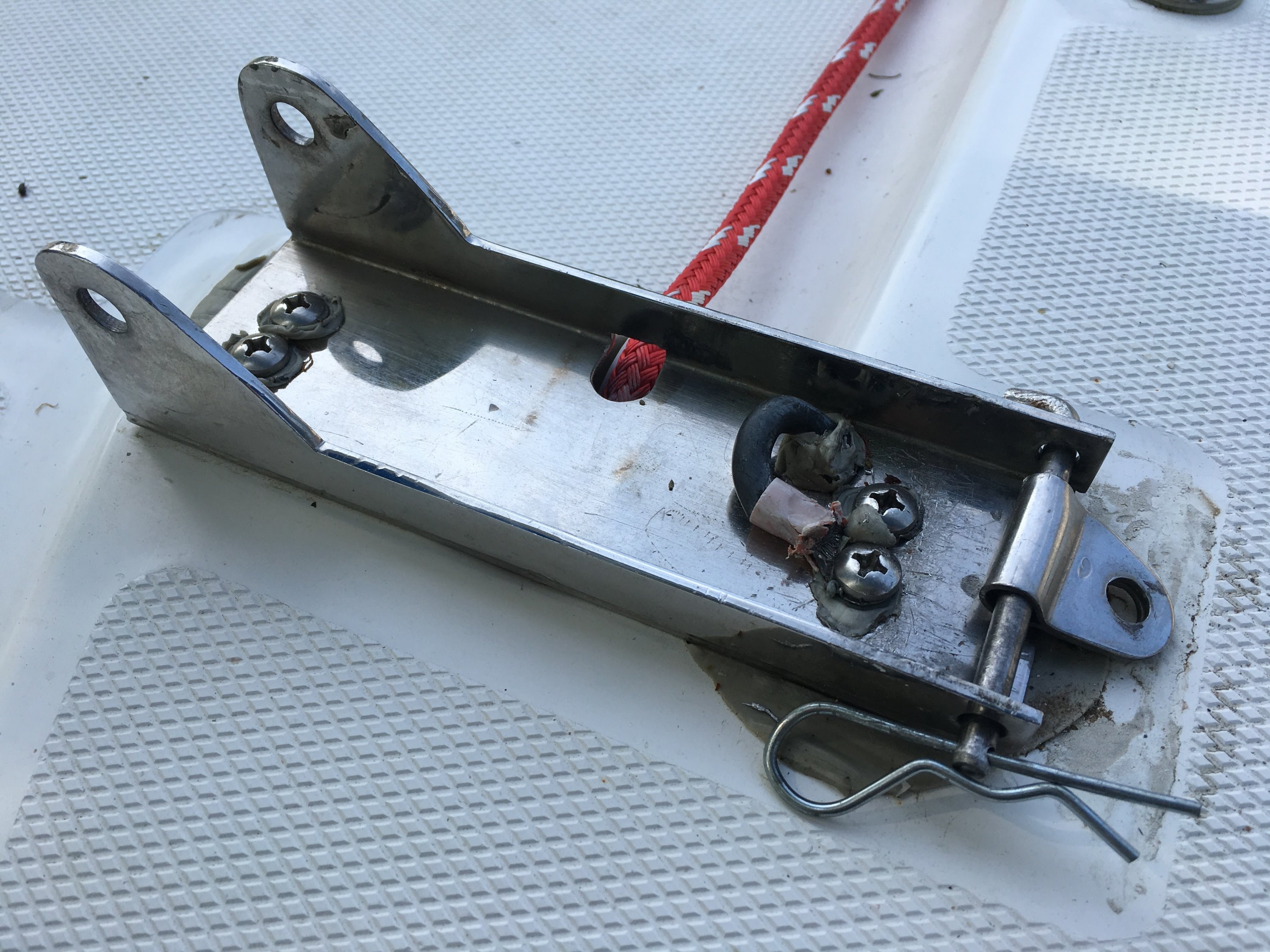

OK, I did a bit of digging around last night to verify my original thoughts. What I suspected was that the side strut mounting bracket holes do not line up with the holes in the mast base plate. It's a bit tough to see in the picture, but in theory the four holes should line up on the same axis; they certainly don't! Not too surprising they are off by almost exactly the same amount as the mis-alignment of the mast base hole to the deck plate. I have no idea why it would be like that, or if it was just that way from the factory. Now, what to do to fix it.
I will send you info Dave, thank's.
More fun to follow.

That would be the way to set it up originally I think rgranger. The problem is that the bolts that attach the brackets to the deck are either 1/4-20 or 12-24 thread. I'm afraid that if I move them to the correct position, when I drill and tap the new holes, there will be almost no material between the old holes and the new holes.
It's just the wrong amount of "messed up" I think. Hmmmm.
At this point, I am leaning toward removing the mast base deck plate and drilling a new set of holes 1/2" forward of the existing holes. This seems like the least invasive approach and is reversible as well. If I don't like it, I can just go back to using the original holes.
