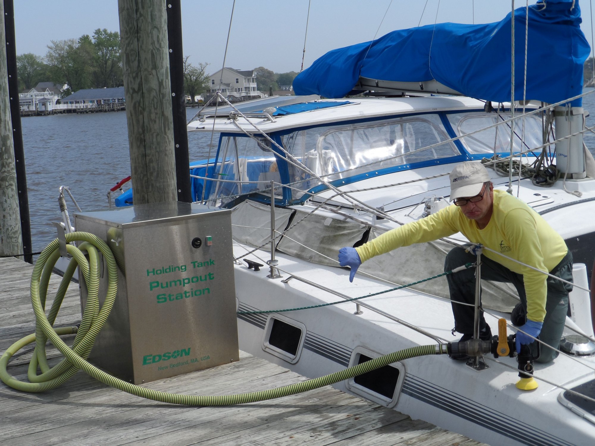

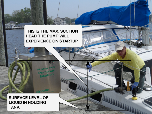

Another common cause:
Did you take ALL of the loops of hose off the rack before pumping? If not, the water has to rise 2 feet for every loop on the rack, yes, it will syphon once totally full, but it isn't to start, and if there are ANY air leaks, it never will be. Five turns on the rack can be an extra 15 feet of lift, added to the lift from your boat and hose friction, which the pump can't do.
Hose on the rack is bad. Lay it on the dock.
Many of the instructions leave off step 3, which really needs to be step 2. I guess they think it is obvious.
