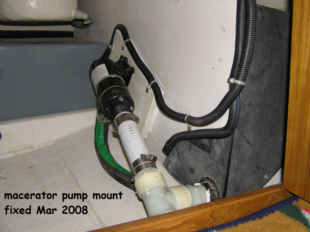

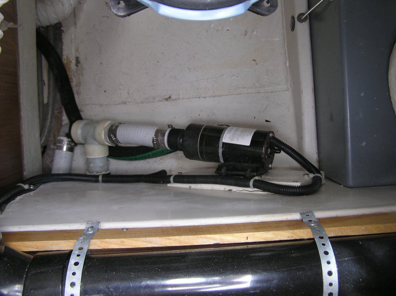

The macerator pump runs but I think the impeller needs replacing. Should I just buy the service kit or is it worth replacing the entire pump and upgrade to the newer run-dry protection model?
$60 kit vs. $120 pump.
I read it’s a good idea to order the stainless steel stud kit as well to replace the stock bronze ones...
23,038
What would have to be changed?
Smitty put one in. I read in his blog. I was too interested in his hurricaneS stories to dig deeper to see if he wrote just that installation up. Knowing him, it most likely fit and/or was "doable."
Peggie's right, check the specs, 'cuz whatever somebody else had on their C310 doesn't mean it's just like yours.
Good luck.
Likes: Alansails
Nov 18, 2010
2,441
Catalina 310 Hingham, MA
Paulj gave you the pics. It was as close to plug and play as you get. The mounting feet are all on the wood plate but not in the same holes as the jabaco. It was a very easy upgrade.
We actually did it well before the hurricanes. But that area got so much salt spray during the storms that most things have failed (solar controller, Blue Sea Breakers, terminal strips, wire, etc.). Our original Raritan was no exception. (Really blame myself, should have washed the entire area down with rubbing alcohol, you learn some stuff going through two cat 5 storms).
So when I had to change it, super quick. And very clean.
