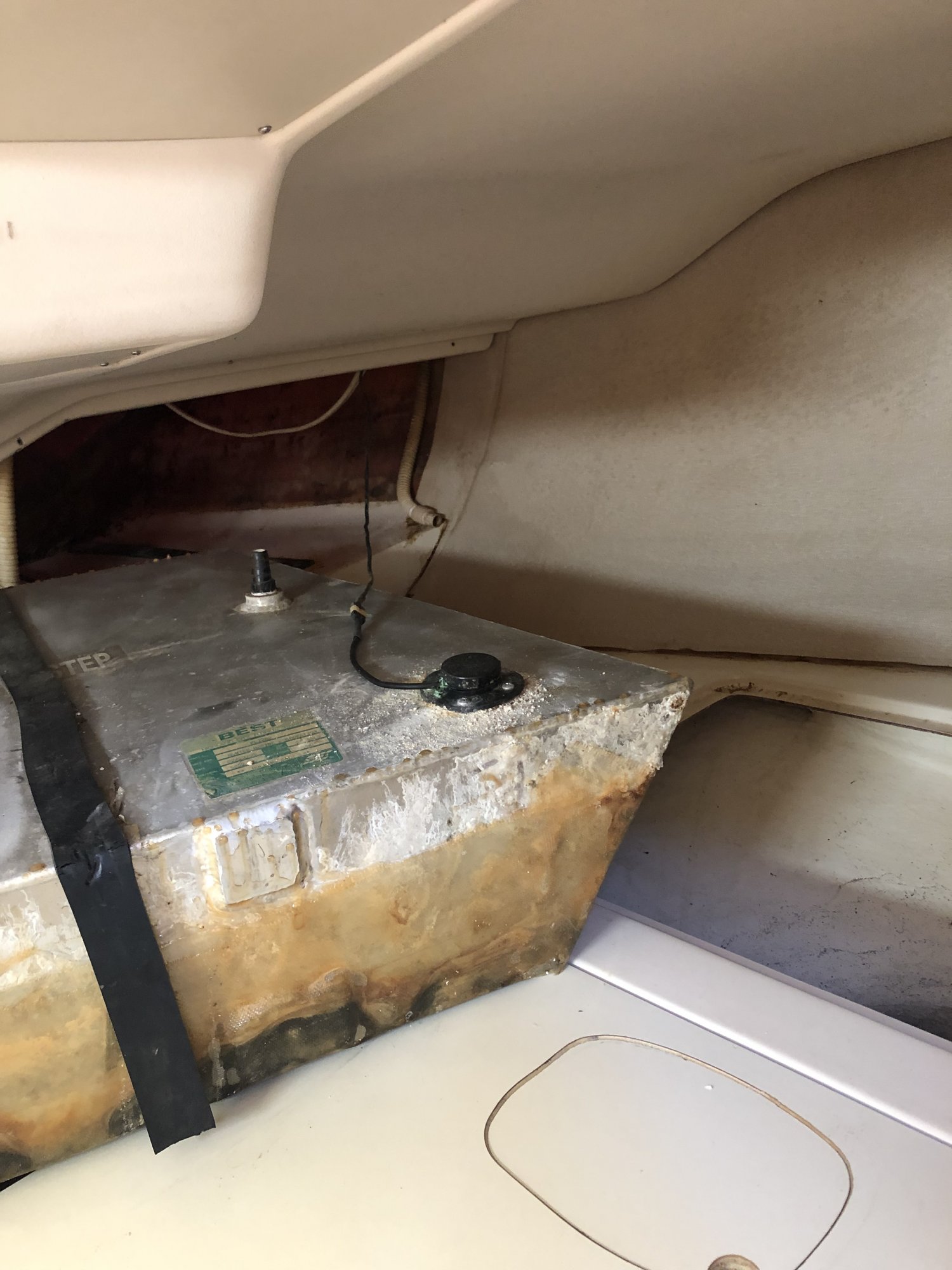

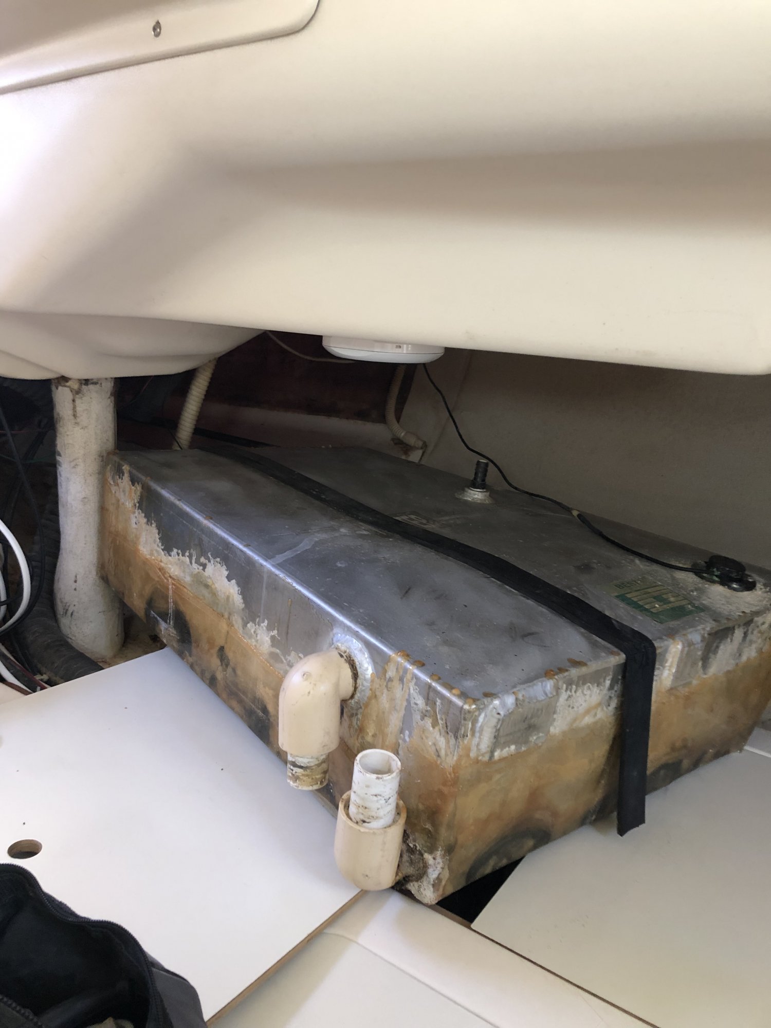

Pulled my tank this evening. Previous owner tried to repair the aluminum tank with fiberglass. If anyone is thinking about it… don’t. Just…..don’t.
Words can’t describe it so here’s a short video.
I’ll be ordering a replacement tank from Ronco tomorrow. Will probably replace all the hoses too since I have everything out in the open.

0hhh..that's BAD!!
I did know someone who'd successfully used JB Weld to repair so many leaks in a 50 gallon aluminum holding tank that there may have been more JB Weld than aluminum left.
I do NOT recommend this!!!

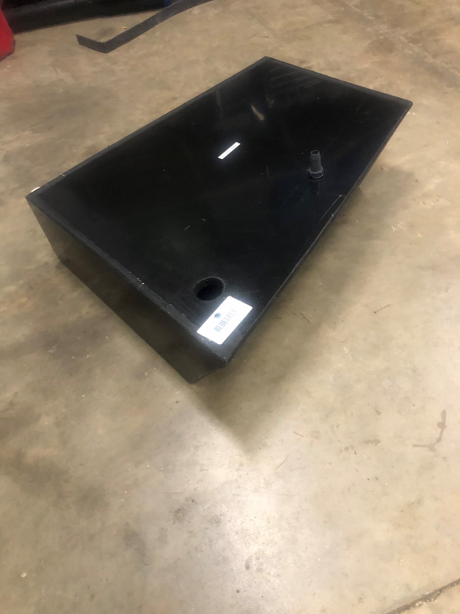

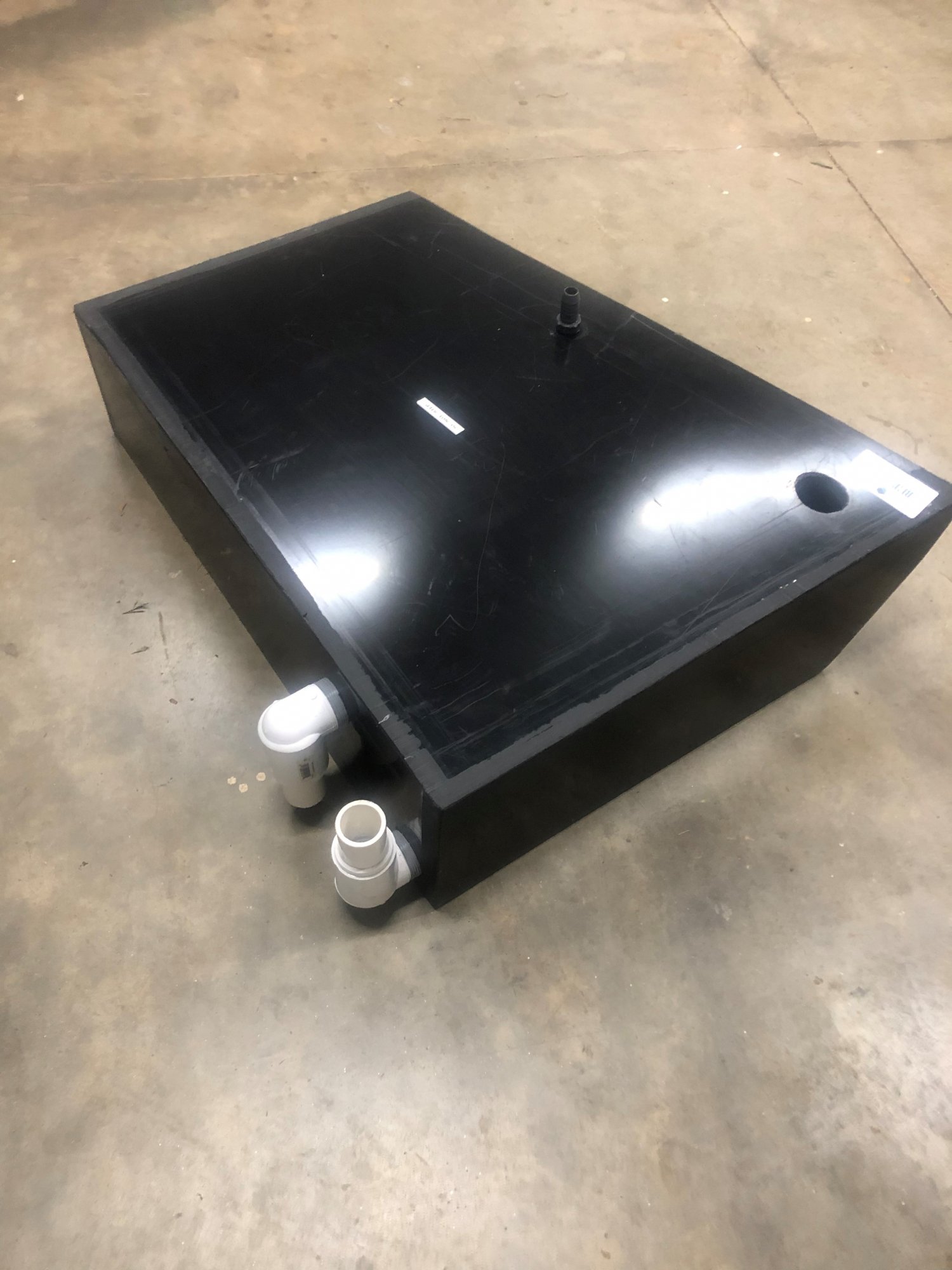

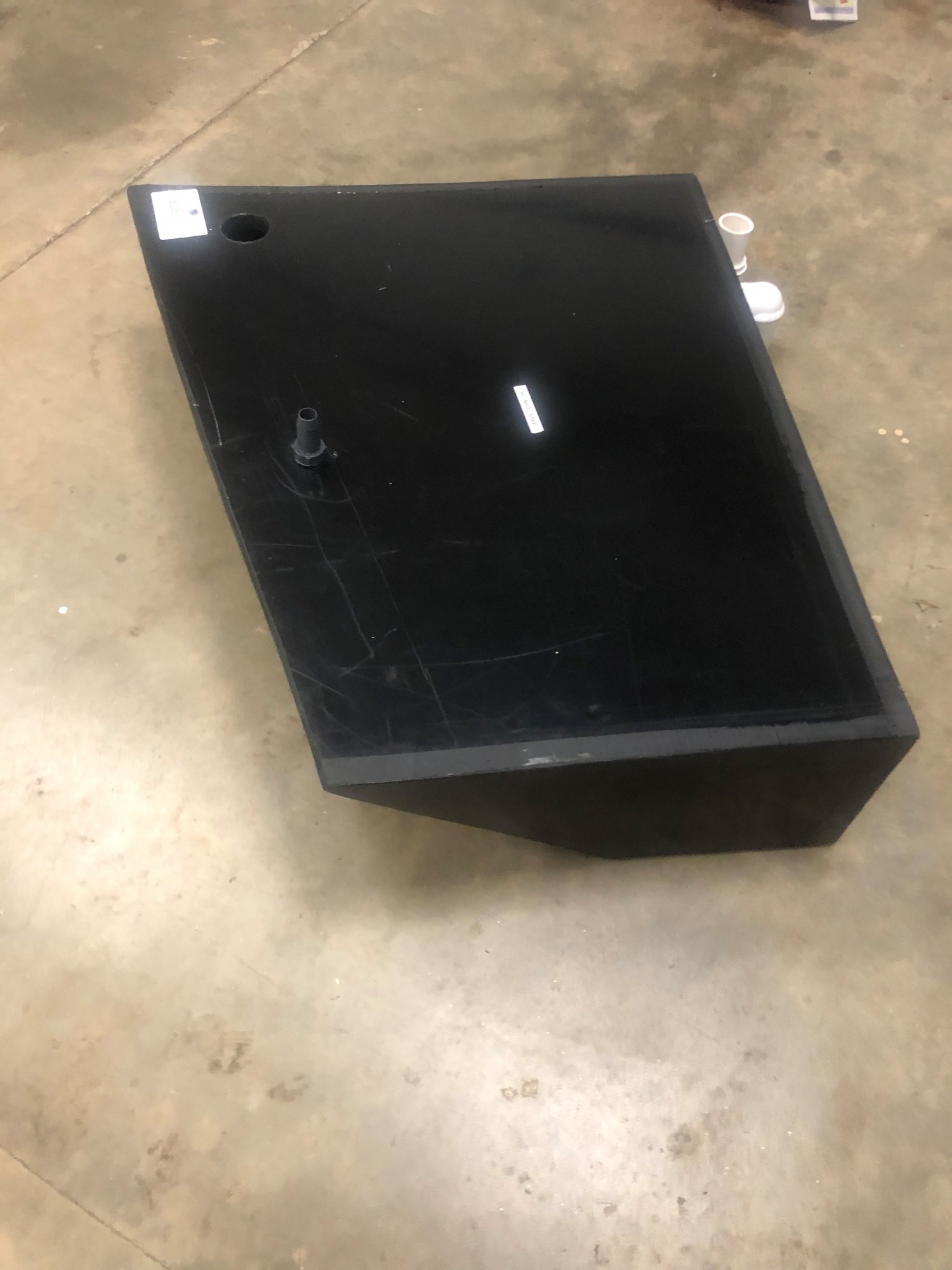

In the meantime, I continued doing my own research and discovered there are other companies who make custom tanks for many different industries, towns/municipalities, fire departments, the RV industry, etc... in addition to marine. I found one such company located about 30-40 miles from me so I called the number on their website and left a message. Within 30 minutes, one of the owners of the company called me back. I explained what I had and she said to send pics, measurements etc., which I did. The next day I received a quote for a polypropylene tank, fabricated to my exact specs. It even included all new fittings. As for cost, it wasn't much higher than any other pre-fab tank of the same capacity. I was fortunate that I could pick it up in person and save a few bucks on shipping. That also gave me the opportunity to thank one of the owners (Michael) in person, and I promised that I'd spread the word.
In short, I would highly recommend "Blue Grey Plastic Fab" in Marshville NC (near Charlotte) if you need to replace your holding tank, fresh water tank, or fuel tank. Here's their website (http://www.bluegreyplasticfab.com/). The owners, Melissa and Michael were very helpful and appreciative for the business.
Will post a few pics of my new tank. Hope to install this weekend!
