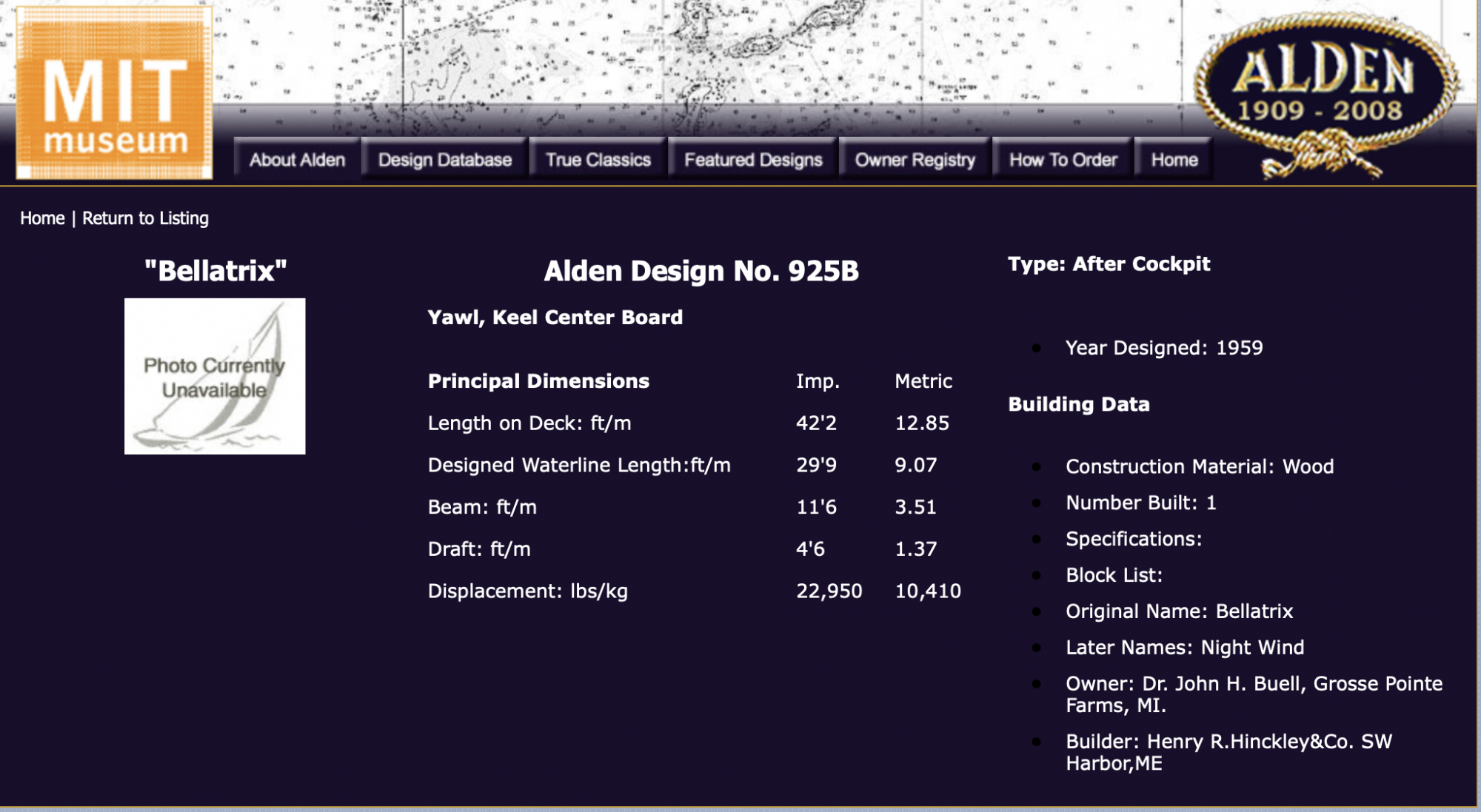

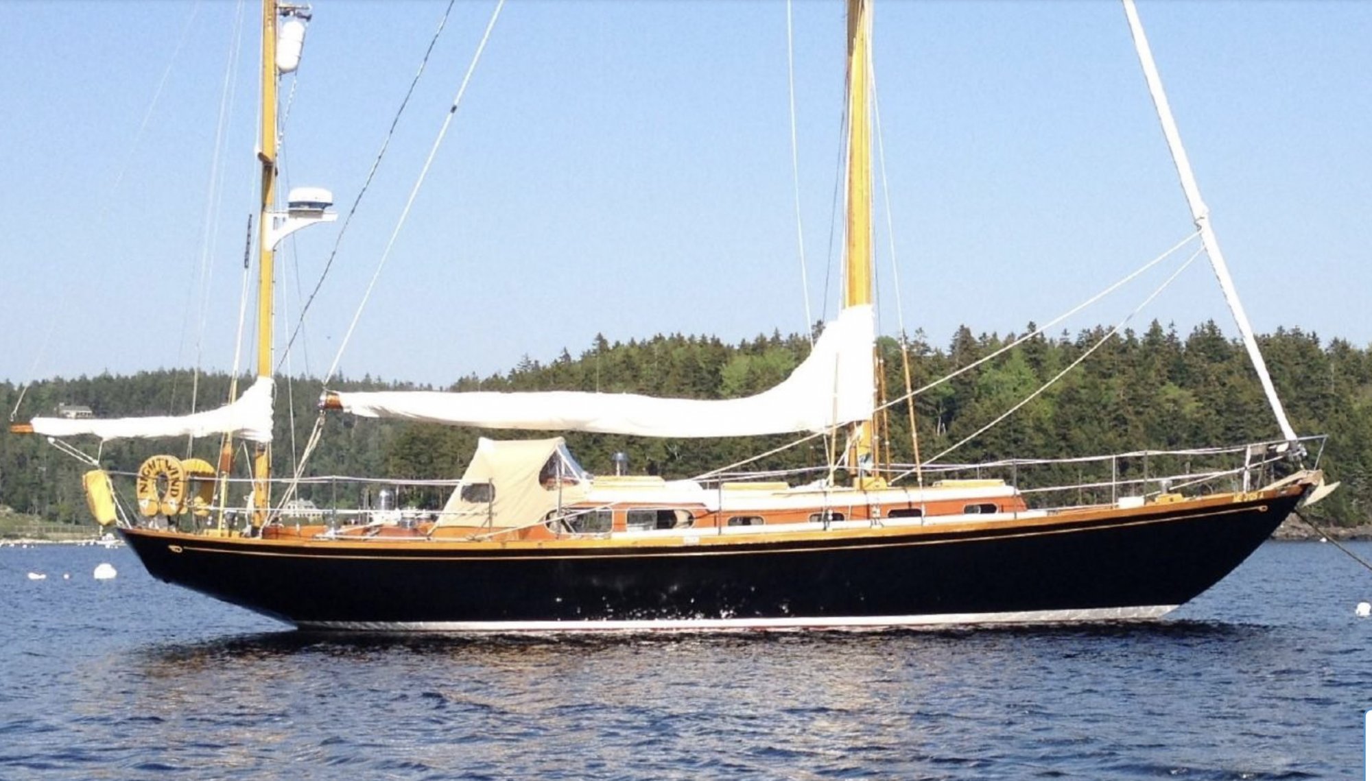

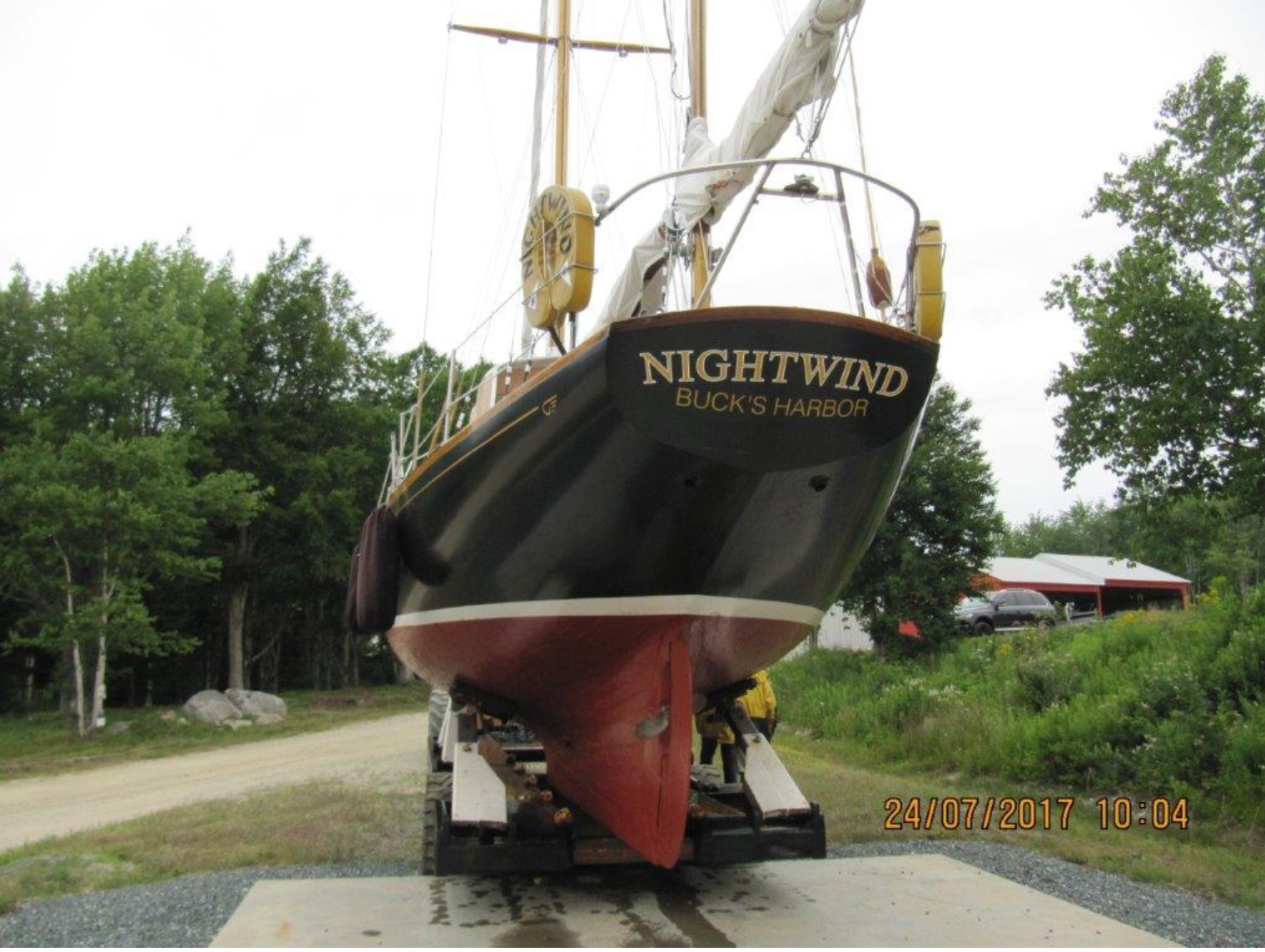

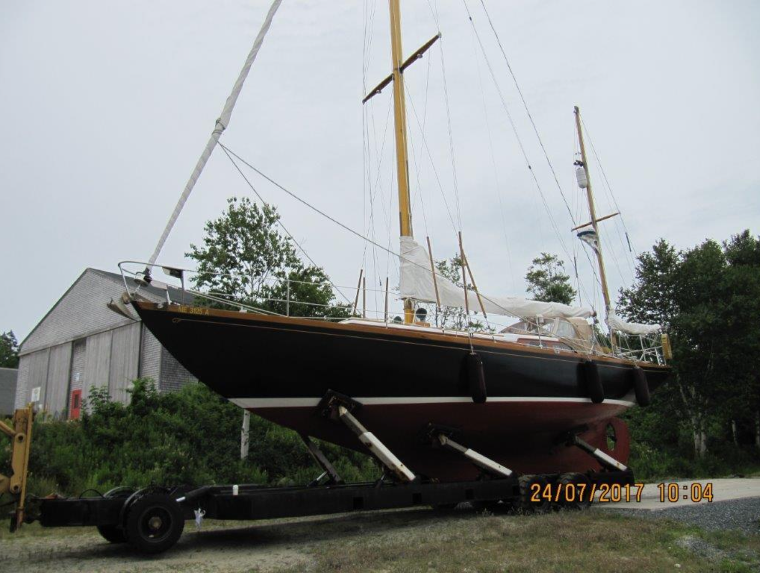

I am currently looking at a 1959 Alden 925B it's a Hinckley Built Wood 42' Yawl that looks a lot like Shanti.
I am hoping to get any info anyone has on this hull, and maybe the boat itself. Original name was Belatrix no named Night Wind.
She has been on the hard for at least three years, has some separation on coach roof where fiberglass over marine plywood. I am seriously considering taking the plunge and joining the wooden boat world. I will not change much to the boat other than making her bristol crisp.
View attachment 208149View attachment 208150

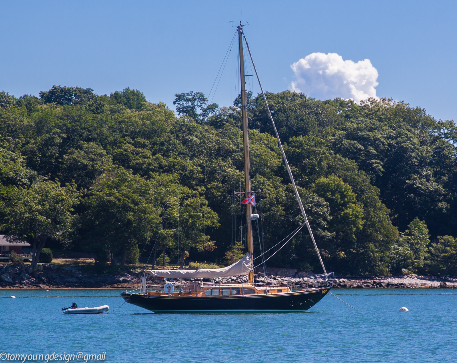

Welcome to the forum, SHANTI is cared for in my harbor, Rockport maine. Different Alden design, I think Shanti was a 1974 build/design. Shanti is also a center boarder but I think (I can’t open the specs) beamier and a more contemporary hull shape.
The condition of the boat, only revealed by an experienced wooden boat surveyor (there are good ones in maine), could advise you as to condition of the boat.

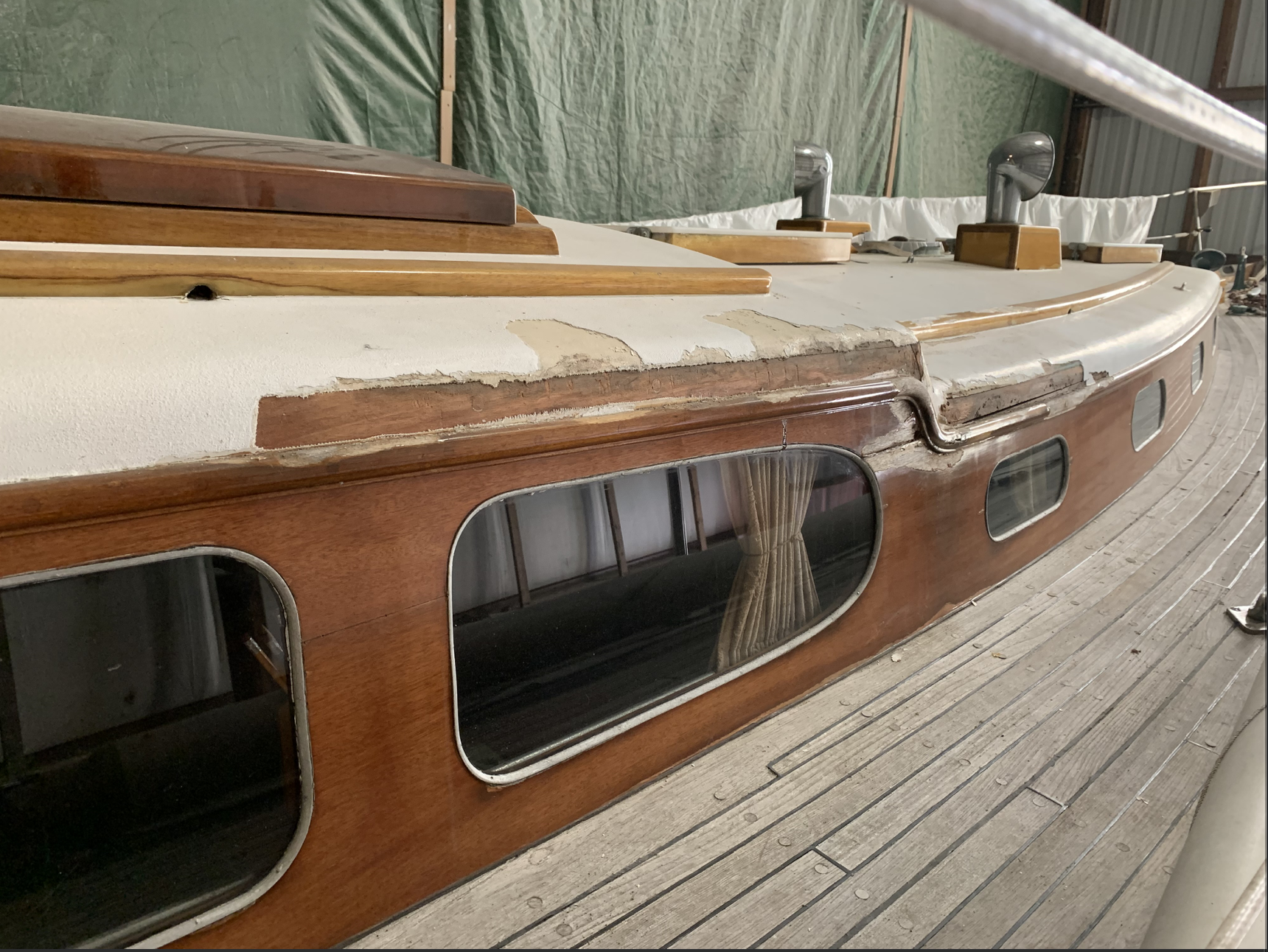

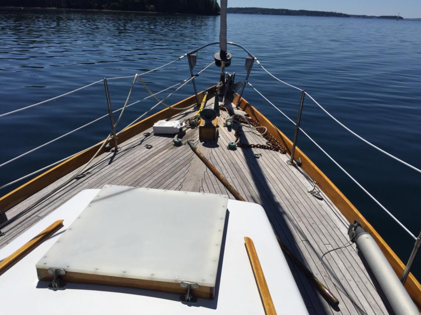

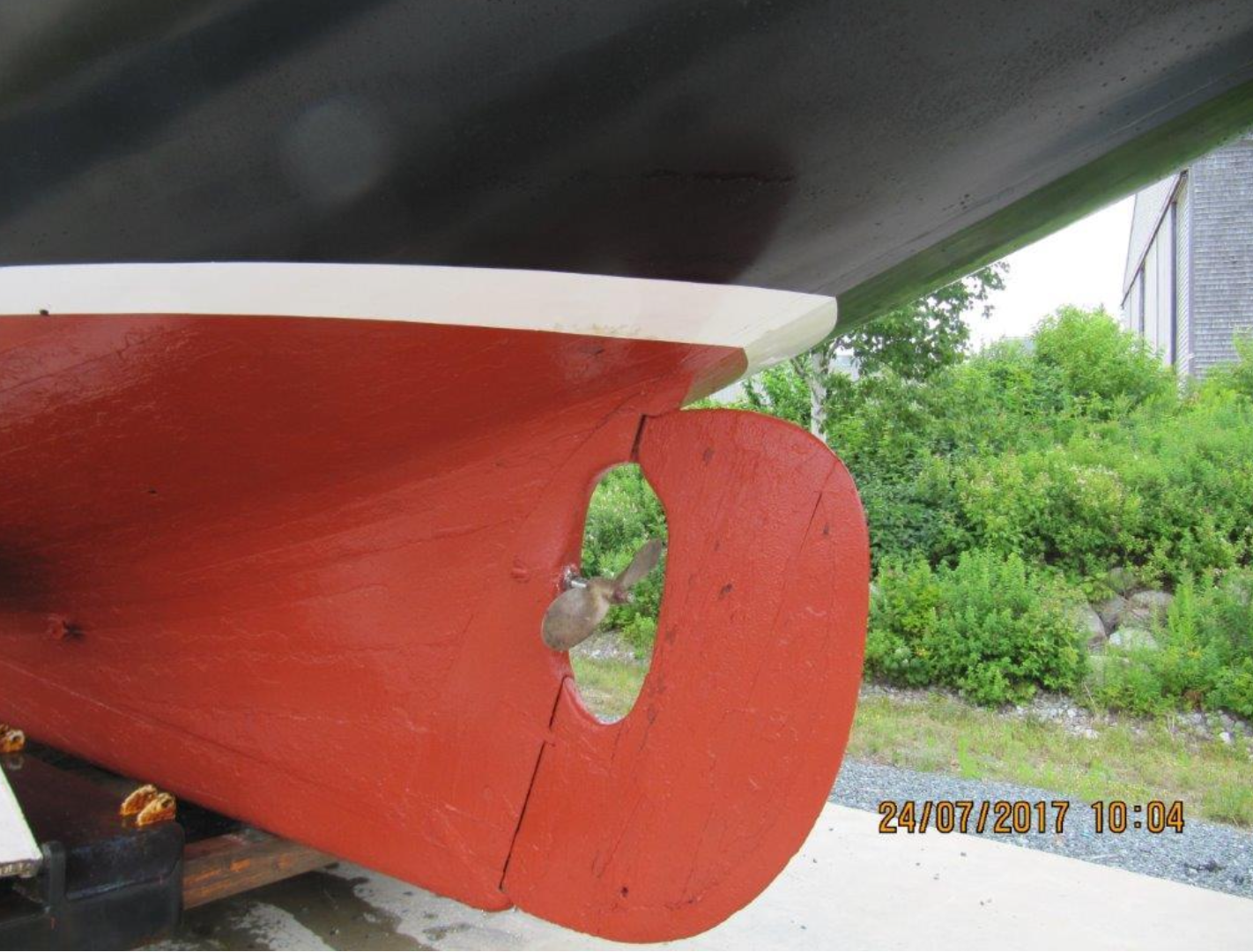

Those pics are 5 years old. What do you see if anything to be concerned about. Survey says that the rudder is FAIR. Hull was solid and that was the worse screw removed 2' below water line below engine.
The next pic I send is the bad thus far

I am far from being a wooden boat expert! I do see some cracks in the rudder that cause me concern. You did say you were into a restoration project - photo above would seem to give you the perfect opportunity to jump in. :beer:

those cracks will close with swelling, non issue.
cabin top fiberglass repair, easy peezy
you want to know about ROT. all repairs are easy, if there is no rot. salt water can retard rot as say fresh water sailing on the lakes.
DRY ROT is always the issue with all wood boats. they all have some. some you can sail with until the season is out, some can be dangerous.
on the hard is tough on wood boats. very hard. the drying out in the winter. the dirt in the air getting into open seams so they do not swell up tight.
the good news is it's in maine. because there are men that know wood boats. you hire them to check every board. rib, plank, keelson, block, ......
then you decidr how much repair you can live with.
i've replaced ribs. made sister ribs, replaced planks, put in the cotton, caulked the seams, ..... and on and on and on.
new wood boats last 10 years. that's right. then they are in a constant state of repair/ rebuild. forever.
that's where you come in. the endless love affair that spurns the upkeep.
watched my dad do it. watched his friends do it. i helped. that parlayed into getting to be trained in the art of sailing at a very young age.
any friend that helps gets unlimited sailboat rides. hence, the making of your crew. to this day i always sail with a crew. this is how yachting was in the day of wood boats.
but here's the deal, and it's HUGE! nothing in the world sails, rides, works through the water, did i say rides, like a wood boat. the flex, they work, the bend, they have a sweet special sound.
.... and they all leak. and a little is just fine

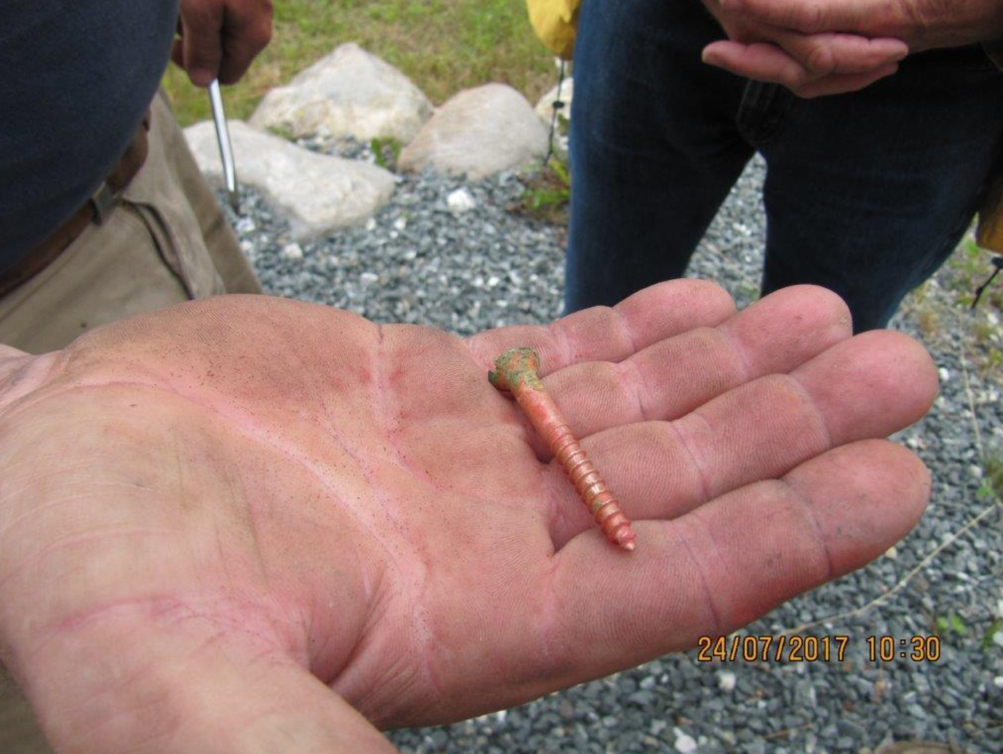

The next pic I send is the bad thus farView attachment 208282
I'm back in the land of broad band. These photos help. I've been by this boat before in the past I think. I remember it was impressive. Wooden rudders, believe it or not (many won't!) are the longest lasting. There are many here mostly on wooden boats (but not all, some early glass designs like mine as well). Worst case scenario is it has to be taken apart and the bronze drifts, bolts and perhaps some of all of the wood replaced. Your's doesn't look like it needs any of that boat a surveyor will be able to tell you in a few minutes of wrestling it with the wheel locked.
The hull sounds good but I'd want to know at what stage between 'just built' and 'really tired' it is in. Meaning, when is it due for an extensive rebuild including some new frames, planking etc. Then you can decide how involved $$ and time-wise with the future care of the boat.
Next the big one would be decks. They look pretty good from the photos but only a surveyor can tell you how many years are left in the material. Could be many (beyond your stewardship), could be serving notice.
The damage above it too bad. The shapely Alden eye brow (the curved trim) covers the rough edge of the fiberglass cloth as it overlaps the house (trunk) side .
Once the fiberglass failed (it can be repaired without redoing the entire house top), water went behind and into the house top and maybe the side plank (hard to tell if the damage is just surface or deeper). The surveyor will give you an opinion if this area could be repaired or if the whole top needs to be re-glassed. Likely a patch could be fitted into the house side if needed.
There's nothing that can't be restored and this boat is no exception. It's just a matter of having an expert tell you what you're getting into.
