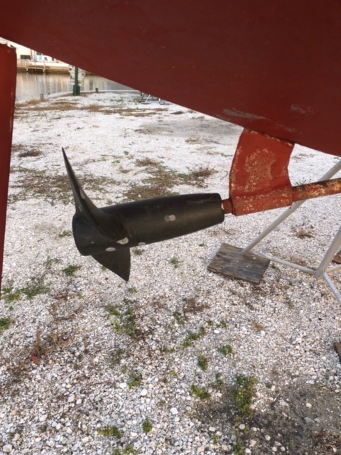

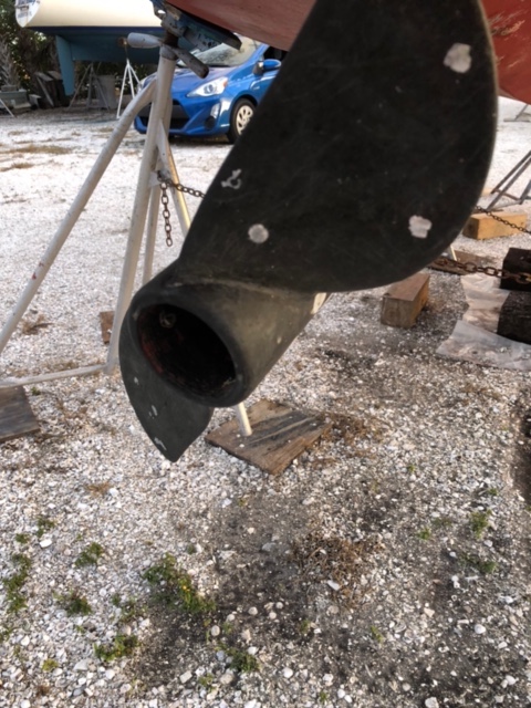

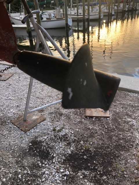

Hi just pulled my boat out for bottom maintenance and hoping to solve a huge problem. Since I've had her when she's underway under a heavy load there is a ton of smoke, fuel discharging. Had injectors checked and they are fine. My propeller is plastic and has an extension that allows it room to turn. I think that is the problem. So, I'm wondering what propellors do you use with a modified engine and no, I can not afford a shaft extension...I'm still wrapping my head around that it's plastic.... I can supply a pic tomorrow if you want to see it.

Can you check and report the size and pitch on the plastic prop ? Pics as well would be nice.

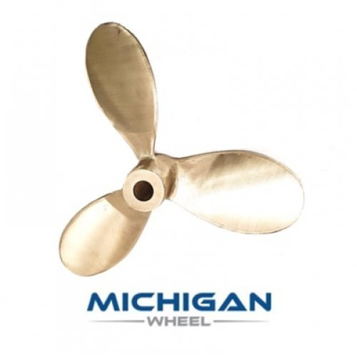

Looking at the two props in the previous post is it clear to see that the Campbell Sailor produced major improvements in my boat handling both under power and sail.
There is reduced noise and vibration while sailing. Under power my boat no longer drops the stern a foot under water. Prop walk has been significantly reduced. The CS prop has improved the thrust and I believe reduced the fuel consumption due to the more efficient thrust.
The design of the Campbell Sailor prop should not be confused with the design of the Michigan Sailor prop.
The CS has a blade curve and blade thickness shape which is designed to reduce cavitation and improve thrust.
The MS is a modification of the big ears used in the Michigan Wheel (the prop that came on my boat). Here is a picture of the MS prop. You can see the similarities to my old Michigan Wheel prop even though the new shape has been updated (improved).

The prop size is determined by the hull length, the design, strut and rudder position as well as the engine size. A bigger engine and or bigger prop doesn't necessarily mean more speed, less prop wash or more control in reverse.
Older Catalina 27s had Atomic 4 engines and a two blade prop much closer to the strut than your plastic prop (probably polyurethane, looks like a CDI Xtendo Prop). Your engine may be different but the hull remains the same.
An efficient prop on someones 'other than Catalina 27 boat' might just make black smoke for you.
The good prop shops can take all your data and tell you what you need but $800 or more dollars might be a bit much for an older Catalina 27.
A possible starting point that may help is get a used, salvaged or borrowed old stock prop and see if it works better than what you have now.
