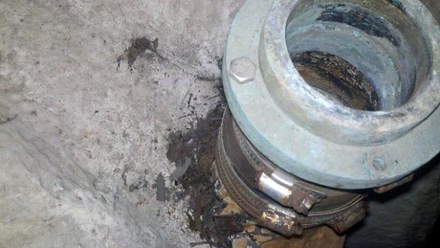

That's exactly what we need Jim. I sure am good at estimating, I said 4". Actually I am going to be at the boat working on the mast today. I always carry my calipers. But I could swear I can see a bronze sleeve in mine(picture).
Rick, about Jim's reference to a Delrin plastic upper bearing. There is a square plastic block, about 1" thick, that sits on that platform where the rudder stock goes through. A collar on the rudder stock rides on that block. In the only pictures I have friend Tom moved the block under the shelf. This is to keep the rudder down because they want to float up and bind on the hull.

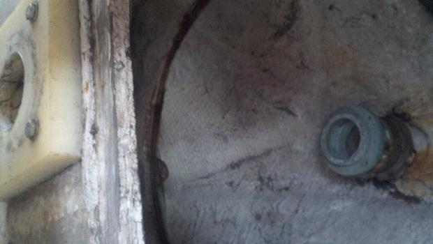

1,090

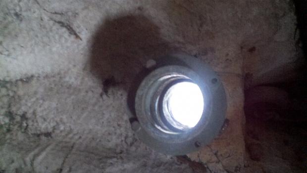

This is what I'm seeing in the inside of the hull and rudder tube... the plastic bearing is above on a shelf in there.
The rudder tube seems solid... it deflects if I put pressure against it.
Comments?

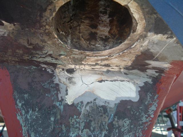

Rick, the rudder tube is fiberglass (and may or may not have some kind of bearing surface on the ID) and was originally solidly glassed into the hull. It may have been damaged when the rudder was lost, looking at the exterior pictures you posted earlier. There should be no flexing - other than the rubber hose that attaches to the bronze stuffing box - as this tube carries most of the rudder's force as well as keeping Davy Jones out of your boat... I'm sure it can be repaired but you will need a rudder or a length of 2 1/2" tube to get everything aligned - the keel to rudder plane and the upper (Delrin) and lower (tube) bearings.
Jun 2, 2004
5,802

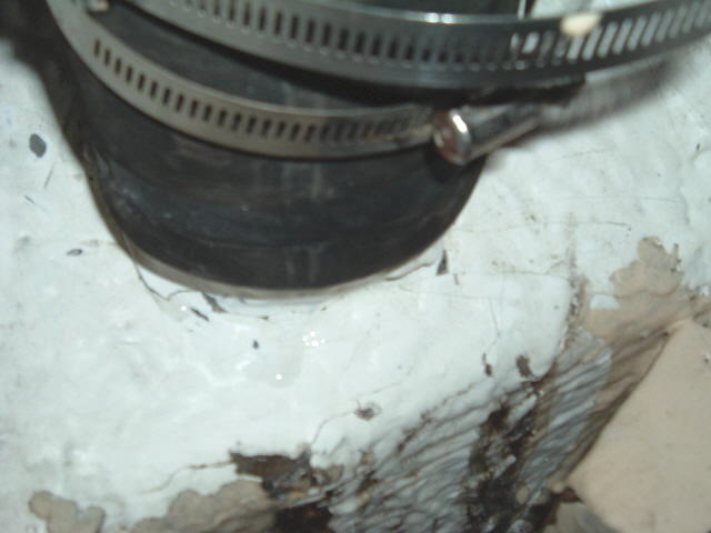

Jim is right. What is deflecting is the rubber hose below that stuffing box, the thing with the bolts in it. It is seen in my pictures above with the loose hose clamps. That part and as far as one can see down the tube looks fine. I think the rudder tube is part of the hull mold. It seems most are all fiberglass including the inside bearing surface. My '79 might have a bronze sleeve. Wish I knew for sure. Here's another picture of that section.

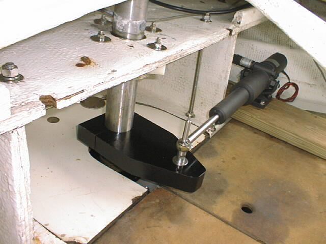

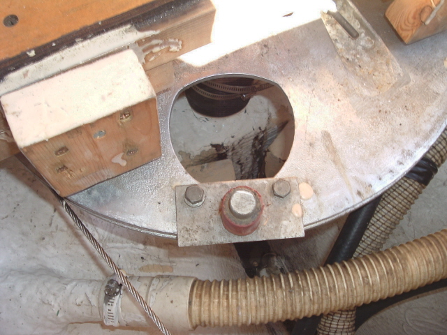

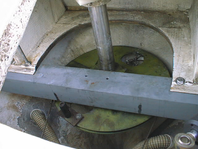

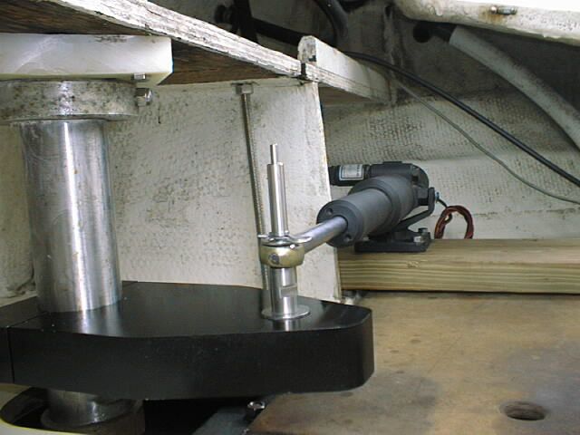

Regarding the rudder stops. If you look at your radial wheel (or the one in my link above) there is a heavy duty pin sticking up. It has a rubber cover. That pin or stud will be centered and forward when the radial wheel is installed properly. The older boats like mine have a cheap pine 2x4 holding up the shelf. Then two pieces of 2x4 screwed to that acting as rudder stops. The radial wheel turns until that pin hits the 2x4. Then you can see on Tom's boat that his shelf support is heavy angle iron. And it has enough depth to act as the rudder stop without anything attached to it. I have had that piece of angle iron in my garage for ten years. :(

Ed, thanks, I also see your delron block and a bearing to ride on it. I assume this steering system is updated or modified. Is it?
Jun 2, 2004
5,802

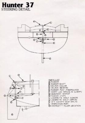

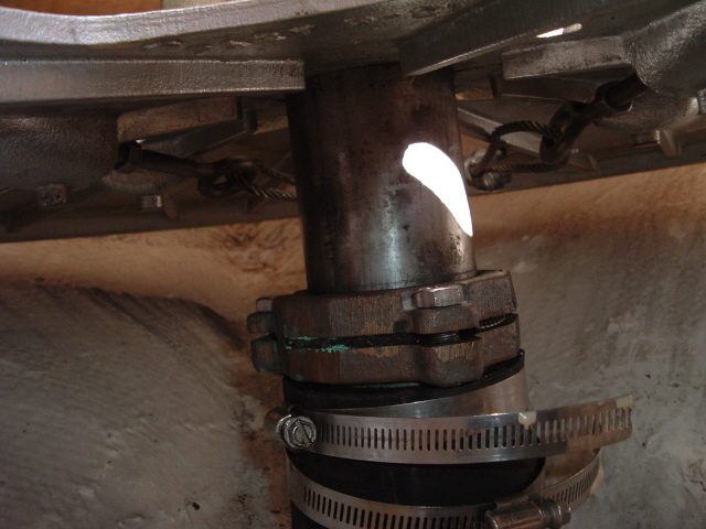

Not sure which picture shows the bearing block. If we start at the top it goes like this. On the coaming, center back, is a screw out inspection plate. The top of the rudder post is under there. It is where you insert the emergency tiller. Next, going down, is an aluminum collar bolted through the post. Under it is the delrin block which sits on a plywood shelf. Then at the lazarette floor level is a plywood cover with a slot for the rudder post. Lift that out and you are looking at the radial wheel. Mine is both clamped around and bolted through the rudder post. Under that is the stuffing box. The bolts, when tightened, squeeze a packing just like the engine shaft stuffing box. Then the hose connecting the stuffing box to the rudder tube, two clamps at top and two more clamps at bottom. Hope that helps.
