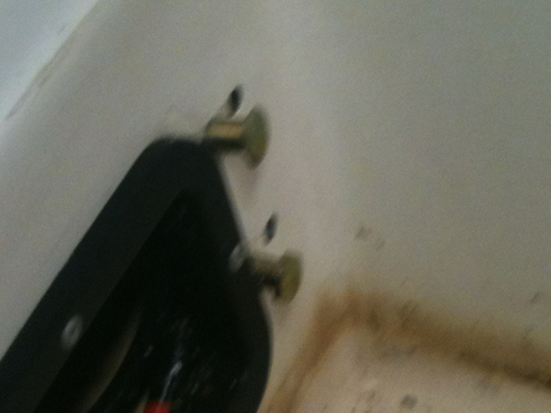

Sep 4, 2012
132
Newport 17 17 Trailer
To most people this means nothing,but to me it keeps the battery out of the cockpit. It's lugs I install for trolley motor. One project down,fifteen to go!
