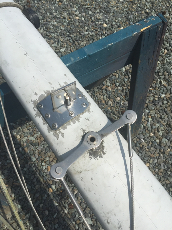

A bit of a wild guess here but grind off one end to release and through bolt it to put back on??? Maybe
10,536
-na -NA Anywhere USA
Generally, there are thru bolts and then pop rivets. On pop rivets, simply figure out the size pop rivet and then drill out with a drill and correct bit. As for the other item on mast where it appears two shrouds are connected to one piece, never saw that but probably a big pop rivet as there is not thru bolt.

Thanks,
It was through bolted. The picture is with the bolt removed. I will check out the pop rivet. It just seem like a big rivet.

Looks like a spacer to me, not a pop rivet. These hold the tangs and the bolt (that I assume you removed) goes through the mast. Kenyon mast I assume.

Actually they call it a Bushing:
http://www.rigrite.com/Spars/Kenyon_Spars/Kenyon_Parts/K_Flange_bushings.html
There should be a bushing on each side of the mast which you should be able to knock out by lightly tapping with a punch or long screwdriver from the opposite side. Corrosion has probably fused the stainless steel and aluminum together so using a product such as PB Blaster could be your best friend. good luck, let us know how it works out.

Blitz, thank you very much. I was just on to that hunch. I have seen the bushings at rig rite. The one thing is that the bushings on each side spin together. I think there may be a compression tube that the bushings are mated to.
It appears I will have to pry these things apart without screwing up the mast.
