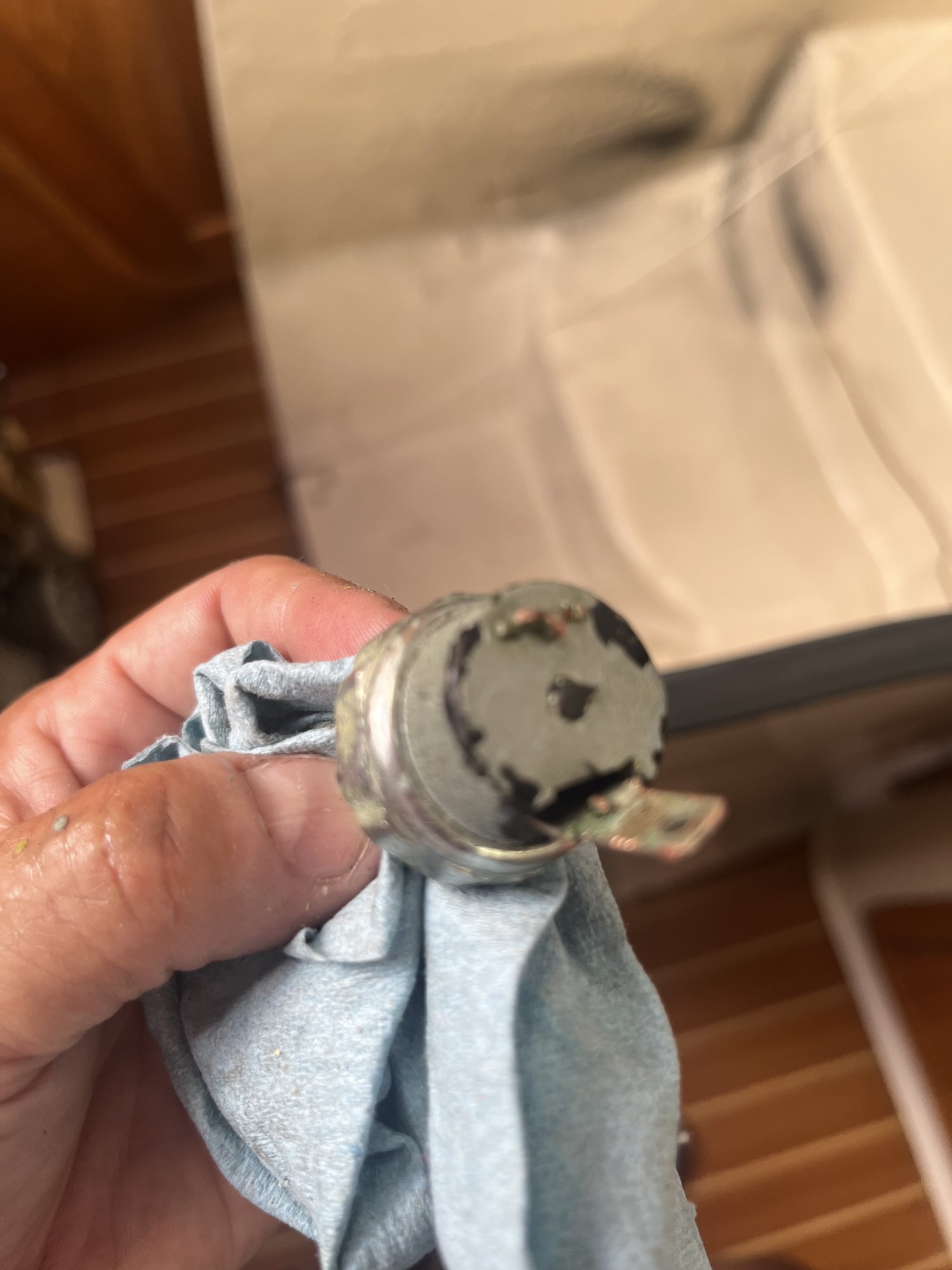

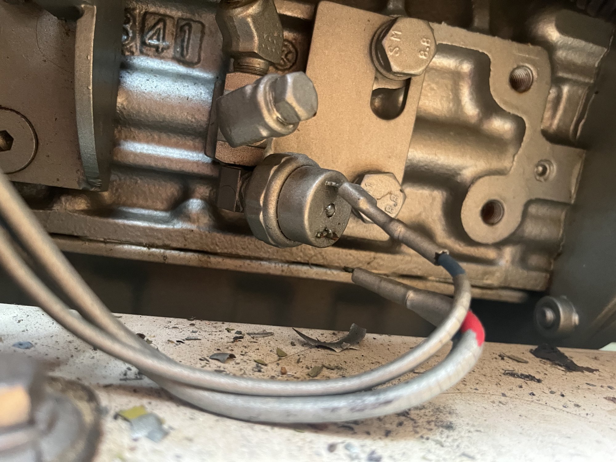

@Ralph Johnstone your assessment was on point! it was an electrical issue. One of the terminals in the Oil Pressure switch is broken. I guess a combination of corrosion and vibration. I did some additional research and I found out that this little switch is one of the "must have" spare parts to keep in toolbox if you own a M25XPB.
This switch was added by Universal as an upgrade for Marine applications, so there is no Kubota part for it. Maybe someone in this forums knows of an equivalent switch from a non-marine application that could be a good fit as well.

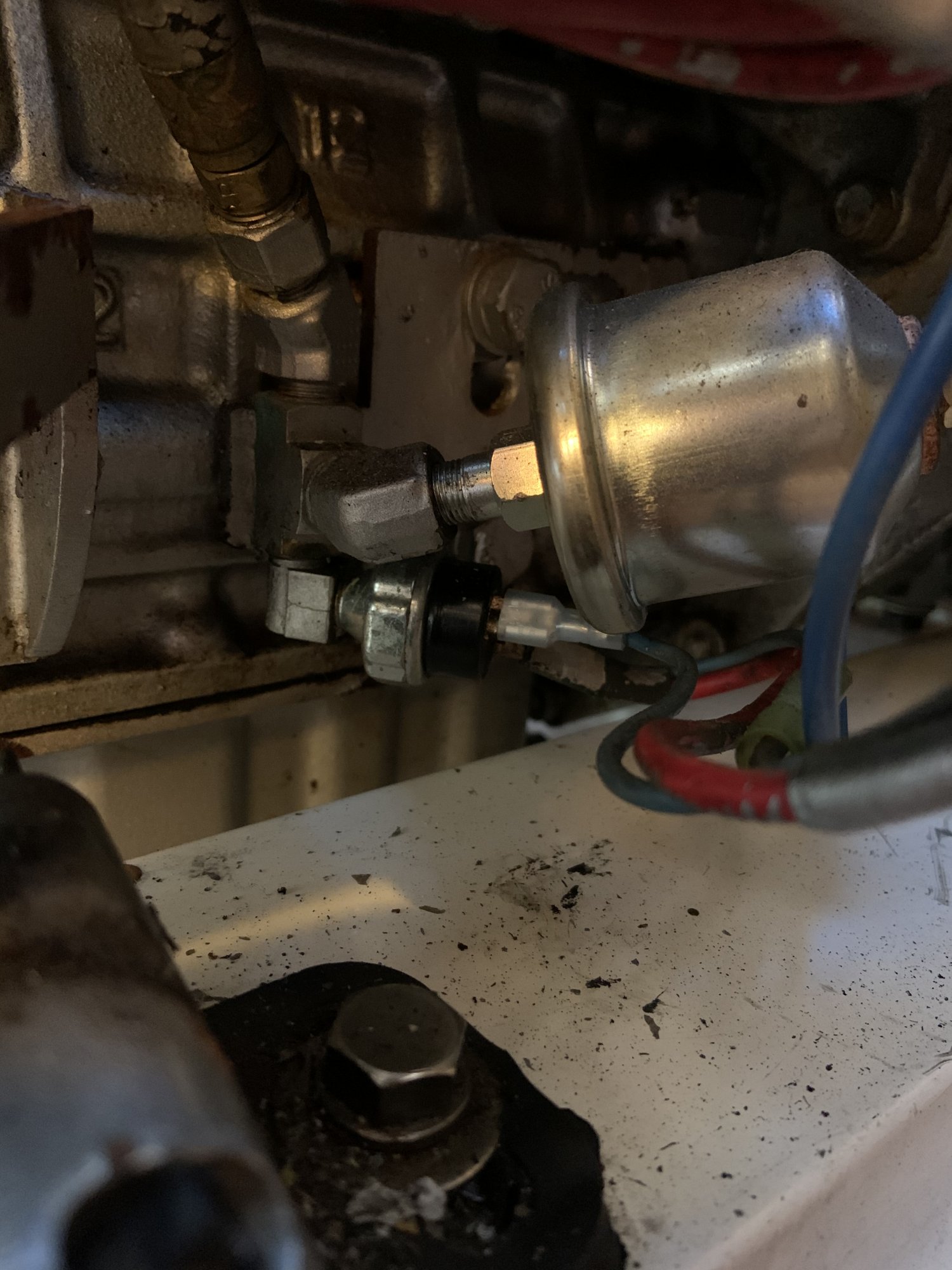

Part number for switch is 037323 (Universal part #). 1/8” NPT fitting. I added a pressure sensor and gauge to our M25XPB; there’s an 1/8” NPT port right there.
