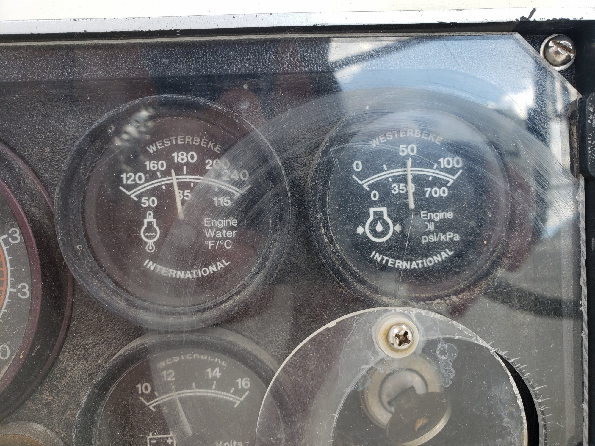

Following up on this. Ran the engine today. It's a Westerbeke 38B-FOUR, based on a four cylinder Mitsubishi engine.
Cold I get 75 or 80 psi at idle.
Hot I get 50 psi at idle.

RoyS
Jun 3, 2012
1,742
Interesting. What was the tach reading?
