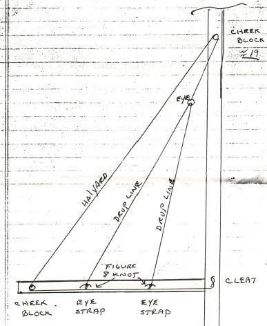

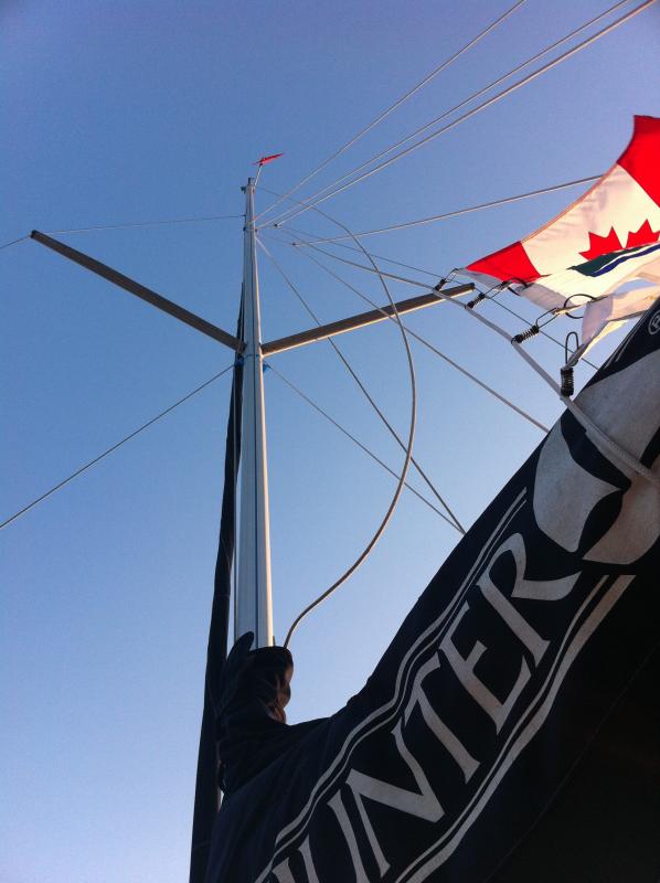

The lazy jacks on my boat (H26) are set up as shown in the diagram and picture attached. I invariably have problems when I raise my fully battened mainsail. The battens tend to snag under the lazy jacks unless I am precisely headed into the wind and even then it will often snag. Currently the high point of the lazy jacks are well above the spreaders and just below the hounds (19' above the goose neck). I'm thinking to lower the high point down to the spreaders which will reduce the angle with respect to the boom and hopefully minimize the interference with the sail battens as the sail is raised.
Should I be able to find a lazy jack configuration that would allow me to raise and lower the mainsail without having to adjust the LJs? The way it is setup now I have to climb up to the foredeck to make adjustments.
Does anyone have any thoughts or recommendations before I start making modifications

In the modification section, a member posted a home made lazy jack system . I installed that system on my 260 this year. It looked too shallow and low on the mast , but works pretty well . It keeps most of the sail above the boom and I can leave it in place when I put the sail cover on . The top of the lazy jack attaches to the spreaders about 10" out from the mast.

Thanks for all the great input! My inclination at the moment is to bring the top point down to the spreaders and move them out about 10" to each side (per Jackdaw suggestion). This should reduce the interference with the battens by reducing the angle and also spreading out the opening. I will also experiment with moving the adjustment aft on the boom so that I can adjust from the cockpit (per dziedzicmj suggestion).
