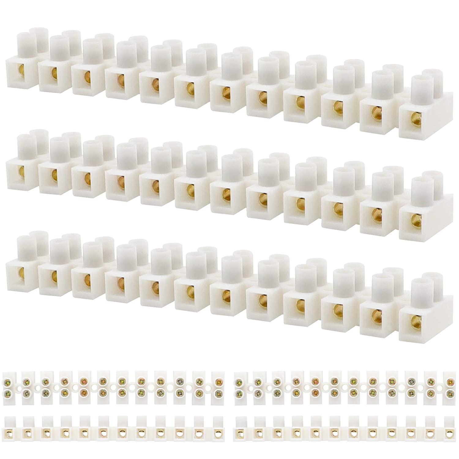

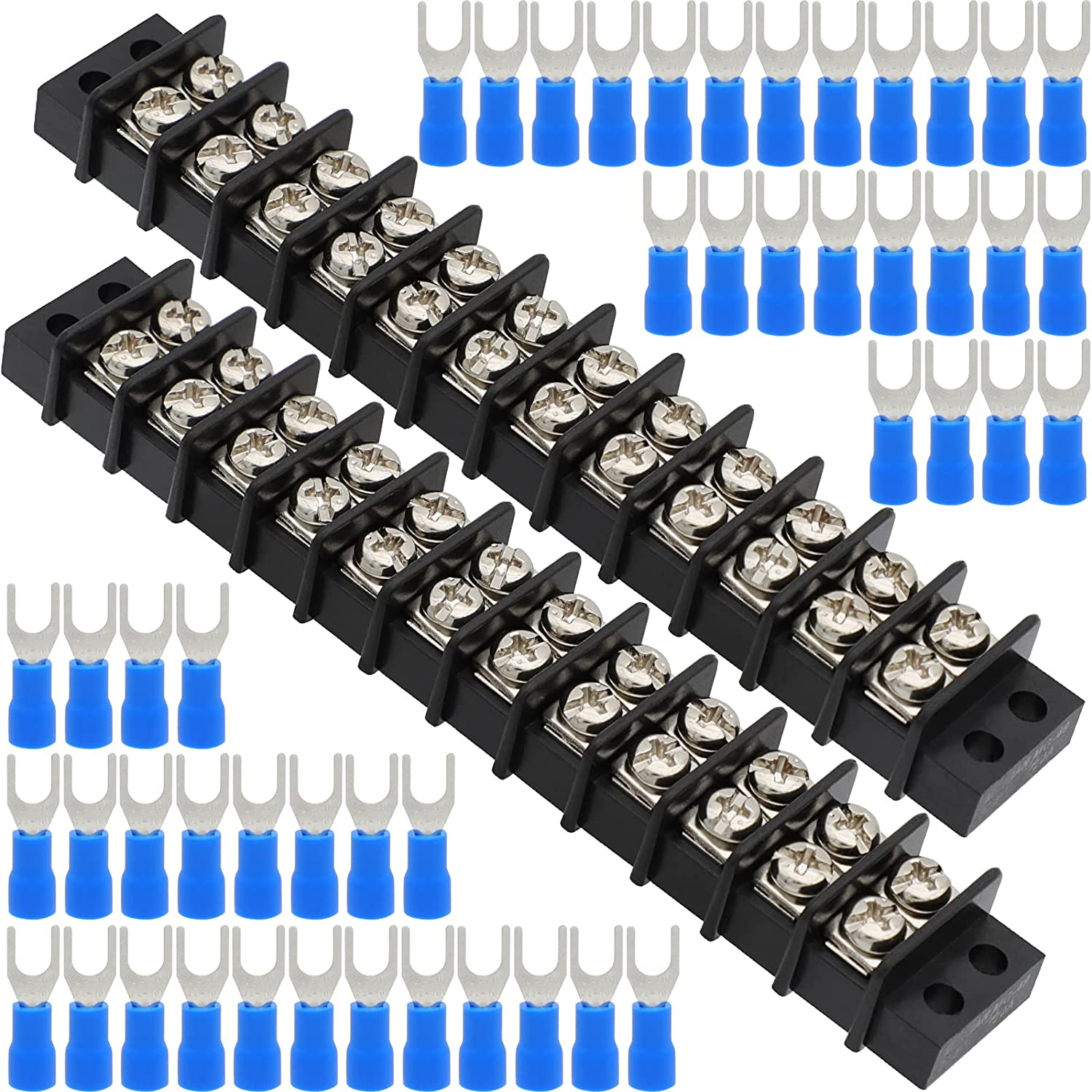

Since one can expect to change out bilge pumps or float switches now and then (usually at the most inconvenient time) I use the connectors pictured below. The white one can easily be cut for as many wires as needed, while the black one should be bought for as many wires as needed. Both should be kept out of the water, but pumps usually have enough wire to do so. If you are wiring in an auto bilge switch, you may need 3 wire spots.

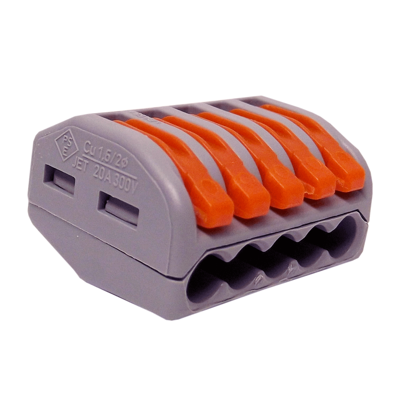

Heat shrink crimp connectors or heat shrink over crimp connectors would be the way to go in areas with water (still best to keep them out of the water). There's a huge difference between regular plier like crimpers and a decent ratchet crimper. I've had good results so far with Klein ratchet crimpers and Ticonn heatshrink connectors from amazon.
However, lever nuts have been my go to as they're easy to use, easy to service in the future and accept a wide range of wire gauges. To mitigate corrosion you can squirt some dielectric grease into the connector before the wires

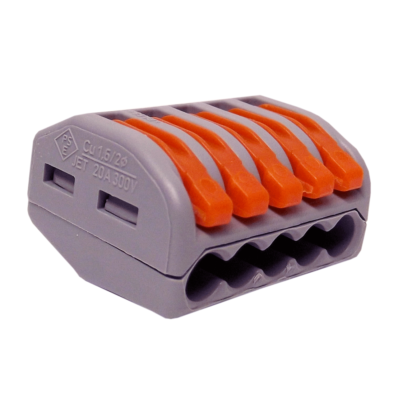

Note the easier reminder to not use crimp connectors on solid wire
