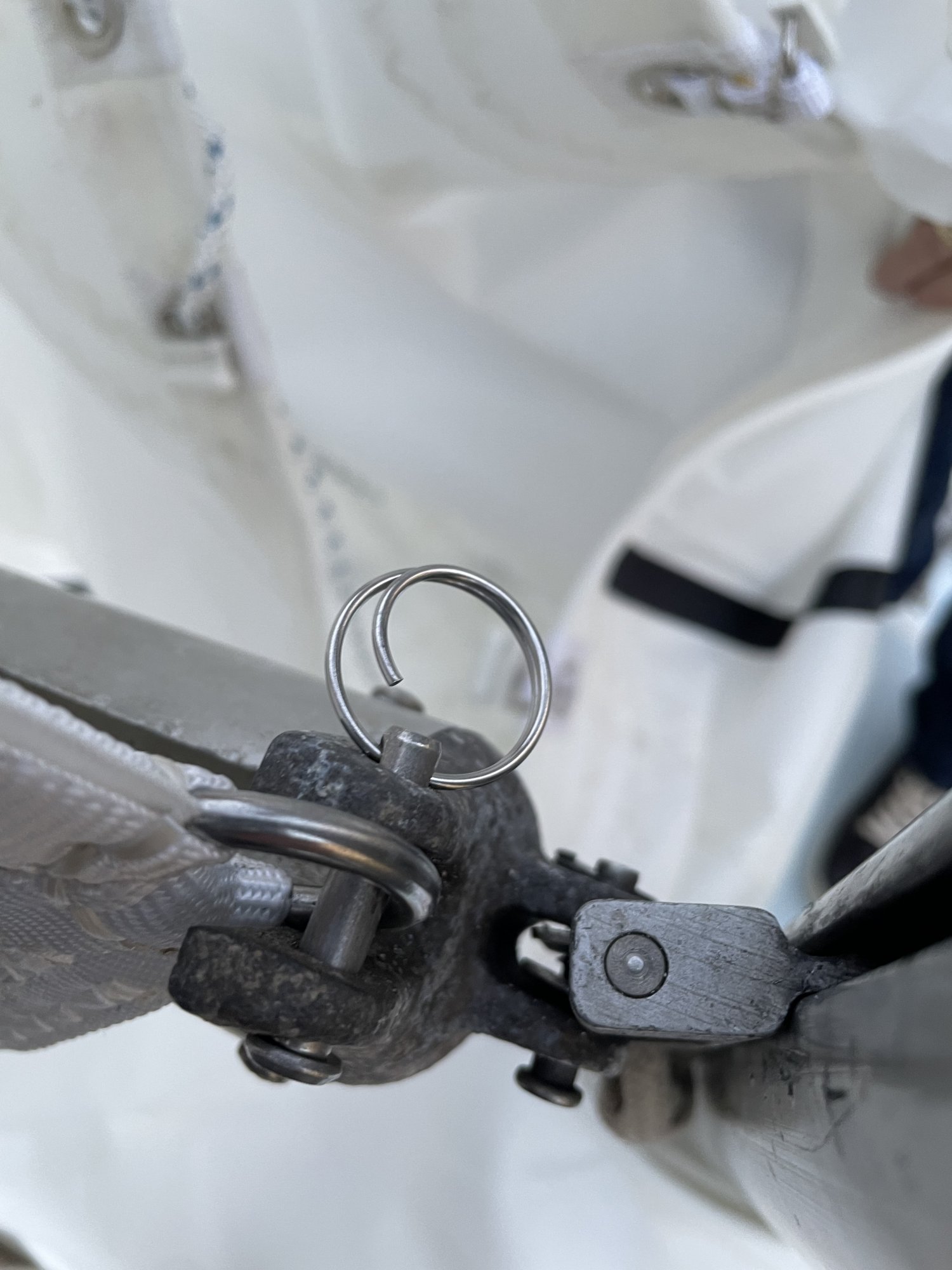

Next: Take that old crusty gooseneck fitting to a place that can "hard coat anodize" it, after you clean and wire brush it well. Then reinstall with a different type of pin or bolt......
7,774
I think OP should replace the boom fitting. Then attach the new sail. If it's a trailer situation, one of those that was original or another variety that are easy to place and remove. If not trailer situation a clevis pin will do nicely. A bolt will do too but I'd avoid a screw.
23,843
I urge the clevis pin. A bolt usually is a tool of convenience or an economic shortcut. It is a temporary substitute and as such works till it fails or is lost to the deep. In my experience it is not the bolt that jumps ship, it is the nut which slips through the fingers. Then the failure process begins. One tried to sail home. Eventually the bolt slips from the fitting and the sail blows. Murphy will arrange for this challenge at the least appropriate time.
A pin is just a better permanent choice.
Likes: kloudie1
7,774
[QUOTE="jssailem, post: 1807406, member: 127717”] ...Eventually the bolt slips from the fitting and the sail blows… [/QUOTE]
Maybe ripping the (New) sail. Fix it , man. Fix it.
23,843
@NOLA looking at the condition of the SS pin, fractured near the last threads, and the rust on the other side of the goose neck there is a possibility the metal of the pin has exceeded it’s life expectancy. Replacement would be my goto action. Good on you for addressing this issue.
It would be easier in my thinking to remove the gooseneck and do the work on a bench. You may be able to save the gooseneck, on the other hand the corrosion that has occurred may have compromised the gooseneck. Getting the sail free will permit further inspection.

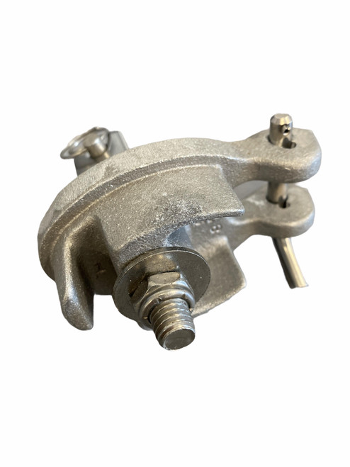

If you decide to replace it, Dwyer still sells that end cap for the goose neck

My '83 cat22 has that setup. A clevis pin will hold the sail in place but the long "tang" is to hook the grommet when reefing. You'll need to rig an alternate way of holding the grommet in place when reefing..

Update - after brushing, application of PB blaster and a few whacks with the rubber mallet, we did get the tack pin to turn and it was threaded on the opposite end. Unfortunately, a portion of the scre remains stuck in the oppisite eye. Will go back with a drill in a few days. Instead of resinstalling thia same type of tack pin, I will probably just install a bolt. Will post again when done in case anyone is curious. Also here is a pic of the portion of the pin we were able to extract.
That's the standard Catalina pin. Heat the fitting as you use an ez out to extract the remaining part. Repairs vary from a bolt to a pin as recommended. If you use a bolt (that what I have) I recommend that you thread a wing nut on it up to the bolt head to make a nice handle. The bolt / pin should go hand tight and then pack 1/4 turn. It should be easily removed for reefing, sail changes, etc. It should be checked occasionally for binding and be replaced / lubed if needed. Same goes for your rivets and things on your end cap. That boom looks like it has seen some substantial salt spray so other components may need a little TLC as well.

My '83 cat22 has that setup. A clevis pin will hold the sail in place but the long "tang" is to hook the grommet when reefing. ..
One of these would work
just run the Cleven spin through the hole and the hook will be ready at the tabernacle when you need it for the reef tack (grommet).
Google mainsail reef hook and you’ll get many options
