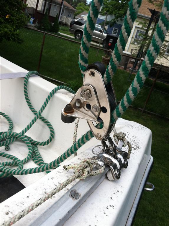

Photo 1 & 2 - Main sheet boom to traveler.

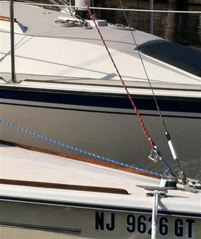

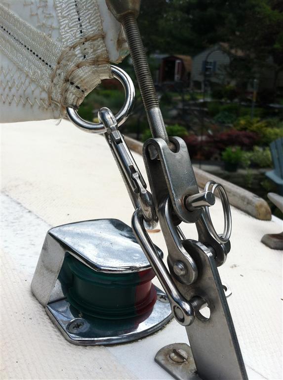

Photo 3 - Forestay before I installed the downhaul.

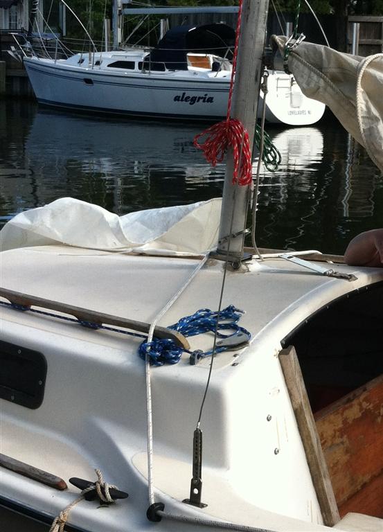

Photo 4 - Jib halyard (red) and downhaul (blue). Block (pulley) connects to long shackle which is connected to bottom hole of chain plate. You raise the jib using the red line and pull it down using the blue line.

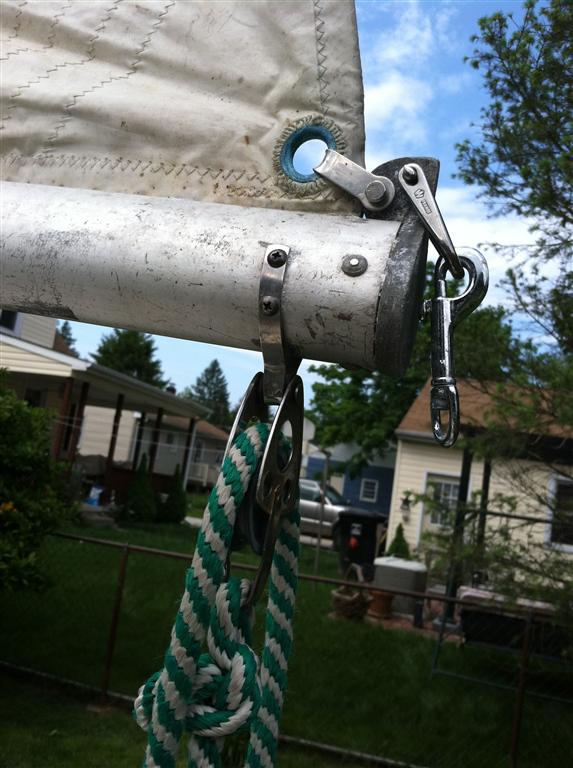

Photo 5 - Blue downhaul goes through fairlead to jam cleat. White jib sheets go through side fairlead back to cleat. Note shroud connection (side stay). Note photos are with old main sail.
Note on the rear traveler. While you can adjust it side to side I found it much easier to leave it tightly cleated to center.
