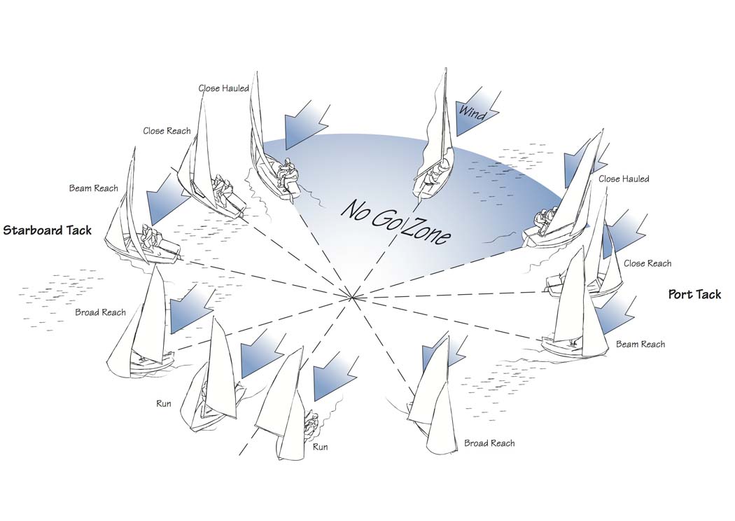

Welcome. At the most basic level, the angle you set the sails must be adjusted to match the course and relative direction of the wind.
You can get the general idea from this. Note the sail setup for each point of sail relative to the wind. If you were trying to sail in the "no go zone", that could be your problem. If you were sailing a course roughly parallel to other sailboats, and your sails were roughly set to similar trim, there are a myriad of reasons why they might have been faster. Does your boat have sails that are crisp and in good shape, or do the feel like grandpa's handkerchief? Are they all wrinkly when you are trying to sail or smooth and tight like an airplane wing. What sails are the boats you are matched against flying and what relative size are they? A longer boat with more sail area, or just a bigger boat might be considerably faster. A catamaran or trimaran would typically be much faster. You need to learn what speed to expect from your boat in certain conditions.
The question you ask, is sort of like "what is love?"; or "what is the meaning of life?" The answer to why another boat might be faster is difficult to determine without a ton of additional information. Until we have a lot more information on your boat, sails, wind conditions, and the boats you were comparing yours to, we can only guess. One distinct possibility is the other boat may have been motor-sailing...
