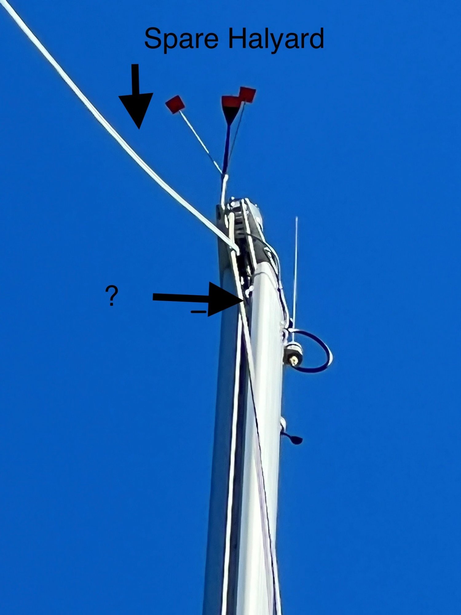

We had the mast taken off this past winter, this is how they ran the rigging this spring. Last year the line in (?) was ran down to the end of the boom, then along sid and cleated off at the front of the boom. Now they have taken the spare halyard and ran it to the end of the boom. Our questions, the (?) line is fixed at the top of the mast, what is this lines purpose? How are other Hunter 45DS Selden Furler Masts rigged, I have looked over the guides, on the internet and cannot find an answer. The boat yard says it was improperly rigged last year. If anyone can share pictures or a diagram, I would so appreciate it. We also have issues with our main sheet at the back of the boom if anyone can share a picture of that as well. Thanking you in advance for any help/advice you may offer.

My guess is that line with the arrow is the topping lift, especially if it's attached to the end of the mast crane. If so it should be attached to the aft end of the boom (probably through a sheave) so it can be used to support the boom when the main is furled. You can see that the spare halyard would then not wrap around that line. I'd suggest the yard that rigged it as shown is incorrect. Where does that line go to now?

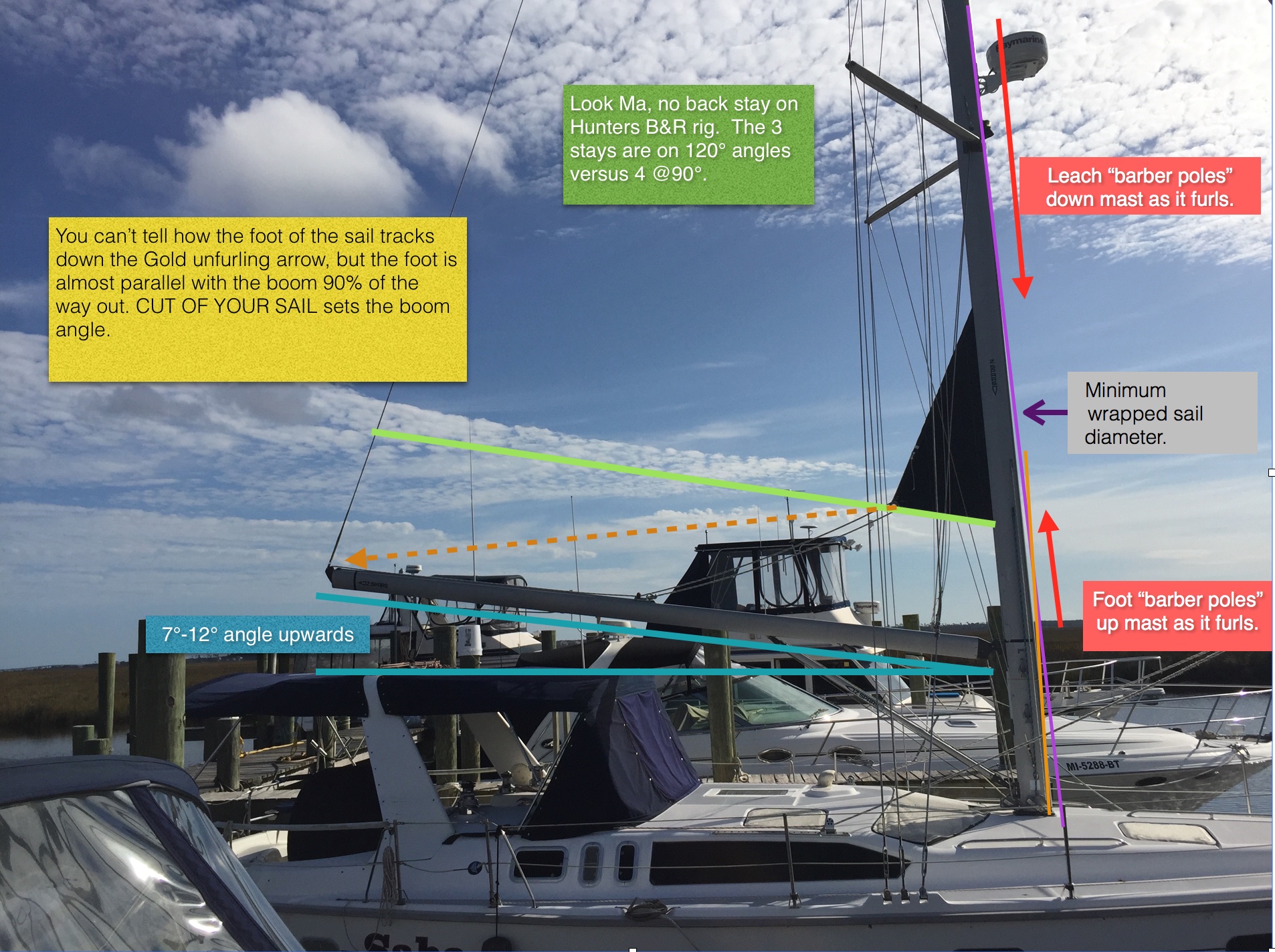

This picture may help.
The Halyard is inside the mast on a swivel. The tension on the Halyard is key to proper fulling operations.
The Topping lift is for the Boom. That excess line is tied off on the mast.
Simple to pull on the Topping Line to figure out which.
They should not Cross each other
Jim...

On our H41DS, the topping lift (aka spare halyard) enters the mast above the main halyard. It looks to me like yours was rigged with the main halyard and the topping lift swapped.

Originally the topping lift was attached to the end of the boom and ran back outside the boom and cleated off at the front. The topping lift line is "now" cleated off at the bottom of the mast. I know its wrong its just a matter of having more eyes on it and confirming. The topping lift has become a useless line, its only purpose now that it hangs so far off the crane is to slap the top of the mast in wind.
No.
It is key to your In- Mast Furling operation.;)
Look at the picture in my Post #3 above, please.

The Boom LIFT line is used during In-Mast furling, to maintain boom angle for the cut of your main sail.
Note: This is not a Halyard.
The Boom VANG is used to adjust your main sail.
Please read this entire thread that discusses the mechanism.
In mast 'piece of crap' furling system
Jim...

Thank you everyone for your help. We are taking the boat back to the yard and they are going to remove the line from the crane.
