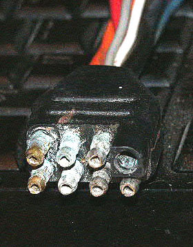

Aha! A picture is worth all the words. Someone else said, "stock means different things to different year models", and that is very good advice.
On my M-18, the wiring is connected directly to the control panel, with no interim "trailer" connectors. I guess Bristol recognized the inferior integrity of such a setup, and eliminated it, or Universal made a change after mine was built in 1984. The wiring is (was, before I replaced a couple of them) original, for it still had mfg tags, engine room paint, etc on it, and there's no sign of alteration.
When Stu said, "connectors", I thought he meant the connectors on the rear of the panel and at the engine.

Melting was only one of the problems. Corroded, high resistance connections were and are a huge issue as my picture shows.
