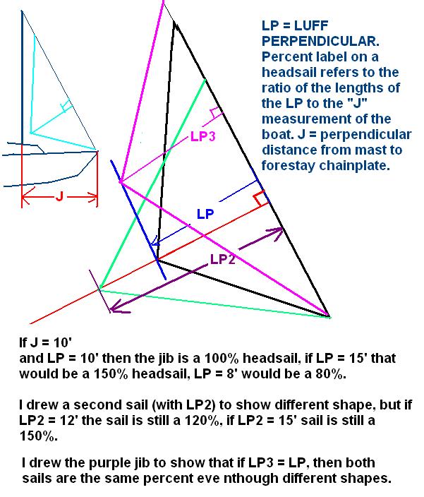

Much depends on what you need and just based on the make and size of your boat would limit your responses, significantly. For example, folks could help if they knew the basic I J P E dimensions of your boat to help know sail size. For jibs, do you have roller furling or hank on? You should also know and provide these type of dimensions in the sketch below, too. Foot, luff, leech and LP
Help us to help you, please.
