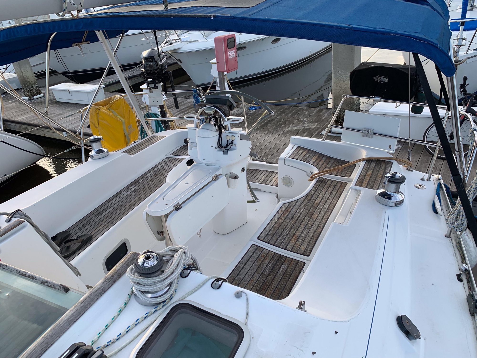

How about a Bene 393? Long cockpit, should hold 6 people, 2 in perch seats, and the helmsman. Every body else sits on the high-side rail.
