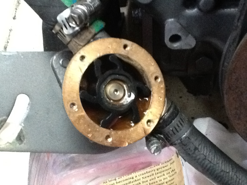

So I went out to the boat this morning (on the hard) to change the impeller. Watched some videos, thought I had it figured out. On my Yanmar 2GM20, you have to take me water pump off of the engine mount to get to the back side...all went smooth, got the cover off, took a photo so I knew how to reinstall the impeller vanes....
But I cannot get the impeller off of the shaft and out of the housing. Is there a trick for this? I see the key way, but I assume the impeller just slips off of the shaft...
But no go.
I brought the housing assembly home to work on it....but have just managed to break all of the rubber vanes off of the impeller...
Any help or thoughts?

I have a 2GM20F and your impeller/pump is different from mine. Yes, The easy thing is to disconnect the pump. The difference in mine is the the impeller has a crosswise dowel the sits in a notch in the pump shaft. Also, my pump cover has an O ring seal, and no gasket. I can grab the cross shaft with a long needlenose and pull the impeller right out. Whole job takes 15 minutes.
I had always heard that there were two different pump versions on the 2GM20, one on the Euro version and one on the Japanese version. I guess your photo proves it.

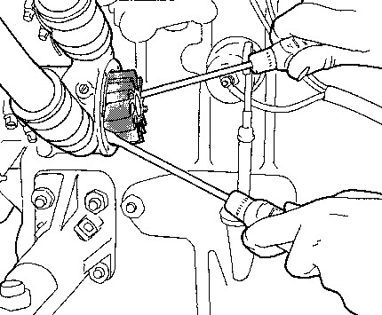

Don't panic, this is a common problem with raw water pumps. I have the same engine and have had this problem a number of times. I usually take the pump home and put it in a vise to hold it securely. I put a pair of pliers on each side of the impeller and grab a vane and pull very hard. It helps to squirt a bit of liquid soap on the shaft first to loosen things up. If all else fails, beg, borrow or buy an impeller puller. FYI, here is how Don Casey deals with the issue:
http://www.boatus.com/boattech/casey/replacing-impeller.asp
When you get the old impeller out and the new one in (a whole other story and technique) don't worry which way the vanes face -- it just doesn't matter.

Should I think $100 for an impeller puller is a bit much? Elegant.
Screw driver/ice pick technique. Not so elegant. Thanx to Milberg.

The puller the describe is simple like a miniature crowbar that you use to wedge against the side of the rubber of the impeller while using the pump face as the lever point. Put some liquid soap on it inside the shaft and use a small screwdriver as a crowbar. Also get hold with needle nose pliers of a vane, possibly use two pliers and pull out while twisting it on the shaft. Mine doesn't look exactly like your (3GMF30), as the shaft has a straight bar that goes across.
Once you complete this exercise, I recommend you look up Speed Seal Life on the Internet and get one of their kits. It also comes with a removal tool that works. They recommend white lithium grease be applied when installing and it should assist you in future removals and replacement. It will simplify future changes. You should check your impeller at least annually and if the slightest bit worn where the blades attach to the center, replace it.
Hi Doug....funny thing is that the PO had several spares on the boat. The first one I pulled out was as you described...with the center dowel (and an oring in the kit). I could not figure out how that was going to go back in..opened the 2nd spare, and viola...it was different...with the key way....
I finally got it...I think your design is a whole lot easier to pull out. But maybe mine was neglected..I will pull it out more frequently now that I know how it comes apart.
