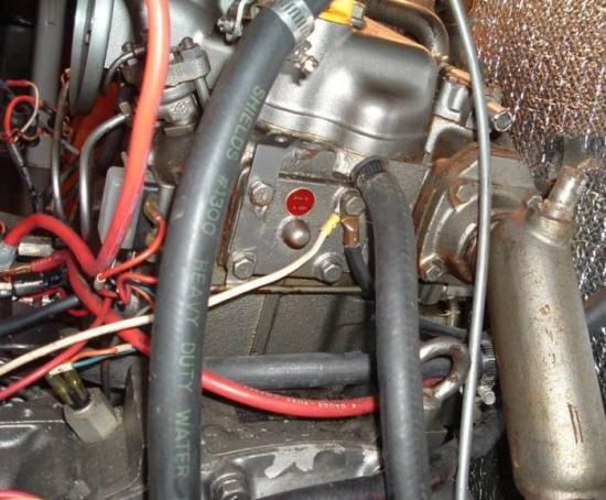

Andrew, here is a link to my original H37C wiring diagram( http://hunter.sailboatowners.com/in...&cat_id=38&aid=6732&page=article&mn=37-cutter ). The wire from "Engine" to switch actually comes from the starter. The #10 wire to the panel comes off that same starter post. The alternator red wire output goes to that same starter post(OK so I oversimplifed in my first post).
The differences on my boat: I also have a Freedom 20. There is a ground and a heavy black wire goes to one of the house batteries. The 110AC comes out of the Freedom 20 as a heavy white 3-wire that goes to your panel Main AC switch. I have four batteries in parallel as the house bank off of the Red #2. Then I have a battery cominber that connects between the single starter battery and one of the house batteries(answer to your question #3).
In the picture you see the heavy #4 black wire on the back of the engine. That is the ground to all five batteries. The white #10 wire is the ground wire to the electrical panel. Then you cannot quite make out the back of the starter. But you can see the two heavy #4 red wires. One goes around to starboard and up to the battery switch. The other is from the alternator.

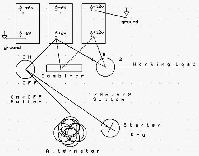

To much time before Christmas - Battery Diagram
My boat's charging wiring diagram is displayed below. It is very similar to what Ed has. The only change is a separate on/off switch that connects the alternator and starter key to the battery system. There are two 6 volt house batteries and one starter battery connected by a combiner to equalize charging. The advantage of the separate switch is that it must be on to start the engine and it connects the alternator directly to the battery system.
