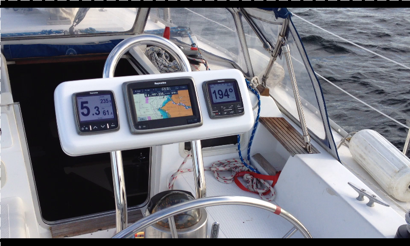

Which Raymarine GPS/sonar model did you get? loaded with coastal nav? transducer included?
Jul 1, 2014
262
Hunter 34 Seattle
I got the a78 with Navonics Gold and wireless. http://www.anchorexpress.com/Raymar...T-100-Navionics-North-America-Gold-T70203-NAG It's a lot more expensive than the Garmin unit you found that seems to have similar functions. I could have saved some money without the wireless or sonar or with different maps. I thought perhaps I'd like to have the wireless (it's basically just a mirror screen on an ipad, might come in handy) and wasn't sure about the difference between maps so I opted on the high side. I think more information is always good so the sonar will be useful when I get around to making it work. The touch screen is a nice feature, I really like being able to zoom and drag the map across the screen with my finger.
I should add this started off just needing to replace the speed transducer paddlewheel but I decided instead to replace the old equipment with a new i70 multifunction unit that was bundled with a speed/depth/temp transducer and a wind transducer. Then decided to add the GPS at which point I thought it would be really nice to replace the old autopilot with one that could talk to the GPS. In any case, as I said installing the GPS was the best thing I've done for the boat.
