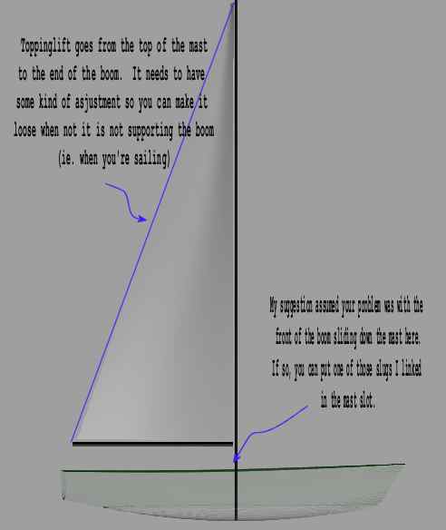

My Boom attaches to the mast with a triangle type of hardware. It slides into the mass like the main sail. I see photographs of other peoples CP16s and they have their main sail down resting on the boom. Whenever I let the main sail down, the boom goes down (to the companion way) with the sail. Is there something I am missing, a part or is this how it is suppose to be. I would like to be able to let the main sail drape over the boom when it is down and still have the boom off the deck and out of the way? Any help appreciated.
