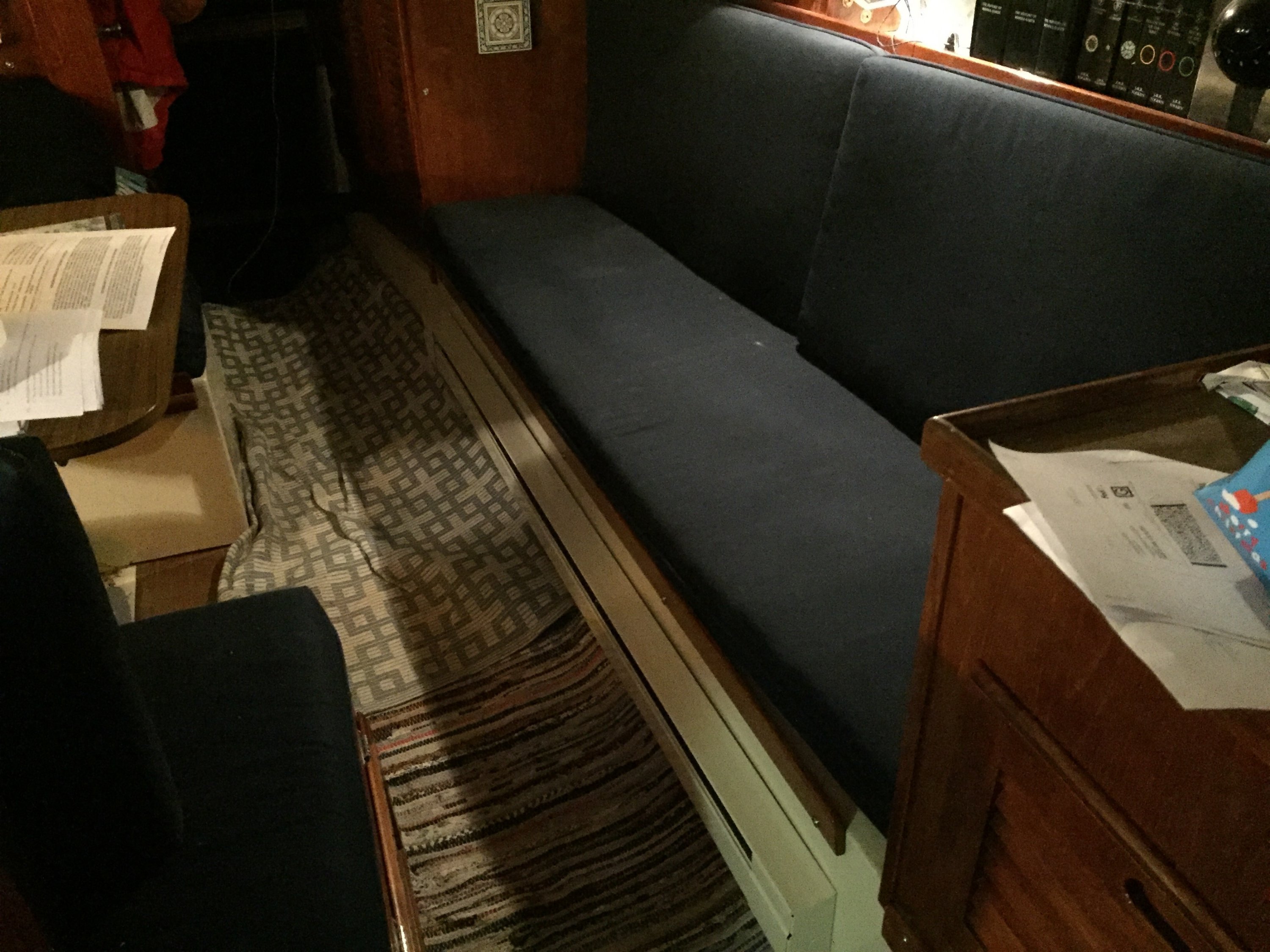

After a while, I've been using a lasko convection heater which had fantastic heat but didn't last too long and is too big to mount anywhere. I have been using the little west marine electric fan heater with good results but the air movement and sound and thermostat bouncing is not quite as nice as a good convection heater.
So I just ordered the cadet 36" electric baseboard and thermostat and will be installing that where it gets here. It's fairly cheap but looks like a good unit, so figures crossed.

In the meantime since I don't have $1000 for the heater I bought a cadet 72" 1500W electric baseboard with a nice Honeywell digital thermostat. Unobtrusive along the floor and really nice heat. We'all see how that goes.

Report: cadet 72" 1500W heater is a total slam dunk. Very comfortable heat, cheap, safe, and nearly invisible.

Two years later and this heater has been absolutely fantastic. I added a digital thermostat with a programmed schedule and never have to think about it.
