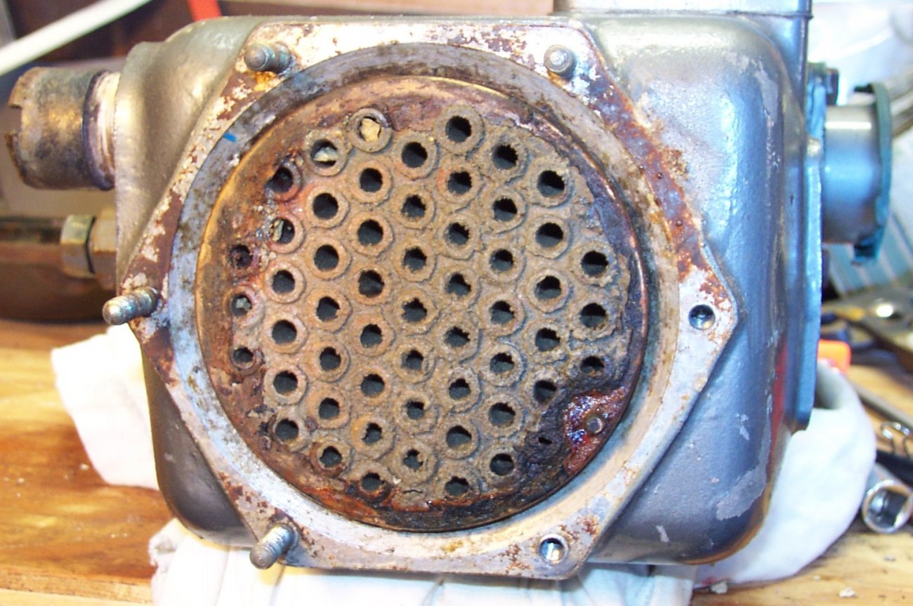

That's what I did when I bought my C30. The HX zinc was completely gone and I was replacing all engine hoses anyway so I pulled it. The tubes were mostly clogged. Radiator shop reamed them out, cooked the HX, pressure tested and painted it.

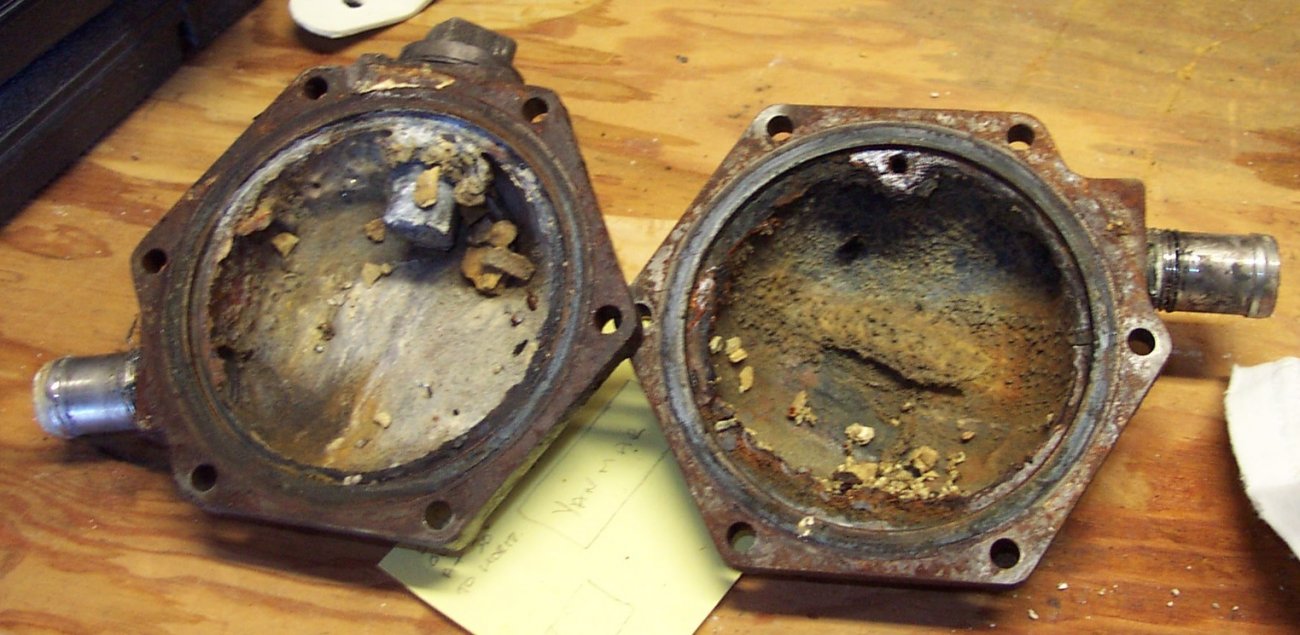

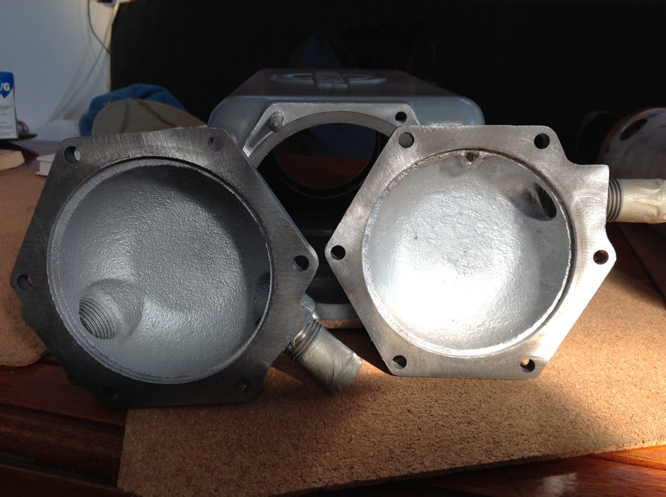

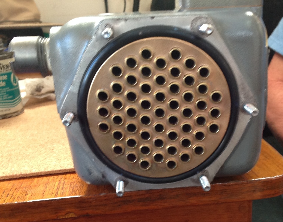

Aye to the radiator shop. For $170 they not only cleaned it but resurfaced the sealing surfaces and painted the outside. Before and after pictures attached.
I also recommend replacing the hoses, cleaning out the exhaust manifold (if applicable) and examining the mixing elbow, strainer and water pump. In other words bring the whole sea water system up to par, you will then get about a 5 year holiday from problems in that system.
Some before and after pictures attached.

That will make you a believer in the possibilities of the "Radiator Shop". :plus:

If my Heat Exchanger looked like the before I would for sure to the shop but my
3YM30 is 2007 and looked like new and really runs very cool and take ends caps off every year
just to keep a eye on things.
