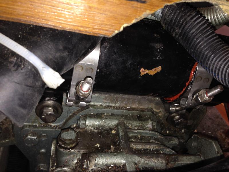

I stole this picture from someone else's post a couple of years ago....
I used these brackets when I replaced my HX. They are a Universal item and cost about $12 at the time. The only issue I had installing them was they are very stiff and due to space issues, I couldn't squeeze them together close enough to use the short bolts that mount the HX. So I used ty-wraps to hold them together, started the bolts in the hole then cut and removed the ty-wraps. Not an easy job. Sorry, I don't have a part #. :(
While I was replacing the HX I replaced all the associated hoses as well. At any chafing points, there are lots with the vibration of this engine, I cut short pieces of rubber hose and used these to cover the engine cooling hoses. No issues since.
I don't have experience with the brackets mentioned above, but these worked great.
Cheers
Cheers
Thanks for help. The hoses for chaffing is a great idea.
