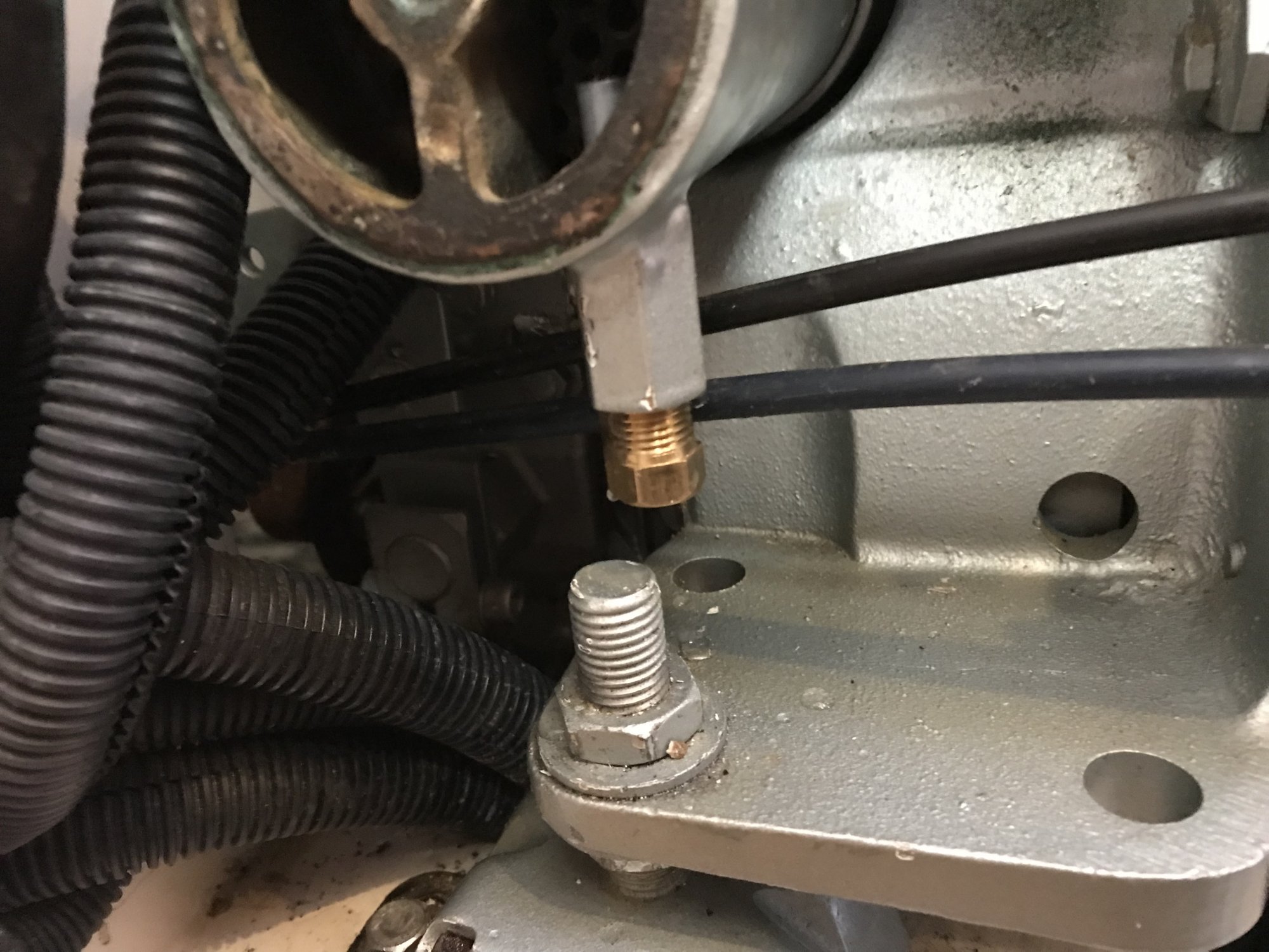

I have a 2004 Catalina 310 with the Universal M-25XPB engine. It appears I will have to loosen the heat exchanger brackets and rotate it a bit to change out the anode? It drops straight down onto the engine mounting bolt.

On my c36 the anode nut screws into the HX with much shorter collar. I can unscrew and remove with no interference. If this was mine, I would remove the HX and shorten the collar. It may be possible to cut the collar and re-tap, it is NTP threading.
23,544
I think you have two challenges here:
1. Hoses
2. Type of HX support - hose clamps or built-in bracket welded to the HX

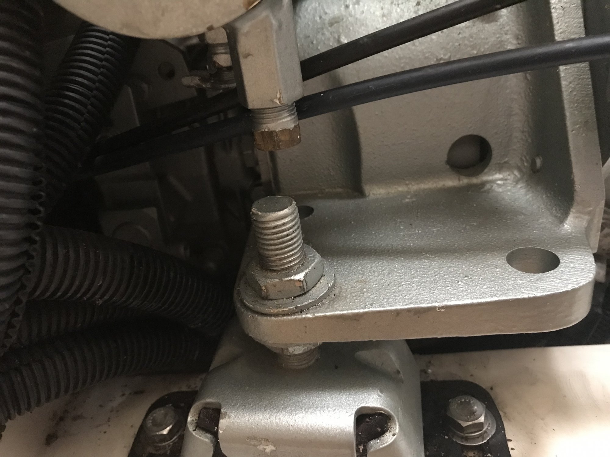

Hello - I also have a 2004 Catalina with same engine and set up etc. - I've changed the anodes numerous times and although it's not a problem getting out a worn down pencil anode down, I still find that with a little wiggling the new one goes up, whilst rubbing against that mounting bolt. I think once I slid the anode up separately, and then screwed on the bolt base afterwards. Good luck!

I hadn’t thought of that. I guess I can take the end cap off to fit the anode back in the base.

Yes, give that a try if it doesn't want to wiggle up in place as BC mentioned. You could loosen the mount brackets and rotate the HX as you described, also.

Had the same problem ........... just cut 1/4 " off of the bolt with my sawsall. Worked out just fine.

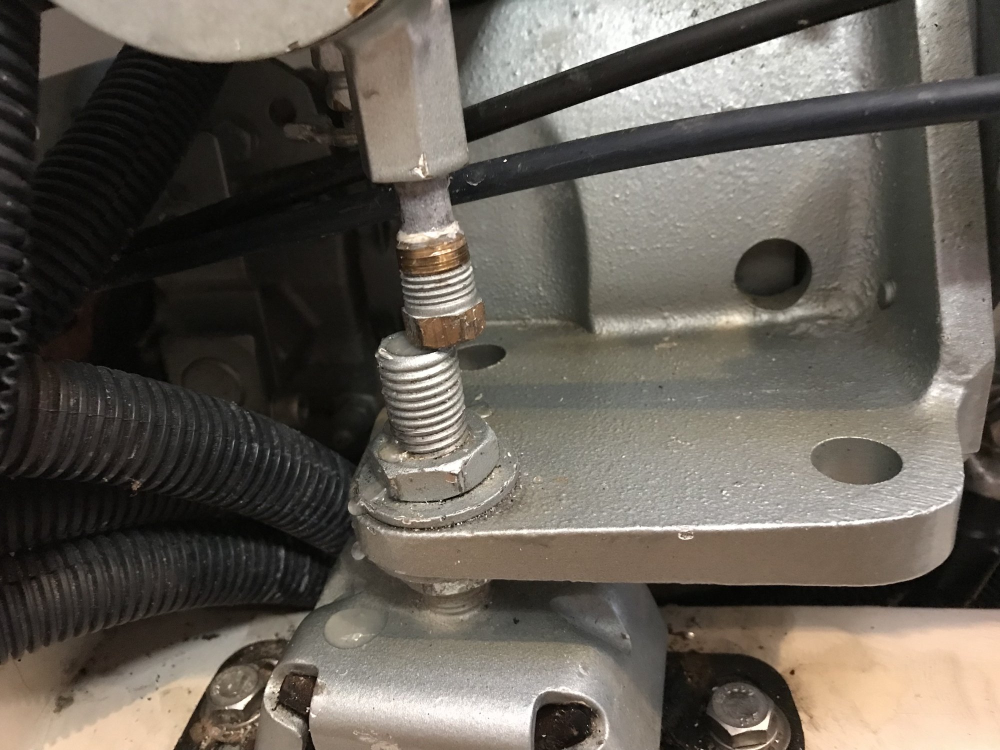

I was able to loosen the straps on the heat exchanger and turn It just enough the change the anode. The gaskets on the ends of the heat exchanger are about 1/4 inch thick. The replacements I got are more like 1/16 inch thick. The replacement gaskets were so thin I wasn't able to fully tighten the end cover cap screw and had to reuse the thicker one. I ordered the universal part number. I guess it could be some other heat exchanger.
