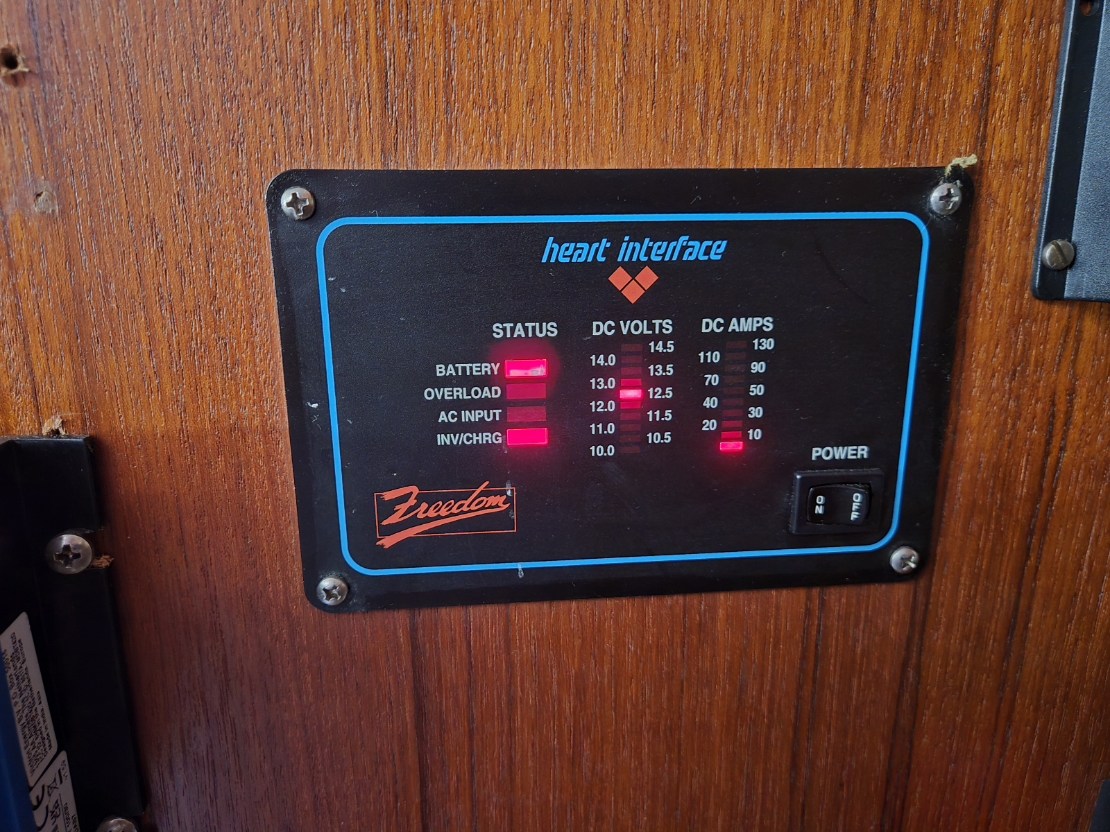

I have a Heart Freedom 20 with the remote panel. A few days ago while at the dock I noticed the top "battery" light was blinking. Consulted the manual and checked the voltage. Disconnected shore power, reconnected and all was good. Now we are anchored out and it is blinking again. Batteries are 12.84v. Turned the inverter off, let it sit and turned back, still blinks. Any thoughts? The dip switches shouldn't be in equalize mode since I haven't touched them.

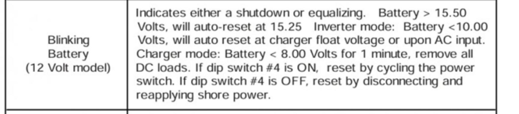

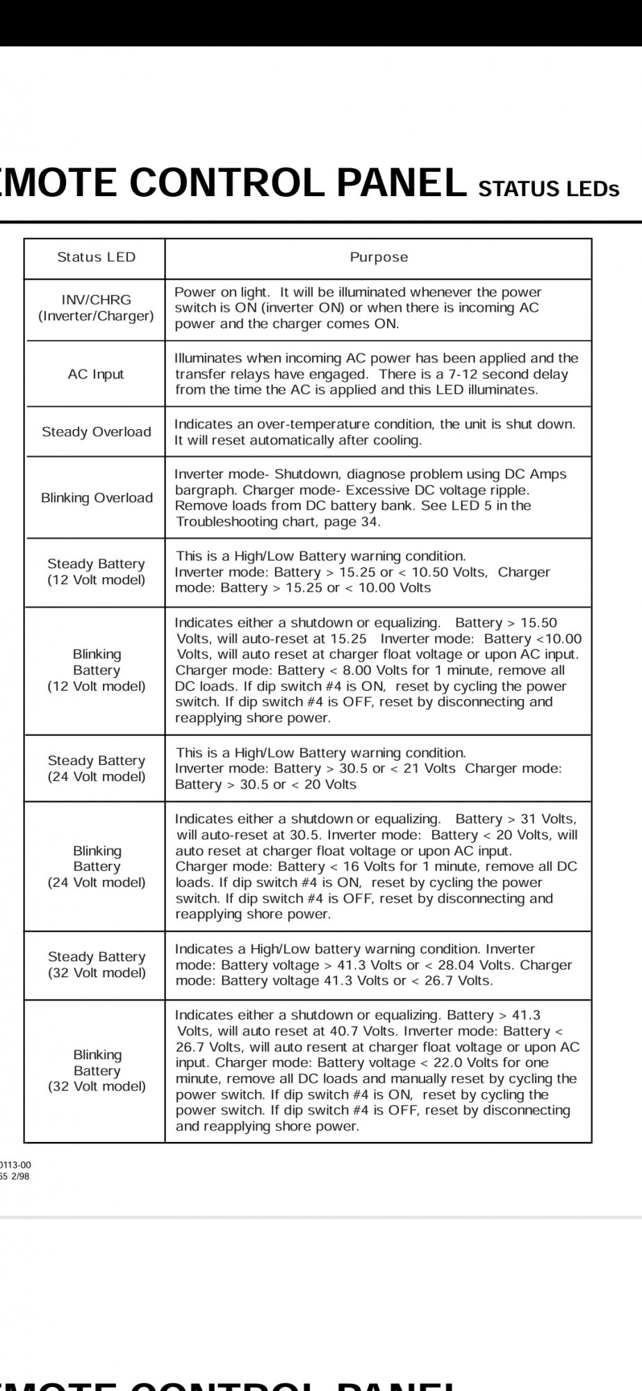

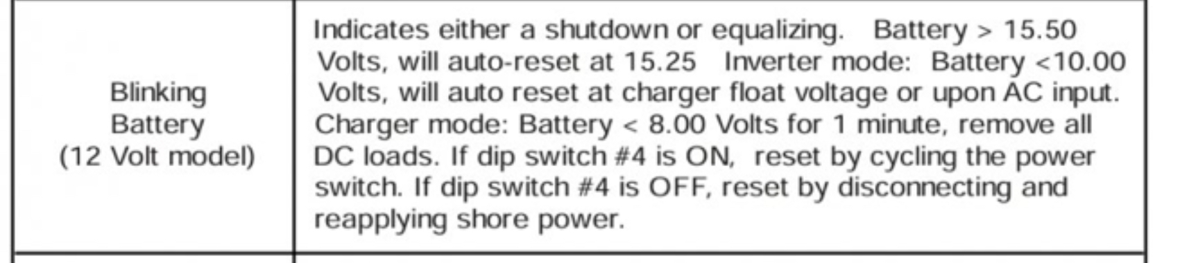

What did the manual say about the blinking light? What is that supposed to indicate?

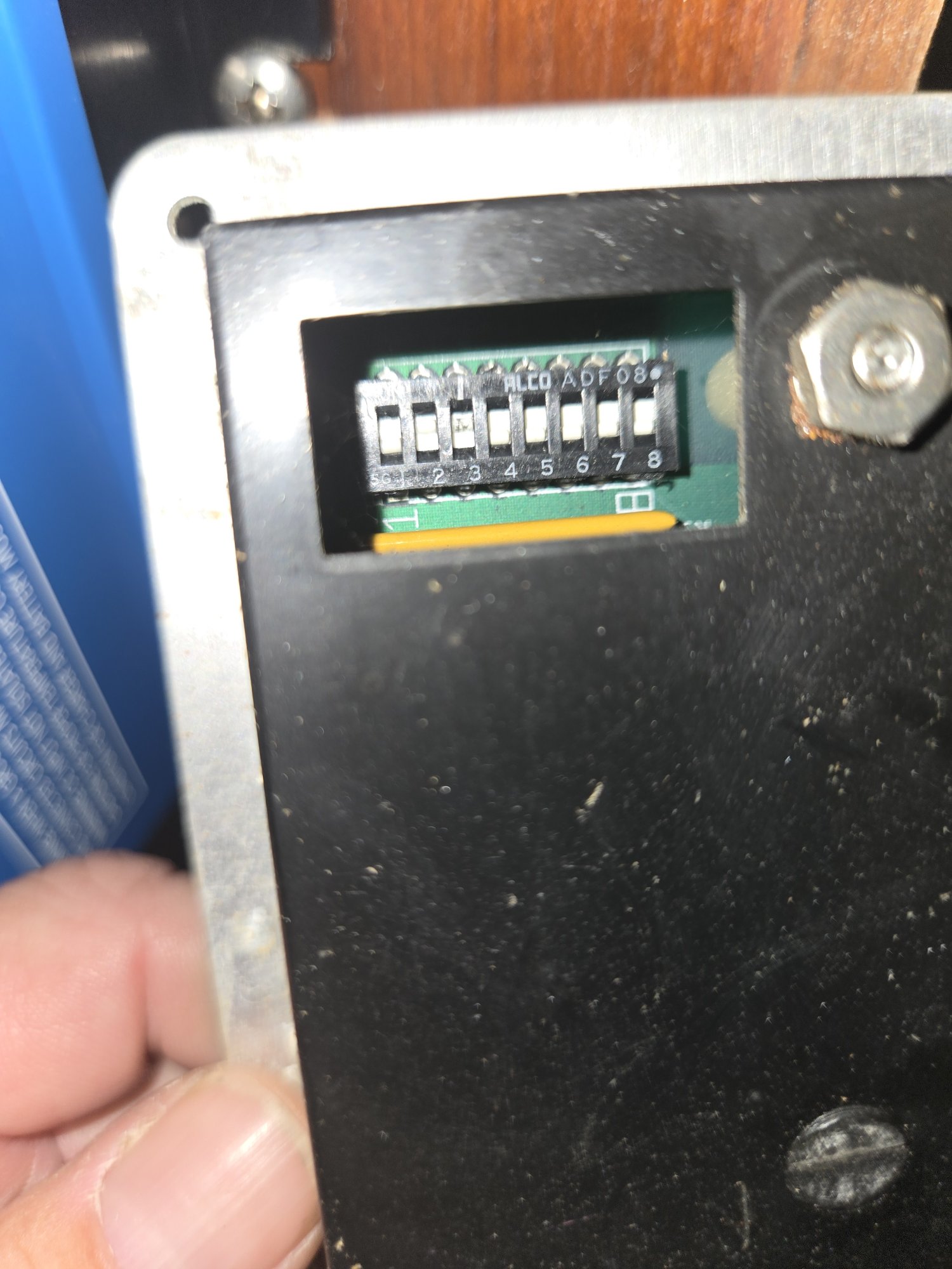

Is dip switch #4 on or off?

Since he hasn't returned to this discussion, it would be helpful to hear from him, also about dip switch #4 and his resets options - did he disconnected and reconnect his shorepower. You know: RTFM?!?:(

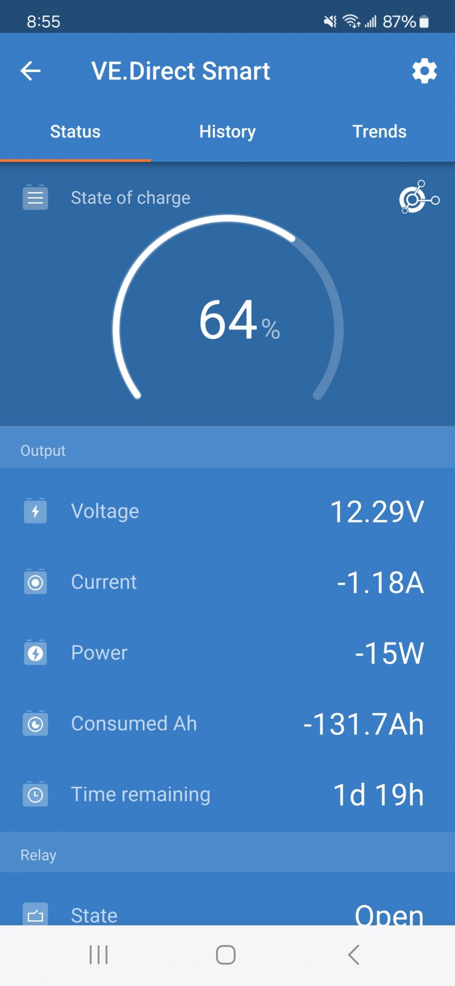

Thanks everyone. I appreciate the detailed information. I agree the charger/inverter is old technology and i like to upgrade it. I have seen up to 70-80 amps of charging current when on shore power or running the generator. I don't believe my batteries are the issue. I have a Victron battery monitor and I have never discharged them below 50% capacity and almost always fully charge them again or at least get them to 90-95%. They were at 100% yesterday afternoon and I have used 131ah last night and this morning. Currently at 64%. According to the manual the blinking battery light indicates equalization mode or a high/low voltage situation which i don't have. It is blinking right now.
My wife and I were offshore yesterday sailing so I apologize that my reply is a little late. And as I posted the copy of the manual above, you can safely assume I RTFM....
