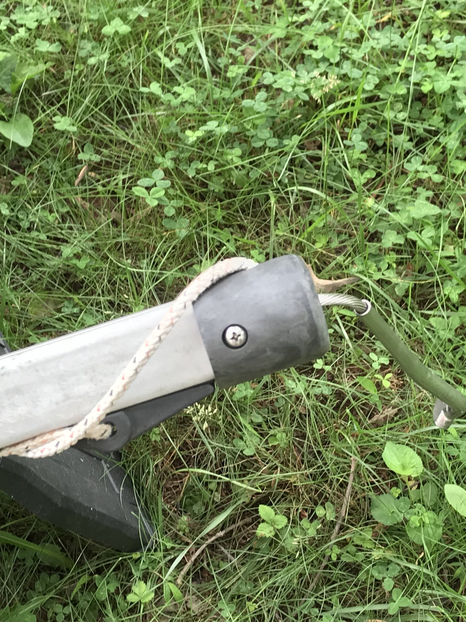

My forestay has a T-Ball fitting at the top like yours and my FF2 works just fine.
