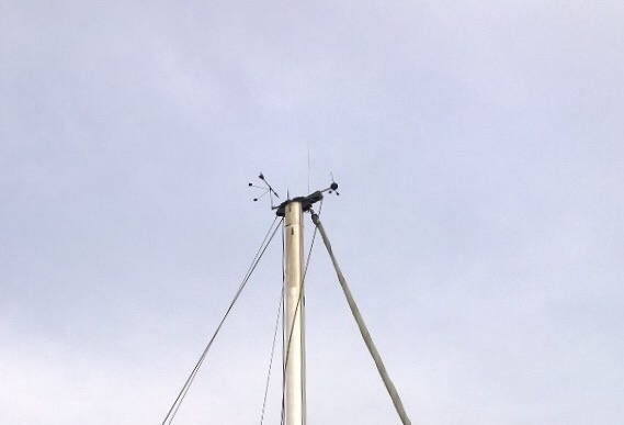

My O'Day 322 uses an internal halyard for the jib (in the furler foil) and also has an external halyard. The attached photo is not great, but it shows all of the halyards exiting the mast on the centerline of the boat.

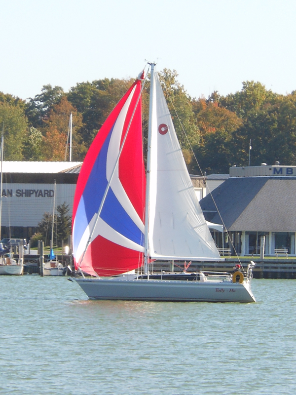

here is a shot with the spinnaker in place...zoom in to the top of the mast....
