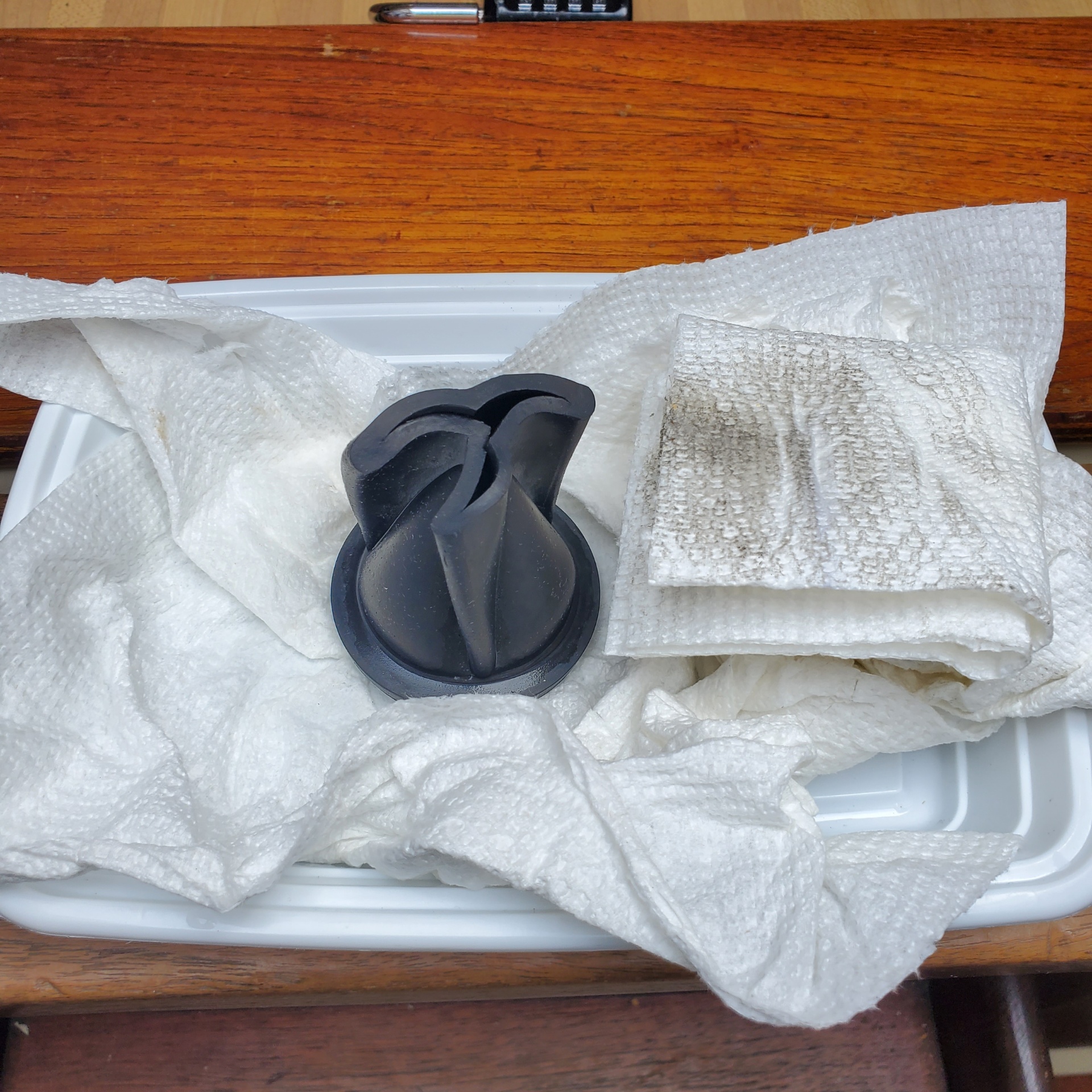

A friend had similar complaints about the Jabsco toilet not flushing, I told him replace the joker valve. Here's a photo of the one he removed.
