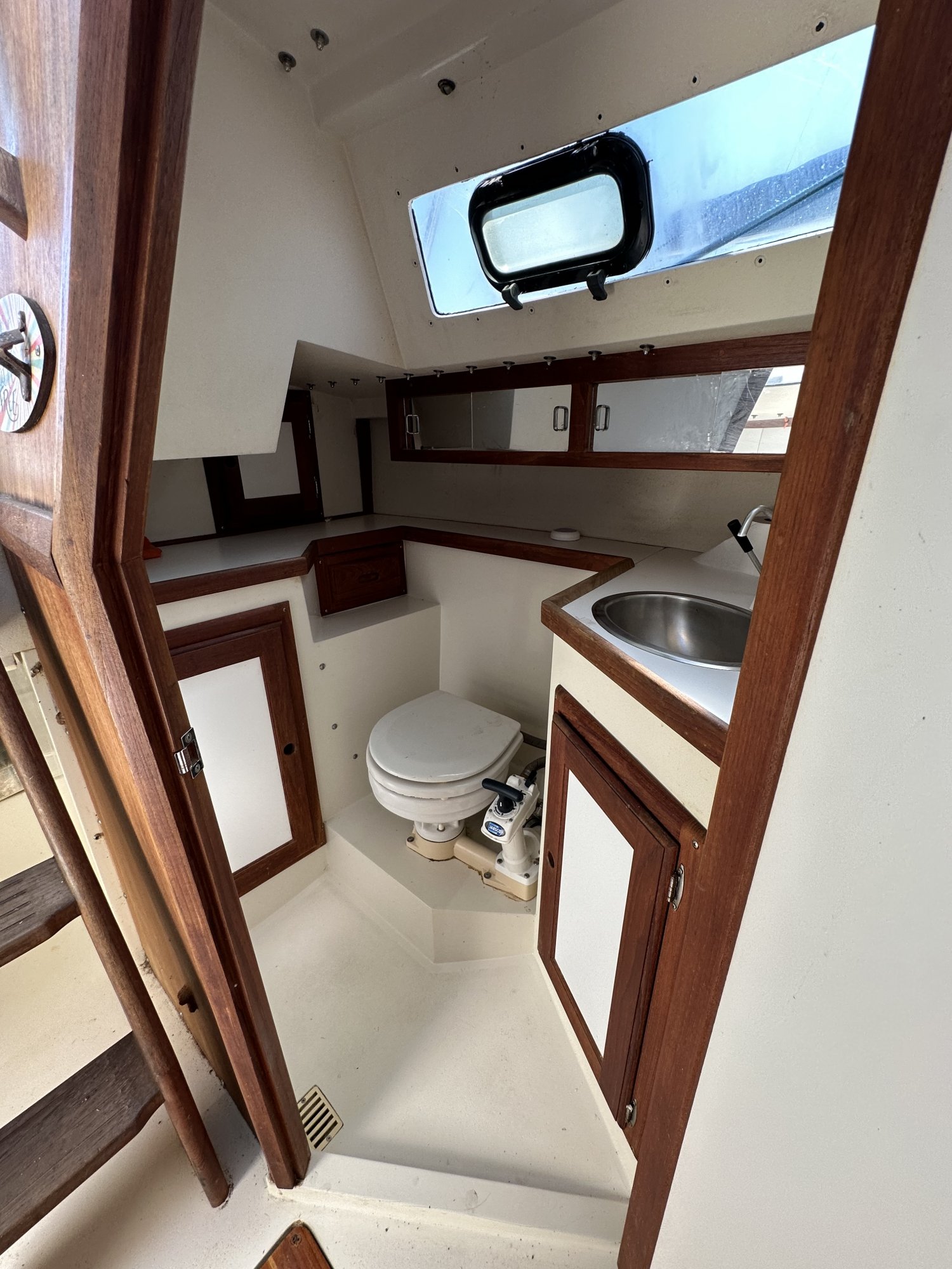

I'm sure this has been answered here, but I've searched and not coming up with answers yet.
I have a new-to-me Catalina Capri 26 with a Jabsco manual pump toilet. I tested the operation to see if it would bring in lake water and pump it to the holding tank. With a few strokes of the pump I was able to get some water coming in, but I'm unable to pump it out to the tank. The water just sits in bowl and when I use the pump, it just makes a squishing sound as it pumps against the contents.
What should I check first? Is there a valve that could be closed preventing the exit?

Thanks, Peggie. I wouldn't be surprised if it's the original toilet from 1993. To my knowledge it's a freshwater boat, but I just got it.
When in wet mode, I got water from the lake. But, it only filled the bowl and does not exit. Dry mode will not flush it out either.

Pump may need to be serviced (or replaced), joker valve is probably shot, discharge hose could be plugged (hope it is not that one :poop:), vent could be plugged…
Jabsco doesn’t make the most robust pump, and I don’t think it is the original, given the color difference between the base and the rest if the toilet bowl and pump. PO probably had issues with it and replaced it.
Raritan is the way to go for a manual flush toilet.

Thanks, everyone. I left lake water sitting in the bowl overnight and then went back out last night and tried again. This time I continued pumping longer than I did before, and eventually it did start flushing the water away. It's not exactly efficient, but at least it cleared the bowl after several pumps...so partially functioning. I'll continue to look into vent and valve issues.

Thank you! I probably had to pump 10 or more times to get the water out of the bowl. It sounds like that could be the culprit.

Replacing the joker valve helped a lot with the pumping efficiency. Super fun job, too. Haha. The old valve was bad as you predicted and no longer closed completely.
Is there a valve or seal in the pump body that I should replace as well, or lubricate with oil?
